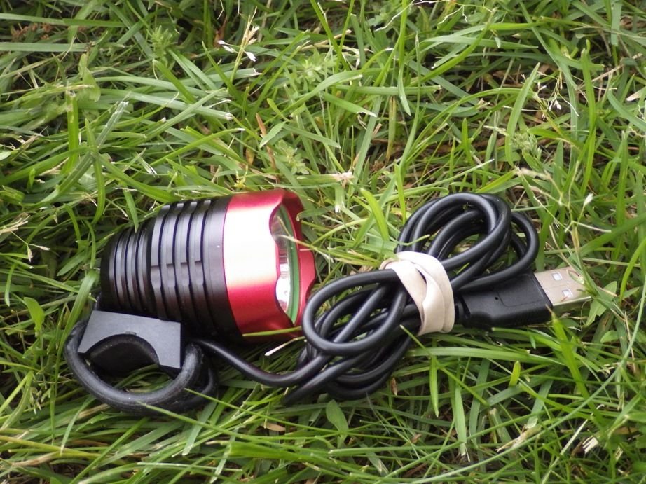

nite rider headlamps:
spray pc board (except sw) with krylon clearcoat
use silicone grease on o rings and sw cover
tape usb shut
advanced:
round oval sw hole with knife
solder in new heavy duty sw. 51 cents ea. digikey
tape usb shut
advanced:

there is a lot more to lights nowadays, integrated circuits for charging Lithium Ion batteries, logic chips for cycling through the different lumen settings, transistors for regulating current, LED's that require heatsinking in order to prevent self destruction,
i wish somebody would make a light with a battery, a switch, and a LED. one setting that lasts about 8 hours,
no electronics but the switch. charge the battery with a typical battery charger. this would eliminate electronic failures as well as the troublesome USB port. Certain diving light are built like this, but finding the right beam pattern can be problematic and they require a handlebar mount, but they are super waterproof and very dependable.
