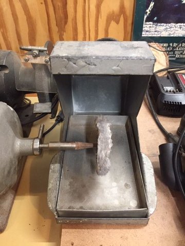

Coming from the dental field we had an expression in school, "if it shines, it flies"
I have a Baldor Polishing Lathe that runs at 1725 RPM in low and 3450 RPM in high.
My bench grinder runs at 3450RPM.
So if your using your bench grinder you are just running on high.
A few polishing tips:
Keep your rag wheels separated, don't use your green compound rag wheel for your red compound polishing.
Each compound gets their own separate wheel.
Tapered Chuck
Splash Hood
You can sometimes find a used splash hood/splash tray on ebay for cheap, it helps confine the mess.
Splash Hood
A Lathe tapered Spindle Chuck makes changing rag wheels quick and easy.
LATHE TAPERED SPINDLE CHUCK
Tapered Chuck
Splash Hood
Splash Hood

See the mess. the little vacuum and plastic thingie are pretty much useless. I plan on building a 2X4 "booth" around it with a large fan and filter.

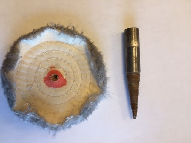

The Baldor polishing lathe you have pictured, has, tapered shafts to allow for quicker spindle changes. The grinder motors will usually have threaded, straight shafts ( left hand threads on the left side) and are no where near the quality of a Baldor or Redwing Dental lathe.
Tapered screw spindles, for use with grinder motors, are available through jewelry suppliers. They should be ordered to match the spindle shaft diameter ( usually 1/2" , 5/8", or very occasionally 3/4"). They are specific to which side of the motor they will be turning on, i.e. Right or left hand threading on the tapering screw thread to keep the buff in place. They are usually secured to the grinder shaft with set screws or grub screws. The buffs for these tapered screws are often reinforced with shellac, leather, plastic, or lead. The standard buff you might get from Harbor Freight or Sears is usually designed to go over the 1/2" diameter shaft- the hole is a tad too large, and will try to run up on the widest part the taper screw. That may move the buff too close to the motor housing to allow for adequate maneuvering of the part being polished.
The grinder's speed should be 3450 or 3600 rpm. If the grinder is only the 1725 rpm, super high polish finish is difficult to obtain.
In Jewelry Polishing, there are usually two Steps or compound changes; "cutting/buffing" and "coloring/polishing". Cutting compounds are Tripoli, Bobbing, Emery, etc.. They remove sanding marks or rubber compound wheels finishes. Polishing compounds put the final high gloss finish on. Polishing compounds are red rouge ( for gold colored metals) and white or green rouges for white or silver colored metals. As described , the buffs should be used only with one compound. Obtaining a high luster is difficult if one skips the initial cutting/buffing stage. There are specific cutting compounds designed for stainless steels and non ferrous metals and precious metals, as well as aluminum.
In my set up, I actually use a grinder motor that has been stripped of grinder wheel guards. I tend to use bobbing compound to cut with ( less heat build up than Tripoli or emery) and Green rouges (usually crocus based compounds) for aluminum or steel high polish.

WRT the tapered screw spindle, I wasn't able to easily find one which would mate up with the existing 1/2" spindle. For the time being I will just suffer with slow changes. In any case, I think the buffing wheels would sit outboard of the existing small shroud on my grinder.

https://www.amazon.com/Spindle-Adapt...45&s=hi&sr=1-2
I highly recommend Loc-title or similar to secure the set screws. Vibration from polishing being more than you expect. WRT those cloth buffs, there is a process of dressing them down to run smoothly. One should scratch them up with a file tang
(evenly across the buff) while spinning at speed and then some careful scissor trimming (like a beard) to remove hanging strands that leave lines in the high polish finish. A piece of coarse sandpaper (60 grit) held against a rigid board or plate will smooth the last bit out. Depending on the manufacturer, the buffs may run more smoothly if mounted in a particular orientation. Once they are dressed and running smoothly, Mark the direction of rotation with a Sharpie- you will thank me later....
