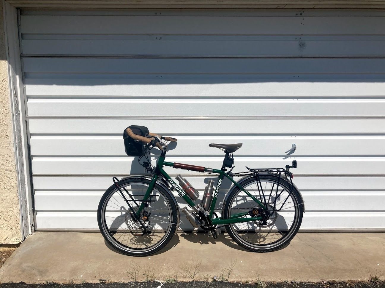

My Rohloff bike is a Thorn Nomad Mk II. SJS in the UK is the only retail outlet for Thorns. I ordered the frame and fork from them, also ordered the rims and some other parts from them. They sell complete bikes, but I used to work in a bike shop, I build my own wheels, etc. So, I chose to build up the bike myself. And I bought my Rohloff hub from Bike24 in Germany. It is a good thing that Rohloff manuals are on the internet, as when you order a Rohloff from a retailer in Germany, you get the German documentation, which I can't read.
I ordered my Co-Motion Pangea Rohloff late November 2013. I received it in March 2014. I ordered all the frame options and the light package. I also ordered the sloped down tube and the fork stays for the Schmidt Son SL alternator hub. The shop used spokes and rims that didn't allow for a good spoke line between the rim and Rohloff hub. I used Sapim spokes and Velocity Psycho rims. The Psycho's are a box style rim and around as heavy as the Ryde Andra rims. I had the wheels out a few weeks ago and the true has not changed. I don't ride on the dirt much but the desert roads are full of cracks.

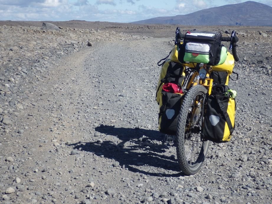

I considered the Pangea frame and fork, but I bought the Nomad frame and fork, mostly due to lower price. I had previously bought a used Thorn Sherpa frame and was very happy with that bike so I had high confidence in Thorn. Later I tried using my Nomad on a mountain bike trip, bought a low end Rockshox suspension fork for it, as that frame was designed to work with a 100mm suspension fork or the solid fork that came with it. Thus, although I did not plan on the suspension fork when I bought the frame, it became a plus that I could use that fork for a trip later. That would not have happened if I bought the Pangea.
And I have had my Nomad on some pretty bad roads. When you see something in the road that is smaller than a tennis ball, you do not bother steering around it, that says something about the road.
And with the suspension fork, below. This trip was day tripping from campsites that we were car camping at.

I have seen the flange support rings and considered them. I believe part of the reason for the flange support rings is the large diameter flanges on the Rohloff hubs make it harder to build a strong wheel. The angle of the spokes from the hub to the rim is more acute. I examined everything on my new bicycle and noticed right away the wheel build was like amateur night. The bent part of the spokes did not make contact with the flange which made a large gap instead of the spoke digging into the flange. The spokes didn't make a straight line on there way to the rim either. My solution was the Psycho rims and the Sapim spokes. The wide box style rim and Sapim's ball joint style spoke heads allowed the spokes to be straight and their bend allowed the spoke to sit against the hub flange. I was able to properly stress the wheel and achieve really even spoke tension. Rohloff makes a very high quality well engineered product. They do what they can to keep their good name and through no fault of their own people without the proper skill set sometimes muck things up.

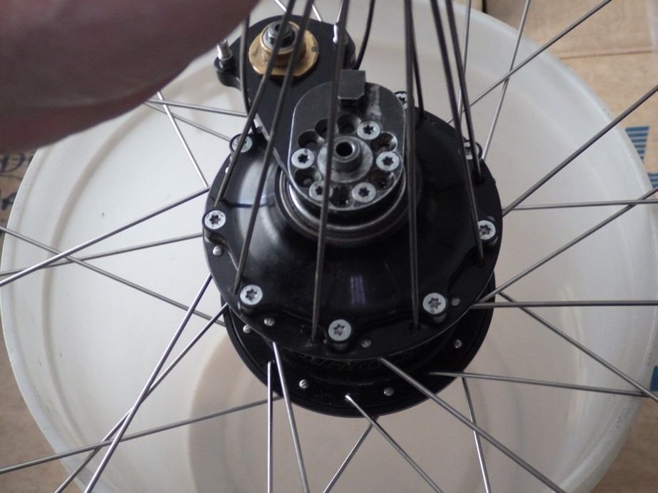

If you consider adding the support rings, I did one side at a time, loosened and removed half the nipples so that I could drop the rings onto the hub but I did not even remove the spokes from the hub. And after seating the ring on the hub, retentioned the spokes on that side before I did the second side.
Did not take long at all. I set the hub on an empty bucket to provide a stable horizontal support for the wheel.
First photo, I am holding the spokes up so that I can drop the ring onto the hub.
Second photo, the ring is on the hub but I have not yet laced the spokes. Thus, the spokes are not at correct angles or cross pattern yet.
I had a few drops of oil drip out of the hub when the hub was horizontal, so if you do this, be prepared for a few drops of oil to drop onto whatever is under the hub.
Rohloff does not recommend adding the rings to all hubs, they only specifically recommend adding them when you rebuild the wheel. But some of my trips have had me quite far from help with a heavily loaded bike, so I chose to add the rings when I learned they existed. If I did not use this bike for heavy touring in remote areas, I probably would not have added the rings.
