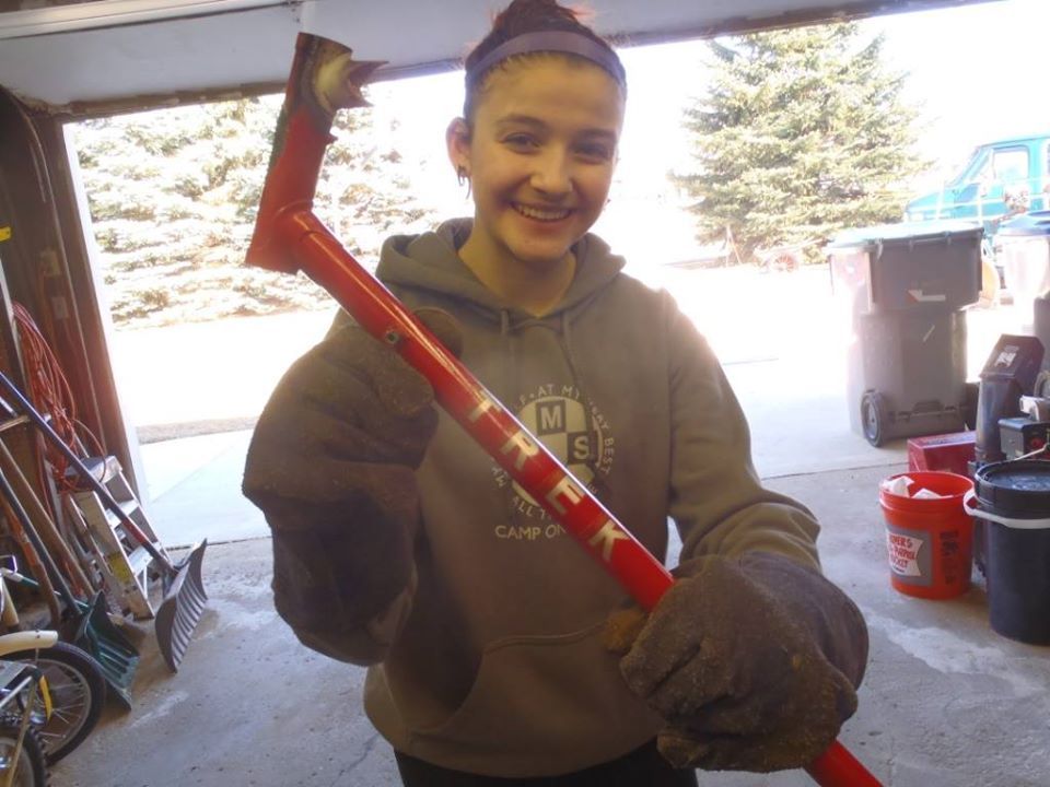

I ordered some flux, silver, and 5 cable guides. I took a framebuilding class a couple years ago and attached brazeons, but I ordered a couple extra to practice with since only propane would be used. Propane alone isn’t as effective(not as elegant, clean, or fast) as propane and oxygen mixed. So I wanted to get an idea of how long it would take before handing the torch to my 13yo for her to practice on the frame.
Good stuff!
It took some patience while convincing her that we wouldn’t blow up, she wouldn’t burn herself, and there is no ruining a frame that is already in a state of ruin.
We made a brazeon holder with some wire and washers at each end to hold the cable guides in place, then did a quick sanding to remove any grease and expose fresh metal. Dropped some flux all over, set the cable guide and got started.
Between the colder garage temps and using just propane, it took longer to get to temp than using a proper setup, but the silver flowed and she laid down plenty of it(so much!).
I finished the last cable guide then removed the flux and filed away any excess silver since she saw the process involved in filing and sanding and immediately declined my invitation to join in.
Good stuff!

I've been a firm believer in teaching my children self sufficiency and life skills.

@dedhed, your pictures warm my heart.
