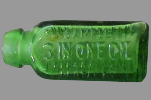

It cleans, lubricates and protects? Wow, it's like a three-in-one product! Why hasn't anyone thought of that before?
Oh. Right.
One of the oldest cycling products you can buy, 3inOne oil debuted in 1894, promising to 'clean, lubricate and rustproof' bicycle chains.
Oh. Right.
