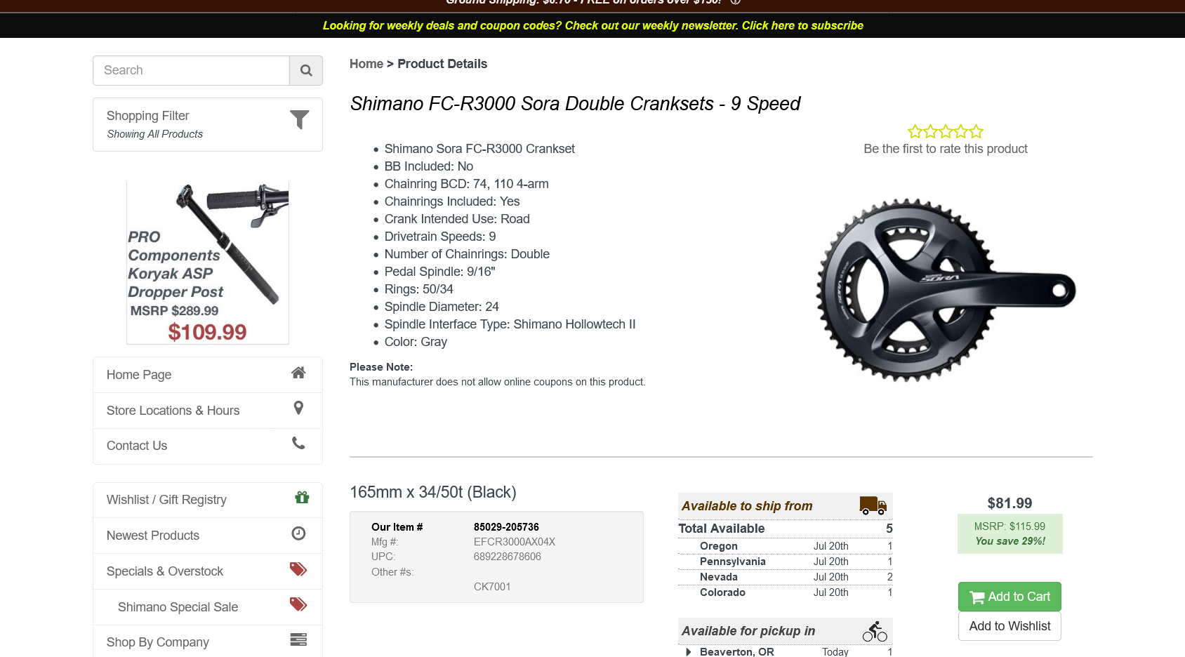

I'd go with a Sora 9 speed 50-34 over current 11 speed 105. It's more likely to be compatible with your 7 speed but still uses the nice HT2 bottom bracket. You get modern components and lose a useless 53t crank. You can do the cassette later if you need to.
