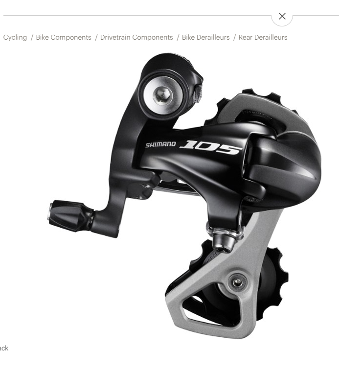

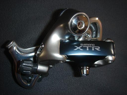

2) See, when I look at those two derailleur pics, all I can think of is man does that short cage look sexy next to that ungainly long cage! To each his own I guess.
3) I still don't see the problem with big-big. In my mind, I will set the chain up for big-big just as I would on a true double and, as such, using an RD meant for a double should be fine. I'll do whatever needs doing with respect to the B-screw etc. What am I missing?
If you want sexy for your 7 speed 1992 Miyata...
Unfortunately you won't get any more wrap. But you won't be riding some generic 105 either.
John

That may very well be the single best-looking component that Shimano has ever made.
--Shannon

Originally Posted by 70sSanO
If you want sexy for your 7 speed 1992 Miyata... Unfortunately you won't get any more wrap. But you won't be riding some generic 105 either.
Is that an M900? The best I could find on eBay was a long cage version at $425 USD.
Generic 105?? Man, you bike-o-philes have high standards. So far, I've been riding Acera's, Deore's, and Suntours from 20yrs/30yrs ago. A new105 is nothing short of aspirational for me! I guess I have an Ultegra on a 2000 Airborne but I haven't been on that since 2006...

Just funning you.
Old parts cost are ridiculous now. 10 years ago it was $50. Nothing wrong with 105’s. Good stuff. And it looks good.
While I imagine the newer stuff is better, that XTR is at the top of my list of best Shimano RD’s.
