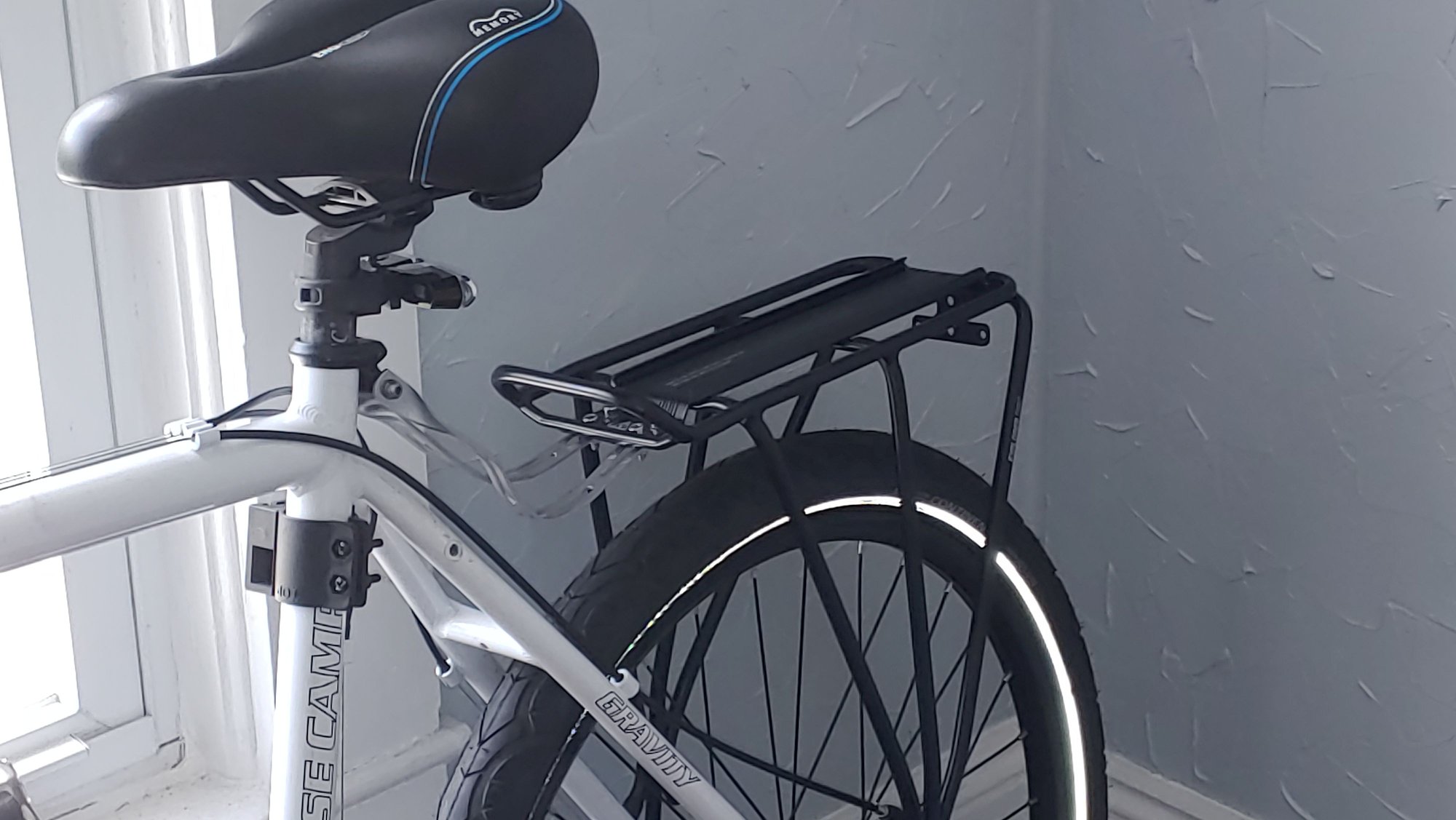

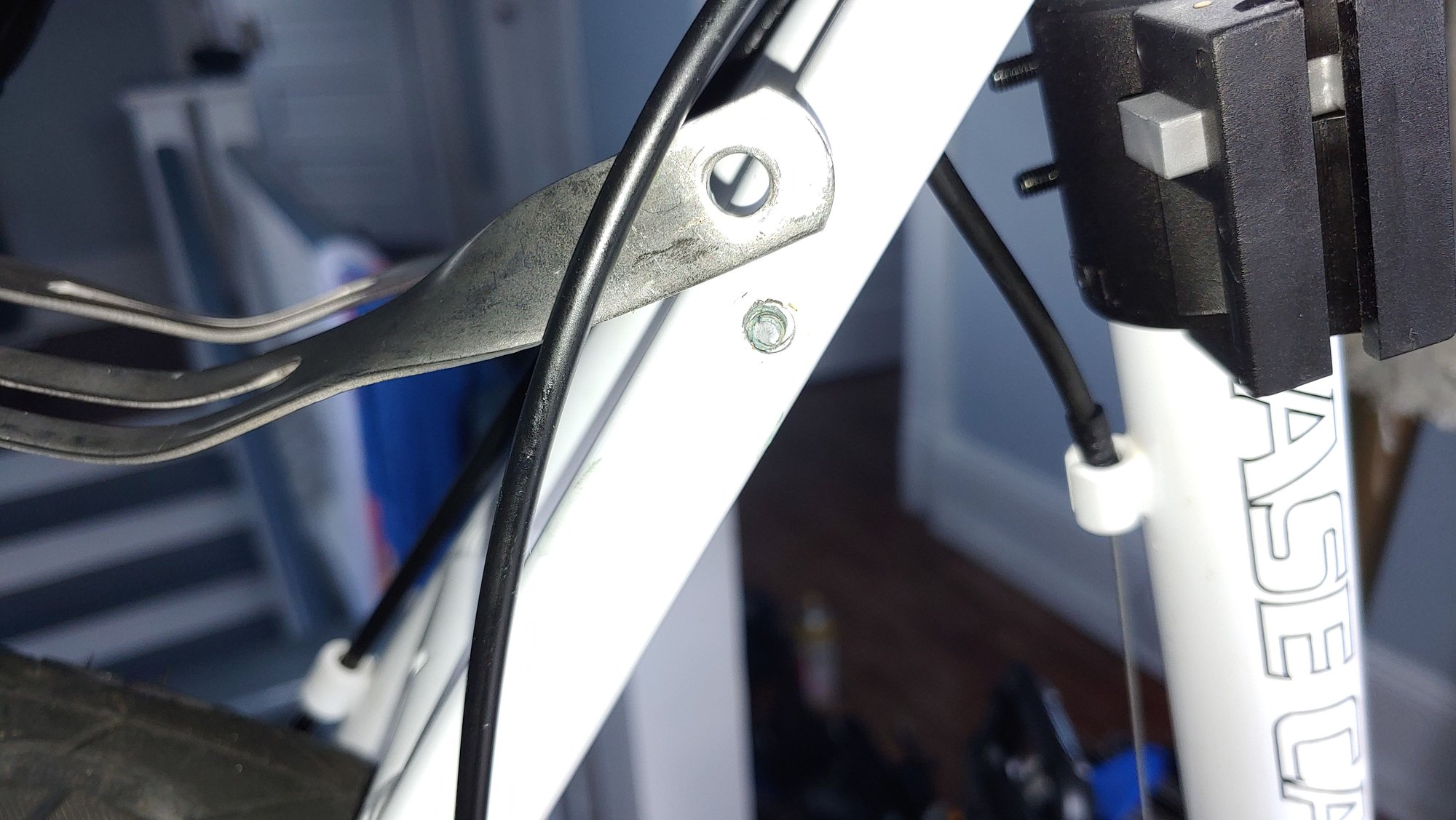

I was installing a rear on my bike, had every bolted down, and only one bolt to screw in. It decided to snap on me. Hopefully I'll be able to drill a small well into it and remove it with an easy out. I'll have to drill it out and re-tap the thread, (hopefully I'll find a tap small enough for a fine thread,) if not. A bit frustrating, but I know I have solutions available. Can't say I am happy about it, but such is life.

I'd try to cut a slot into it and back it out before drilling it out. Trying to drill out anything smaller than a 3/8" - 6mm is always sketchy. Either way, chase out those threads before you try a new bolt. It doesn't take much to foul up those little M5 inserts, plus those shiny stainless bolts are so easy to snap or round off. ( Don't even get me started on titanium, lol)

Left hand drill bit might do it

Already have the set. I needed to order a drill adapter for my impact driver. I found a workaround, and I'll attempt to fish the broken bolt out. The rails got a bit ganked up but it's functional.

It looks like the frame uses rivnuts, definitely doesn't look like a welled on fitting. Might be able to just get a new one squeezed in once the hole is cleared.
