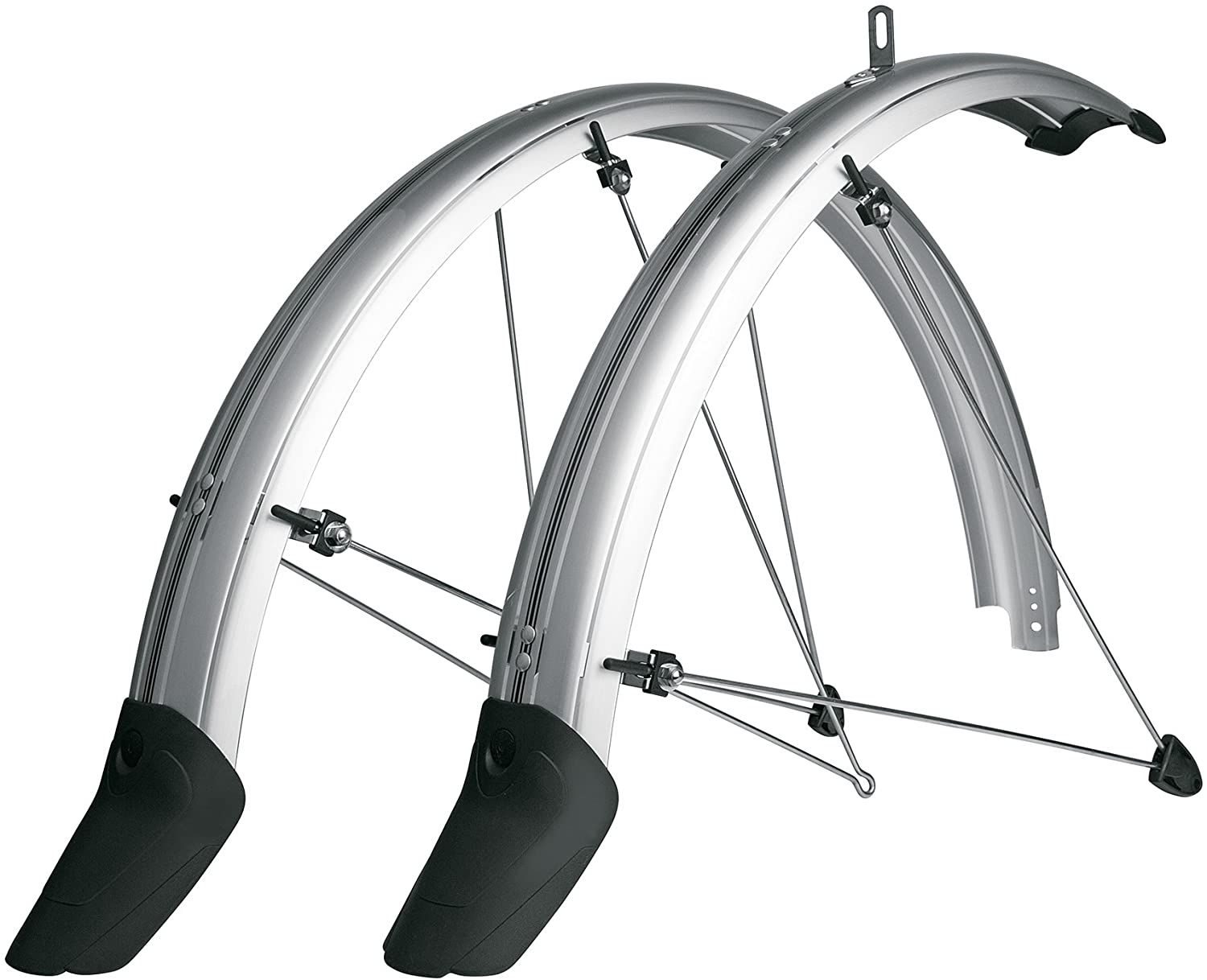

I just bought a pair of SKS P65 Chromoplastic Longboard Bicycle Fenders and am looking to cut the metal stays that connect to the fenders to make them fit.
What kind of wire cutter do I need? I would really appreciate an Amazon link to the one I need. They have many with a huge range of prices and I just want to get the cheapest one that will get the job done. Thanks.
