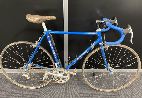

Hi,
So looking at buying a bike the only problem being seller is not being responsive about frame size or state of the seatpost/stem sticking. For the price it is currently still worth me taking the risk to bid imho so I would like to leverage the experience of you guys to guesstimate the size of this frame. All I have to go on unfortunately are photos. Those with experience guesstimating size from photos, what do you guys think the size of this frame is? I am looking for a 54 and up, how bad do you think 52 or 53 would be? Before you ask, yes I know its not good to buy something that isnt your size. What about the stem/seatpost, does this level of corrosion likely indicate frozen stem/seatpost?

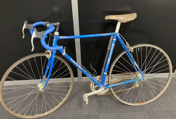

Guy marked it as being 50. However from his post history he marks everything even those clearly much larger at 50. I was thinking around the 54 range would be possible too.

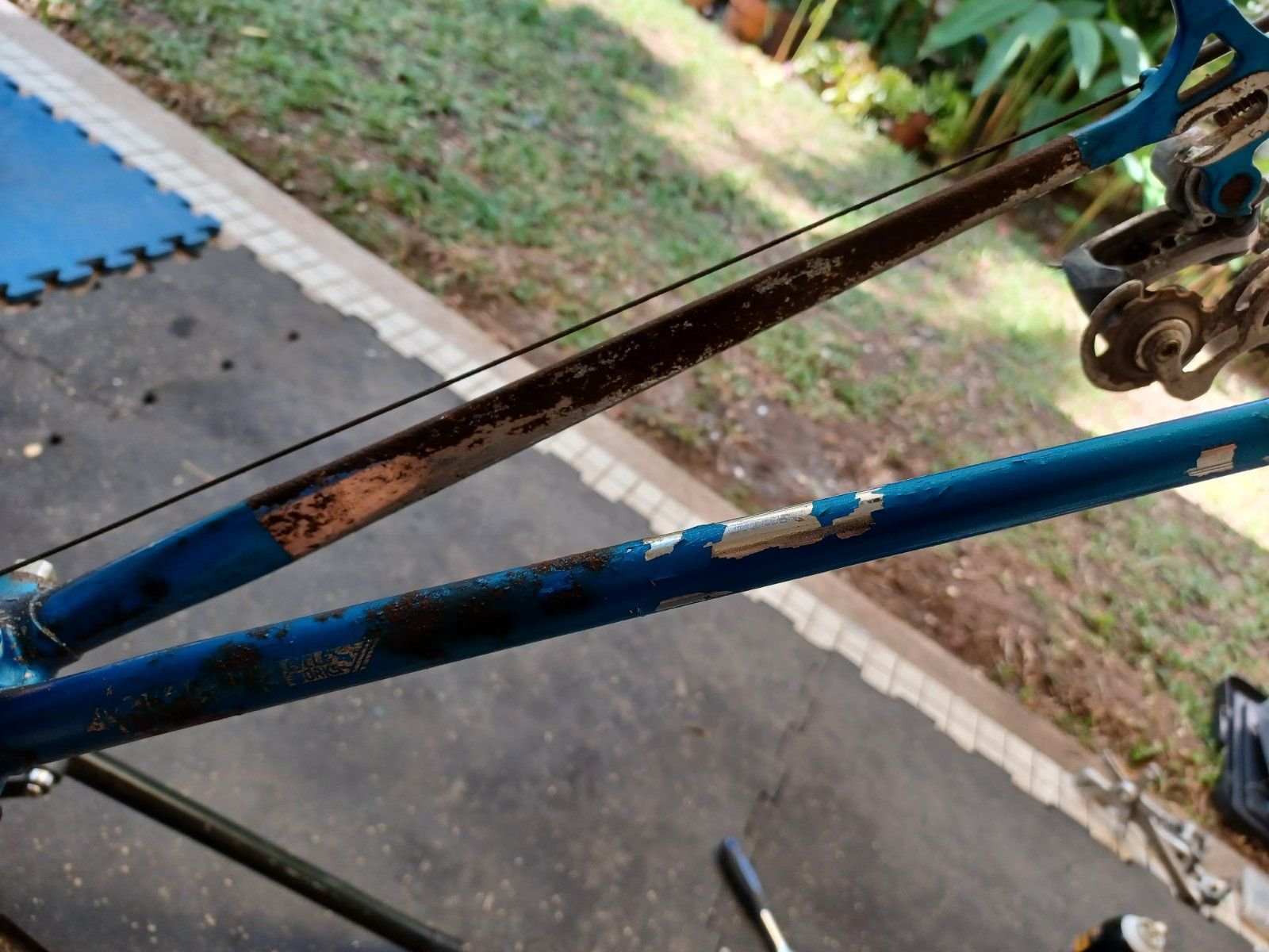

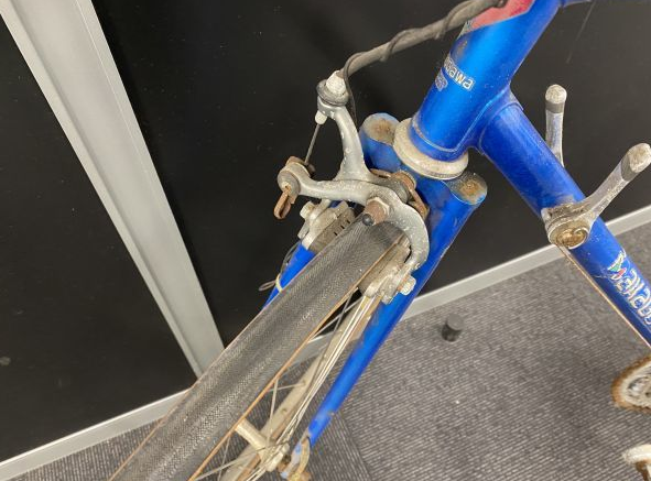

Yeah, 53-54cm.

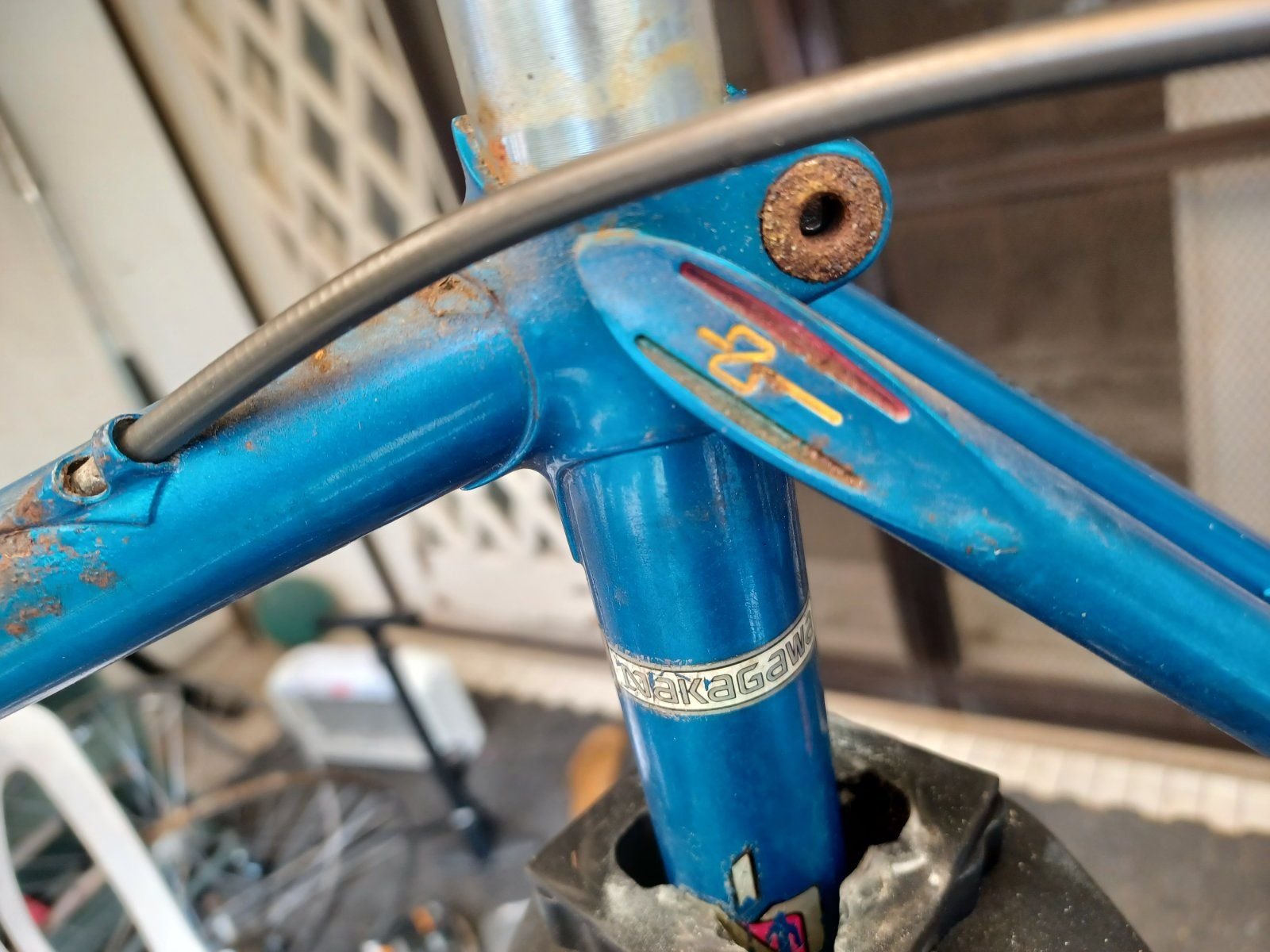

I'd be concerned about frame damage based on the amount of oxidation visible in the aluminum parts. Check for rust if possible.
The selling price of that bike would need to be really cheap to make it worthwhile to clean up everything and make it worth replacing components that might be too far gone.
Yeah, 53-54cm.

LeSexyFishorse , yep, for the right frame it might be worthwhile.
I've generally avoided bikes that needed a lot of cleanup. I would expect the corrosion to cause some sticking -- seat post, stem, bottom bracket.
There are lots of tips for techniques to unstick and clean up bikes like that, both on bike forums and YouTube. Check the channel for RJ The Bike Guy, the prince of low budget DIY but competent overhauls. He talks fast, moves fast... he's the Pulp Fiction "Winston Wolf" of bicycle repair tutorials. Occasionally I flinch watching him and wonder how many thumbnails and toenails he's lost to bike repairs (yeah, sometimes he's barefoot in his videos). But they're really helpful despite the occasional eyebrow-raisers, like using adjustable wrenches for stuff that demands a lot of cranking. But ya gotta do what ya gotta do.

55cm.

Since all of my bikes are between 52 and 56, and I look at them every day, with 54 being just about perfect, I'd say that's a 55 (center to top of top tube), or, if you prefer, 54 center to center. But if it has a low or high bottom bracket, that could change it a little bit. I'm going by the distance between the top tube & the down tube at the back of the head tube.

In a classic road bike, and depending on frame geometry "squareness," 55cm C-T is my exact size (the Bianchi, the Carlton, and all 3 Capos), and the one pictured looks pretty good to me.

Depends on whether we are talking C-T or C-C -- makes almost a 1.5cm difference on a standard road frame.
This is a great idea for visual estimates when I cant get any accurate ones. I will do this in the future.

Could be, as the fork does look kinda tall. Would probably push the size up a cm. I'd still guess 54cm...

55 center to top would be my guess. Top tube probably 55 center to center.

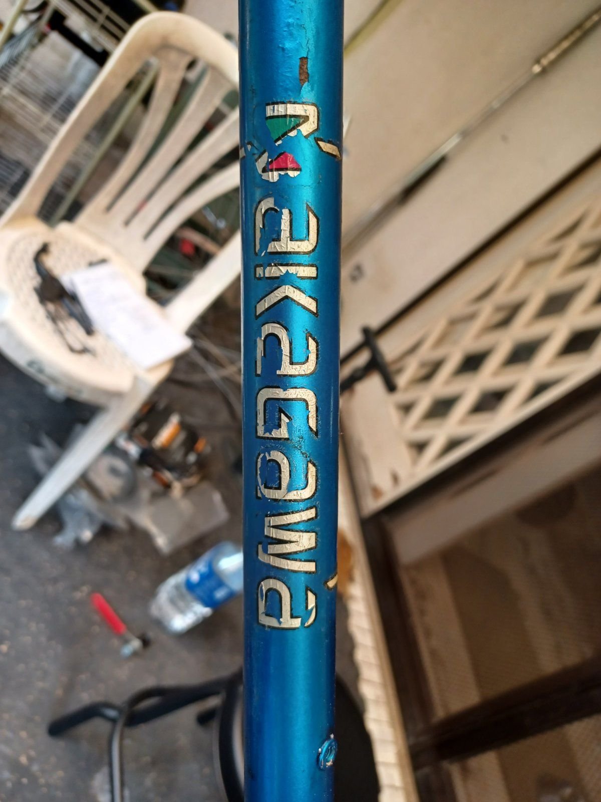

Nakagawa makes fabulous bikes. You have a real jewel in the rough there!
I would love to see photos of the various frame details when you get a chance.

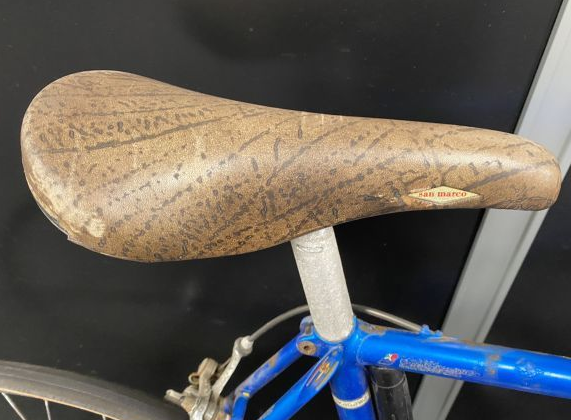

1. Unless you know otherwise, a weathered bike like that will likely have stuck steam and seat posts. As far as secret methods to get them out, everything works sometimes. I had to cut the stem out of my last one. I was able to eventually get seatpost out without cutting it out.
2. how are they going to pack this bike without removing seat post and stem?

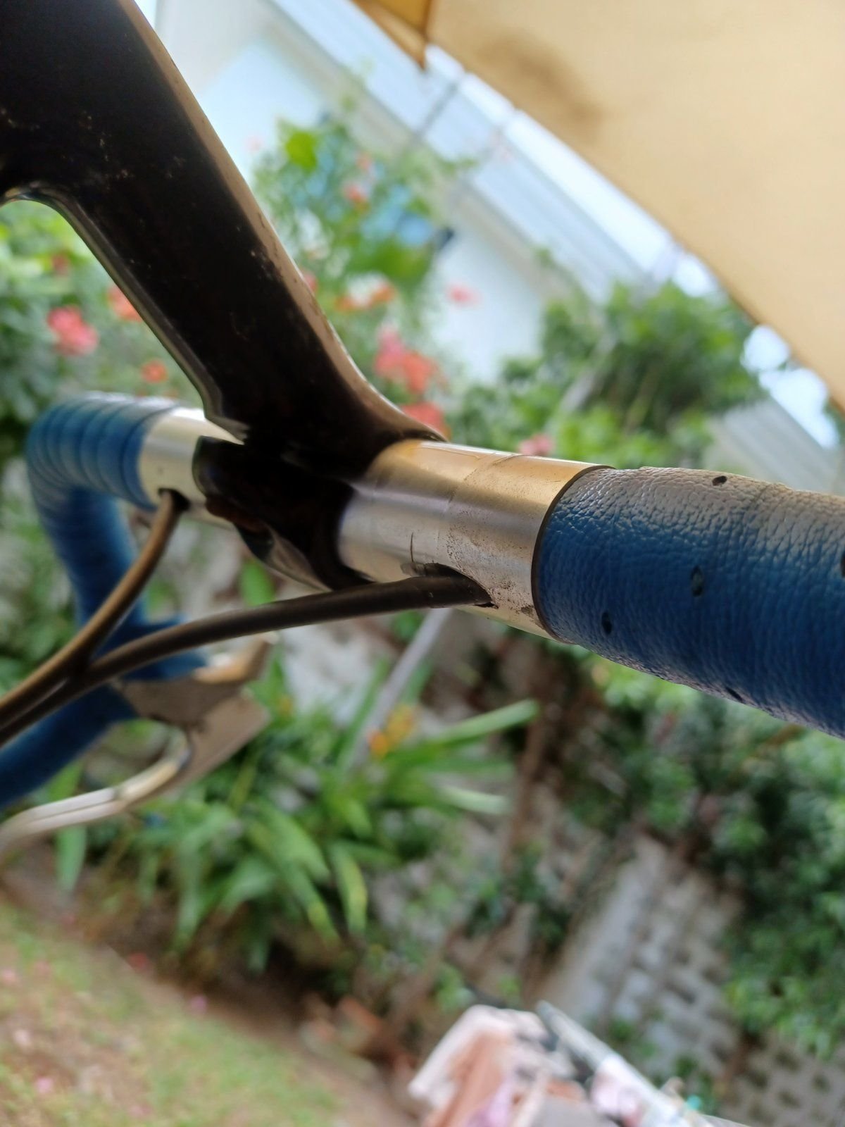

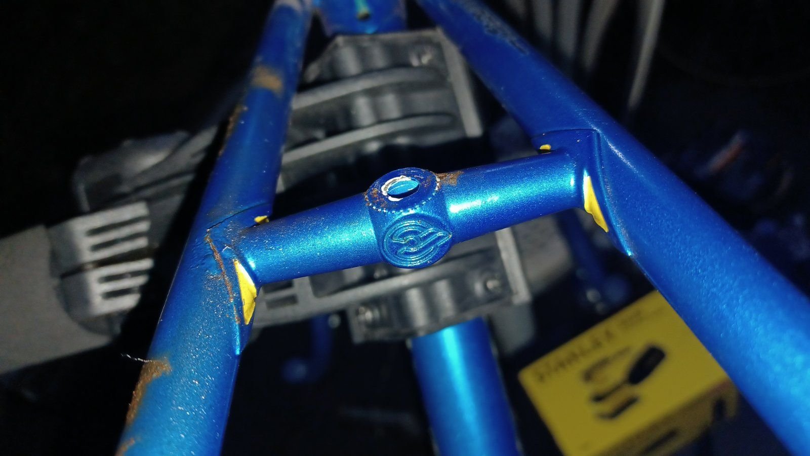

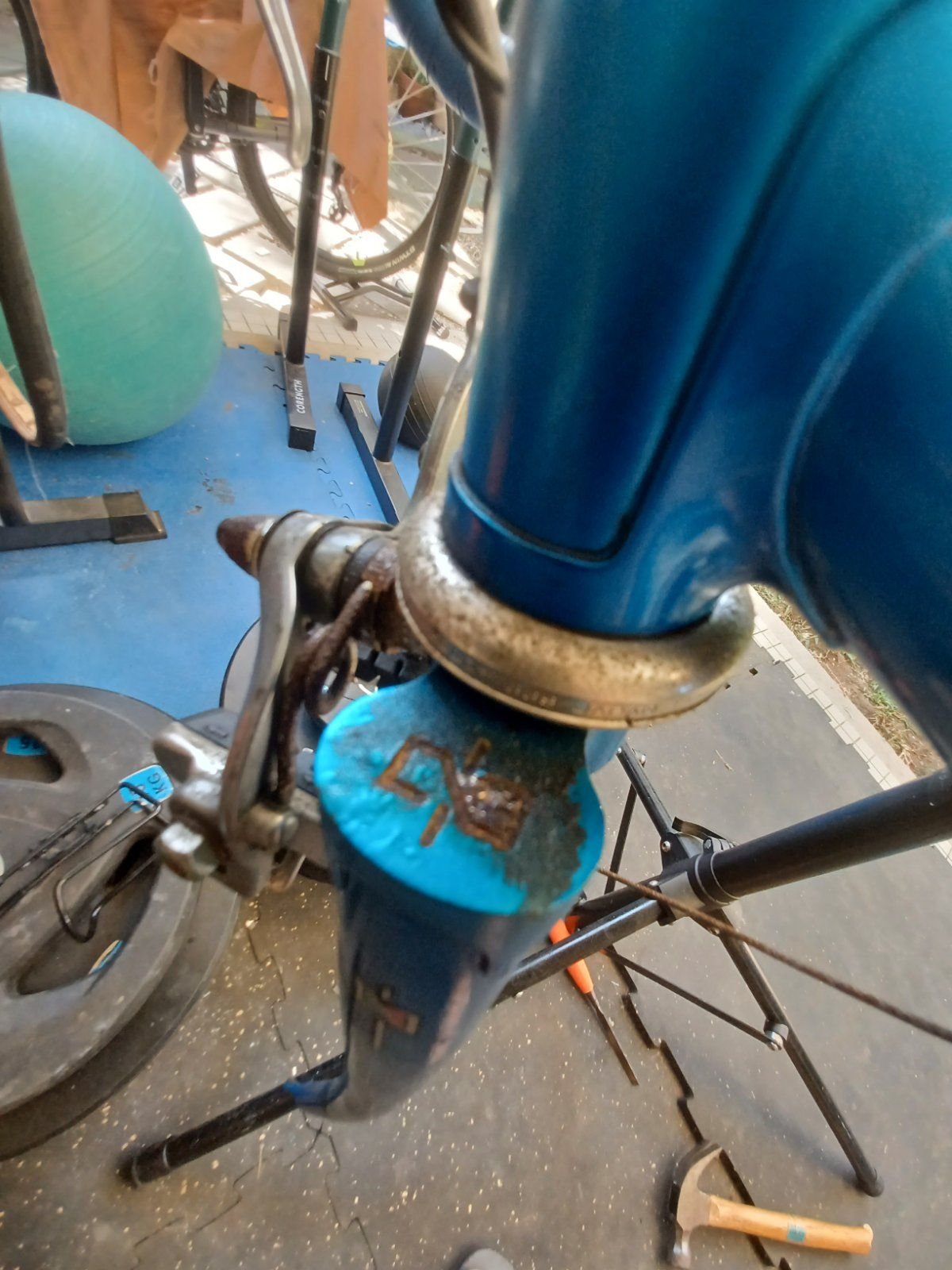

Here are some pictures. Be warned the images you are about to see may be offensive to some.
The frame seems to be chromed, and the blue seems to be some sort of beautiful electric blue that the initial photos didnt do justice. I was thinking of emailing Nakagawa for the pantone so I could have it matched here. The chainstay "rust" that I thought might have been a cover is actually rust on the bare chrome. He didnt put a chainstay cover, it just isnt painted in that section and has exposed chrome. Chainstays also seem to be done using the Pentagla style? I guess this shouldn't be surprising since its a Zunow (taken from De Rosa iirc) that Mr. Nakagawa probably picked up.
Some more photos of the pantographs
There is a Cinelli logo under the rear brake block. Bottom bracket is smooth and unstamped. Nitto handlebars have been internally cabled (looks to be done as a mod).

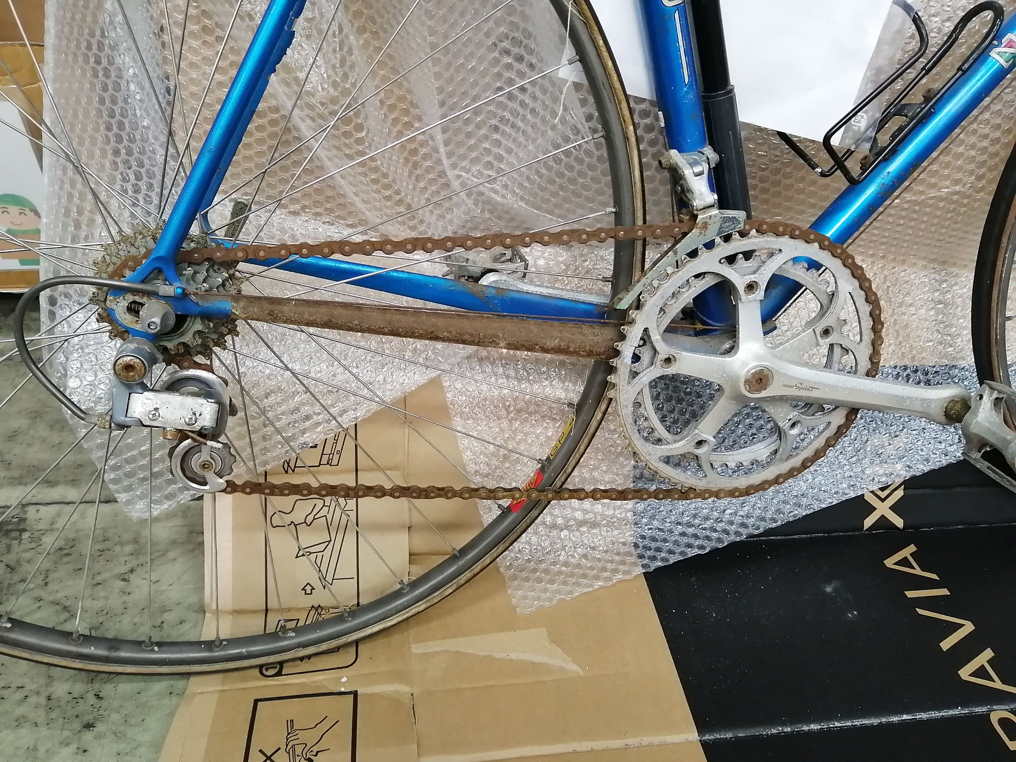

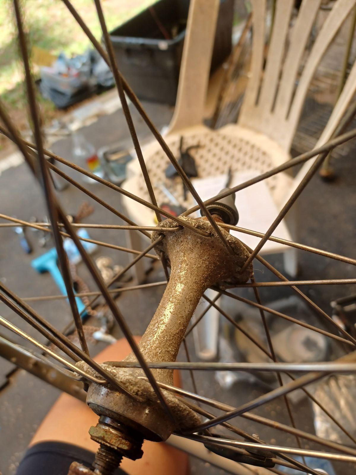

This is what was left of the chainring. It was coming off in pieces. It felt like something that you would see on a wreck dive. Luckily there was a handy youtube video to show me how to remove the bolts that got messed up using a wrench and allen key.
So as it stands I have removed the components from the frame and the printing shop has taken photos and measurements of the decals and should give me a sample set next week. I went to 2 shops to see who can match the colors as closely as possible. As for the other components front and rear shifting were crisp and braking performance seems solid. I am currently looking up ways to restore them as they are rusty as all hell. They currently sit in a bath of WD40. Will post a follow up since I am limited to 10 photos.
Likes For LeSexyFishorse:

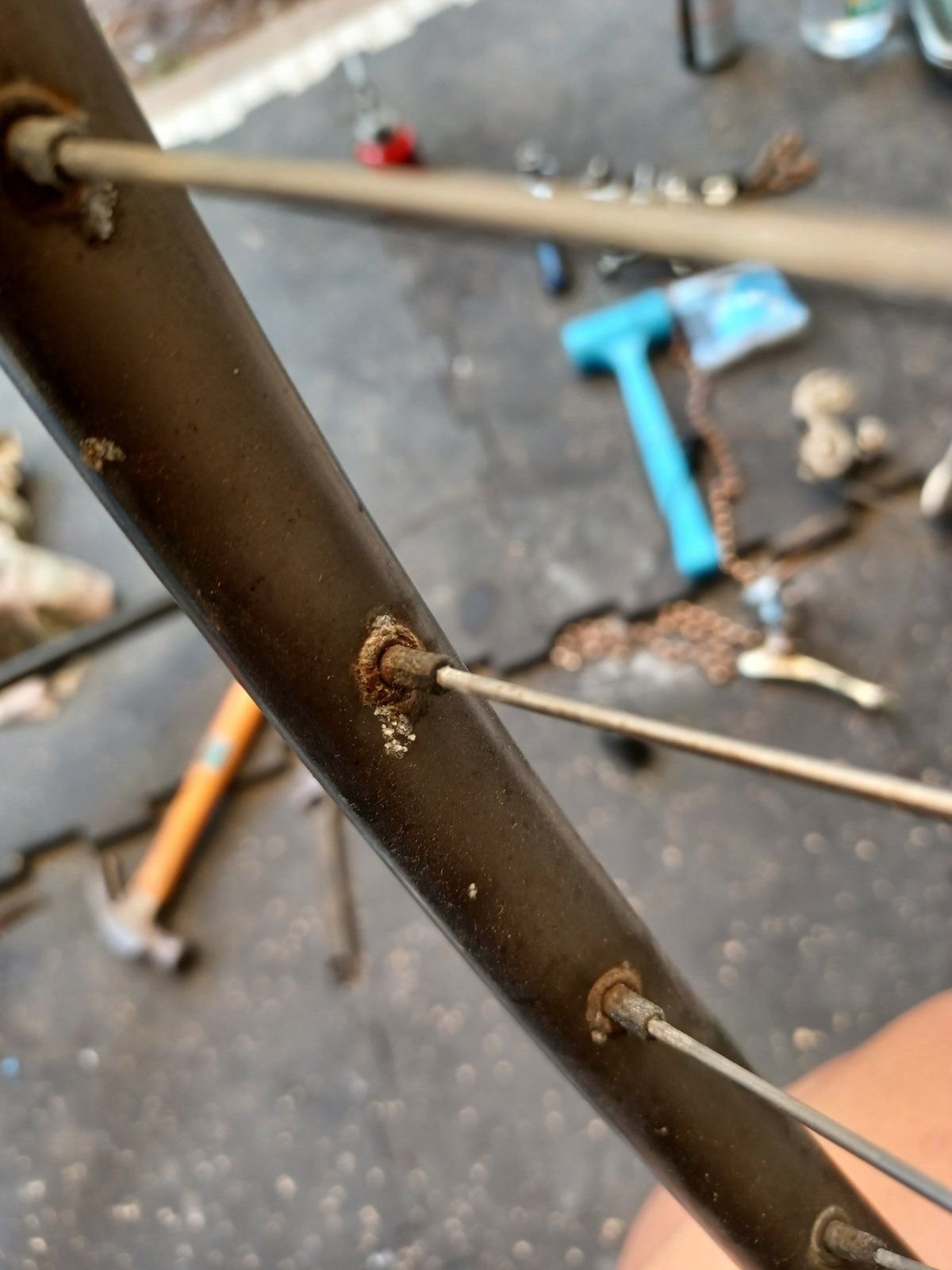

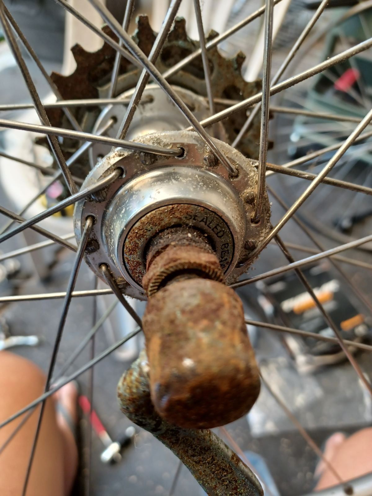

1. Wheelset Issues
My problem is I do not have Suntour tool to remove the cassette. So I will try to clean off the corrosion while it remains on the wheel using wd40. Any ideas on manual removal without the tool? How likely will this thing need servicing and what kind? As for the wheelset, they seem to be sealed bearings which is prob why they still run very well. Not as nice as my Superbe Pro track ones but still quite good. Is it worth replacing the bearing cartrige or is that unnecessary? Spokes nipples also horribly corroded, fine or risk of snapping them off? I have never rebuilt a wheel but I guess I could learn . Aside from this I intend to do the WD40 and steel brush dance dance on those hubs to clean them up. Then maybe some sandpaper for polishing.

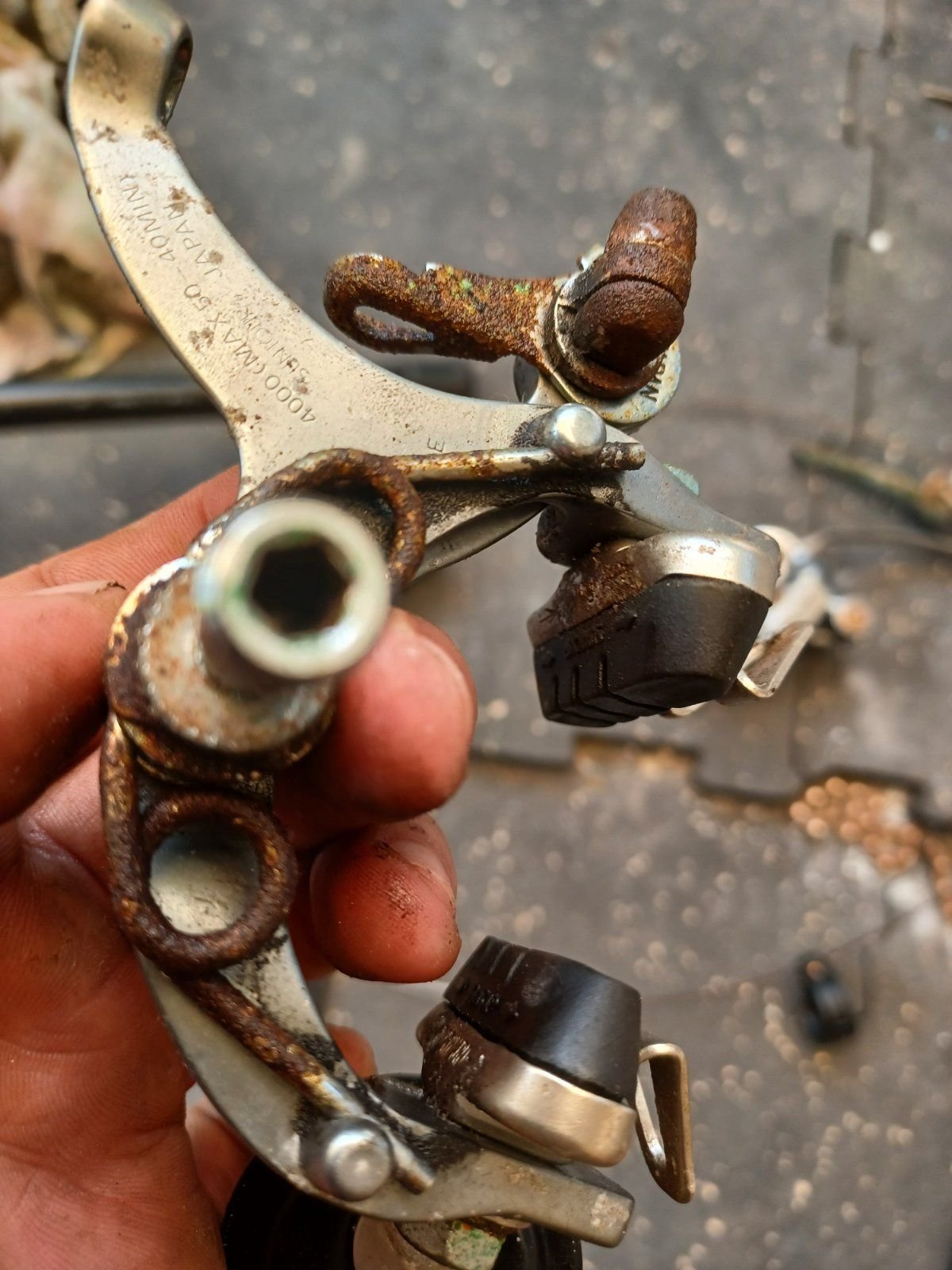

2. Brakes Issues
Mostly just rust problems here, I intend to strip them down and soak the rusted parts in white vinegar then wash it off with paint thinner or WD40. Maybe use a wire brush if necessary. If the current WD40 bath its in manages to remove the rust I might skip to just sanding and polishing. If you guys know of a better way to restore these please let me know.
3. Drivetrain Issues
Shopping around on 2nd hand marketplace here for old 53/42 chainrings to use. Saw a NOS shimano 105 53T chainring with the same 130BCD. Do you think this would work? I would like to to a 55 chainring if possible. Do you forsee any issues with a 55/42 setup? Any suggestions on some good quality modern chainrings that dont cost the price of the bike?
RD has been tricky to find videos or instruction for. So far I am going of RJ the Bike guys vid on Suntour Seven disassembly. Not the same I know. If anyone knows of instructions pref in video format for Suntour Sprint specifically or a previous RD with a closer build please let me know.
Also, what do you guys do with the little rubber parts here and there? For example the rubber seals on the brakes or the RD guide wheels. Do you replace them or just add some oil and re-use?
So its cleaning and restoring the parts plus deciding on a paint scheme for the next few days until I am satisfied with the decals. Once I have decals I will stage the build by rebuilding with existing components and riding for a few weeks or months to iron out kinks and pay my respects to the original color. Then I plan to teardown the parts, replace what I need to replace and have her re-painted.
Please feel free to provide input if you see anything jump out at you. This is my very first road bike and my very first restore. I am sure there are finer details that I am missing that a more experienced eye can show me.
