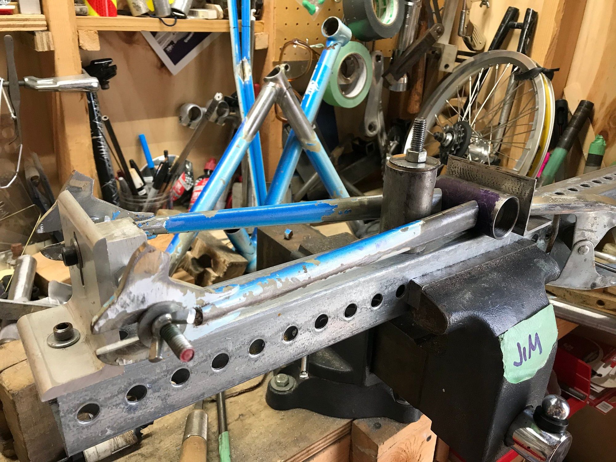

dear Community,
Jigging and Mitering the rear triangle ... - seems to be a nice challenge.
well i think constructing the rear half of a bike frame poses many more challenges than the front half.
Besides the tubing choices we ve got questions about techniques for jigging these assemblies - and in aiming so to create some nice framebuilding tools that help here:
Well - in order to assemble the chainstays as accurately as possible, i plan am to build
1. firstly a jig-mitering tool that mimics the final positioning in the finished frame
2. going to elaborate this a bit more.
Doing so: this hope that i can finalize the miter on the seatstays: I have had a quick view on the mitering-tools and chainstays that are out there:
recently i saw the chainstay fixture - here - at the instagram account of Kristofer Henry ( https://www.44bikes.com/ ) - Well - i like this it looks very impressive. (see the chainstay-fixture at his page ( or at the instagram account. )
see this - it looks so awesome - created by Kristofer Henry -
one question - does this tool need (and afford) a bending process of the tubes that takes place a bit earlier - i.e. right before they were put into the fixture. And besides this - the question for all of you. Which chain-stay-fixture and mitering-tool do you use.
By the way: afaik the tubes tubes (of the chain-stay) for a street-bike are straight - with no windings - so iguess that they are bended seldom - isn īt it so!?

I have always just hand mitered my chainstays. No templates. I'm building a fixture because I want to check clearances ahead of time.
Paragon has tubing blocks. They said all of the sizes will be back in stock this week. Alex Meade has tubing blocks with oval cutouts for fork blades. I haven't seen tubing blocks for oval chainstays. Vee blocks work fairly well since there are a number of different chainstay sections.

Here is the 44 bikes fixture
The second round bar on that design doesn't add anything.

hello dear untershausen
first of all - many many thanks for the quick reply - glad to hear from you
well - thank you for the comment. - i have seen dozens of chain-stay-mitering jigs - but this seems to be the most elaborate and sophisticated i have seen in this whole year.
btw: are those tubes - /(which look like very interesting -(note: they are not straight but look like winded while being bended with special tools:
in other words.- Do they fit especially for Mountain bikes - but not so much for a street-(racing) bike!?
and besides this: the both blocks which are marked - (with a red marker) - they look very very sophisticated and complex.
Look forward to hear from you

Yes, he said that the fixture in the insta that I linked replaced his older one. I'm not sure it's significantly more sophisticated than other fixtures I have seen. It's nice though. The blocks at the front are cut away for clearance. Otherwise they are just vee blocks.
The tubes are chainstays. They look to be something that is commercially available, but maybe he added some bend. The interesting thing to me is that they are mitered off-center. I'm not sure that was intentional to add a little more clearance. I assume they are for a bike with big tires. Some people use s-bend chainstays for road bikes, but these have more bend than would be required for that. These appear to be for an all-road or mountain bike.

i also guess that the chain-stay is for a big with bigger tires. To me it looks exactly this way. I get the same impression as you do!
the question for me is - do we need to bend the tubes in the chain-stay.
for some kind of bikes - it seems to be obvious or mandantory - (eg for bikes with bigger tires perhaps) but if we take street-bikes - i guess that the tubes are very often just straight - aren īt they!?
i can second your statement: "These appear to be for an all-road or mountain bike"
i have the same impression!

I made a version of the setup pictured above using Alex Meade's tubing blocks for small oval tubing.
chainstay mitering setup
It wasn't the easiest thing to use but the results were good. If I had a drill press, I could have clamped this to the table and done it that way. Since I don't, I used a hand file.
I then joined the chainstays to the bottom bracket using a similarly rudimentary setup.
The real disadvantage of this kind of setup is that you have to check everything very carefully - there are 100 ways it can go out of alignment, out of plane, crooked, etc.
