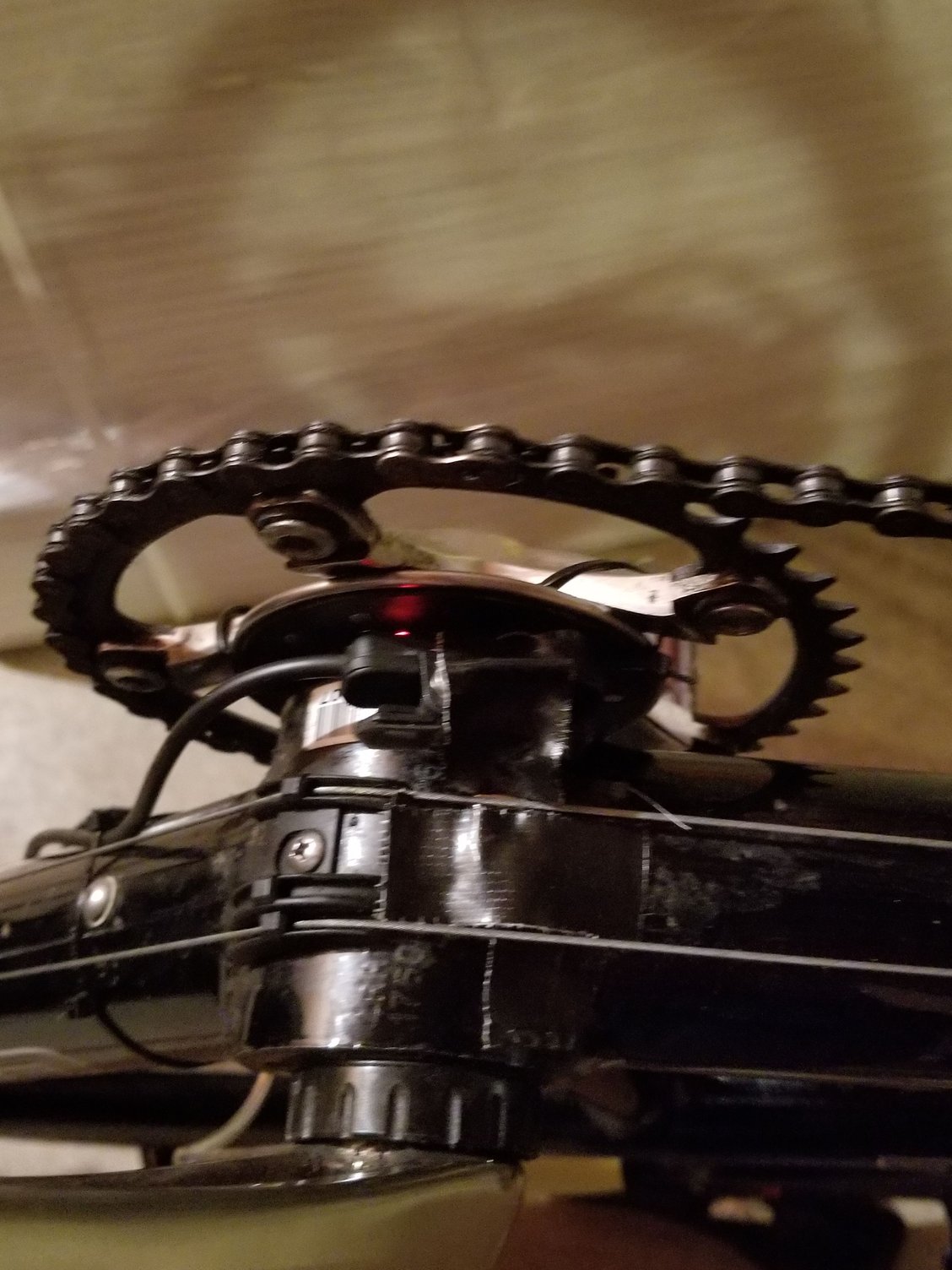

Found an L bracket in my parts bin and shored up the sensor, which is working great. Long term I will anchor it a bit better but this should be good enough for light riding and test runs.

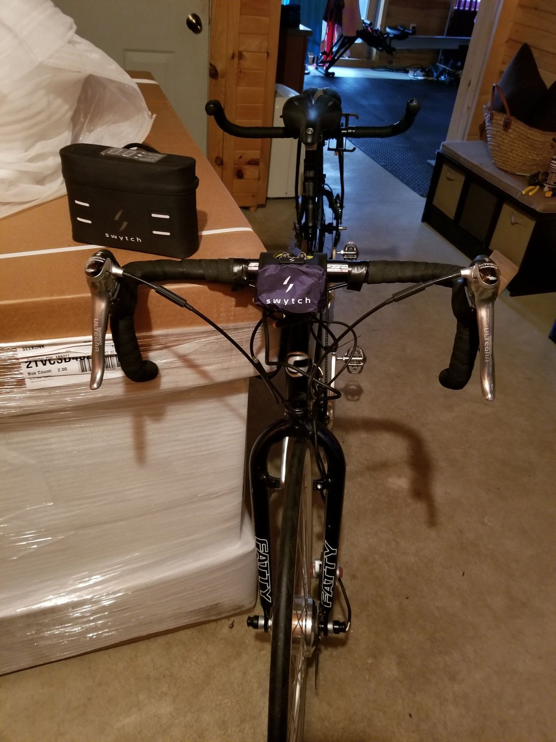

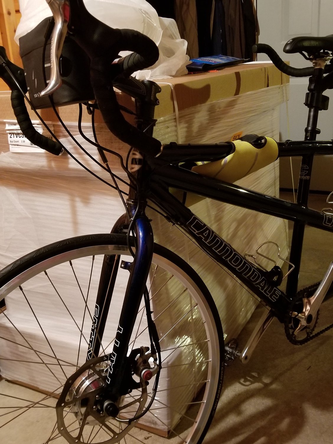

Tied in the wiring, which really doesn't look that bad, just like additional cables. Very happy with the look. Will make a list of pros and cons and probably break it down in my opening post so that newbies can avoid my additional adventures on the first kit. The good news is my wife's bike has plenty of clearance behind the crank so that should be smooth sailing.

You might want to run the motor cable on the outside of the fork so it can’t rub against the tire (as happened with mine. )

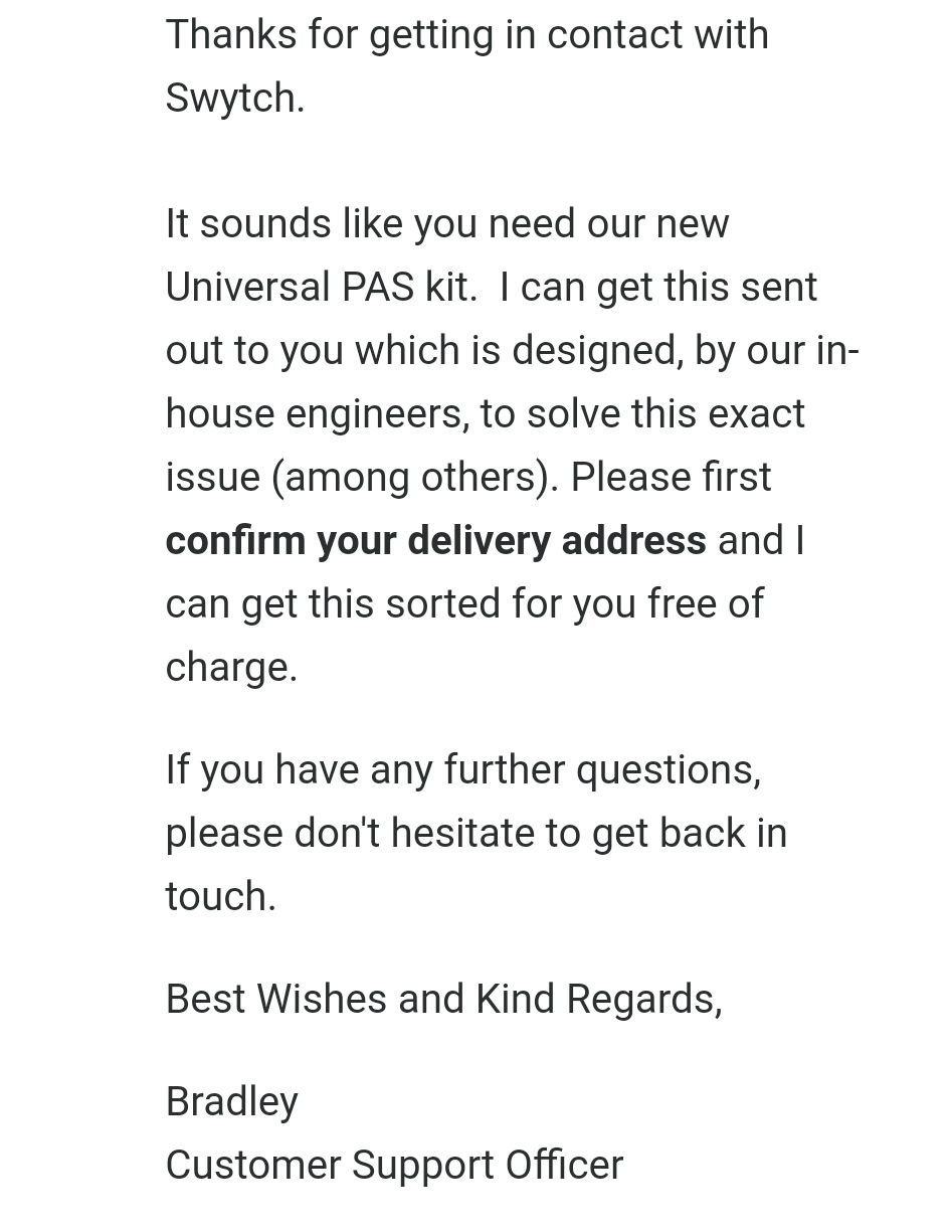

I put a request in for the PAS sensor that mounts directly to the arm to see how they respond. I looked through the support section and they have a nice feature offering video conferencing during the installation. On the down side the 1st appointment was 10 days away. They have a lot of support and guides and admittedly I pushed on without relying too much on them with mixed results.
Overall I found the PAS sensor system the most challenging. I would say it is critical to have the right one selected if you want to pop the system on and go. I probably lost 2 hours between researching how to modify the sensor that came with the kit and adjusting it to fit.

A follow up on the sensor. I asked Swytch for the PAS that mounts directly to the arm (can't hurt to ask) and they replied no problem 😁
So +1 for support after getting the product.
