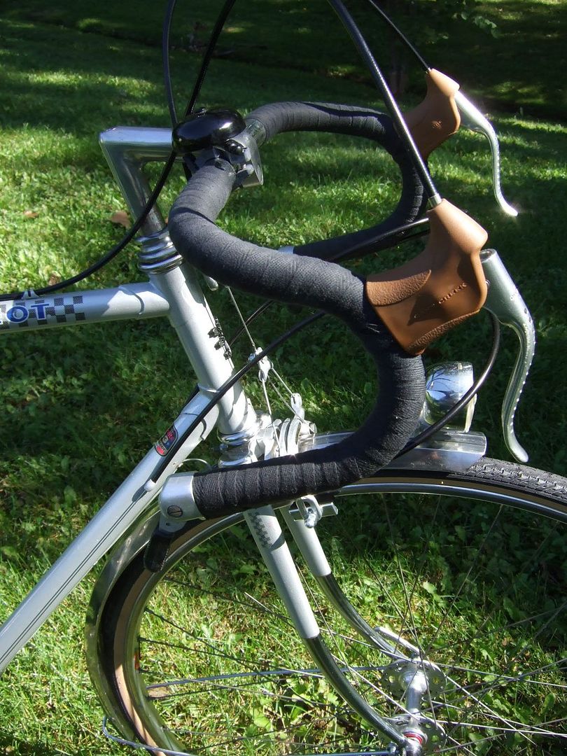

Speaking of clean. Start from BarCons and wrap to brake band; start at top and wrap to brake band; at the brake band end wraps under the hood.
Anyone remember the Rhode Gear Leather Wrap Kit? It was stitched so that you could end cleanly at the both ends end. The cabling could come out anywhere you wanted along the stitch seam.

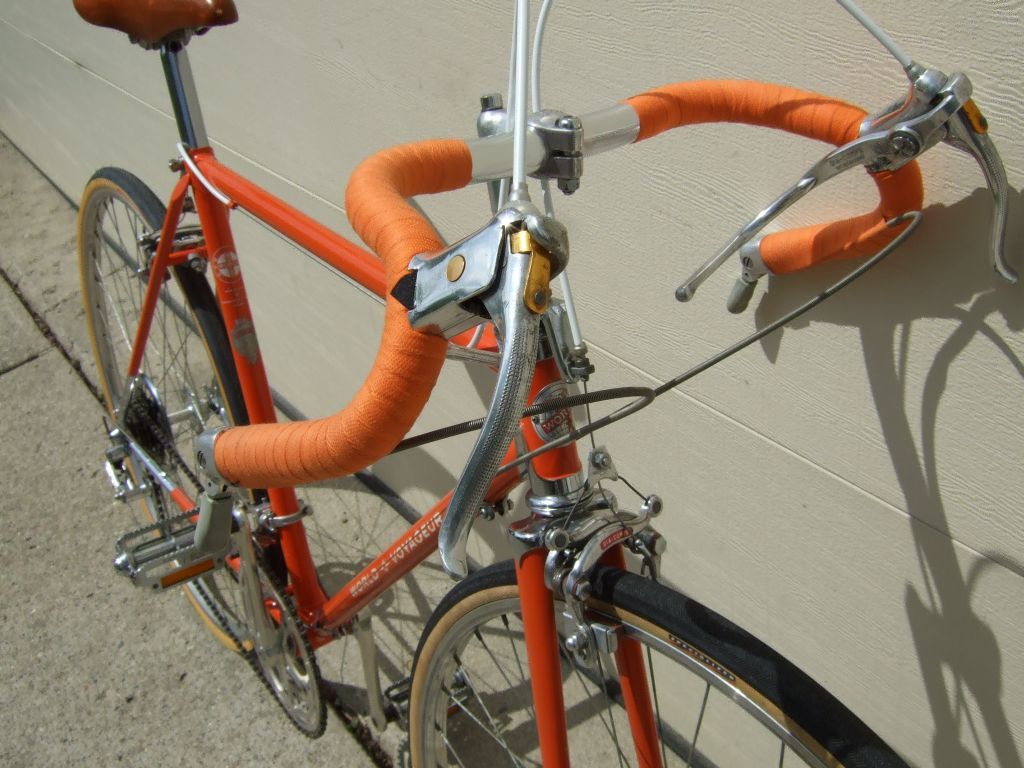

Start at the bottom, work to the top just like always, I just don't tuck in the ends. I like to use cork but I always remove the 2 sided tape as I find it unnecessary and harder to wrap with..

I don't think I've seen anyone else mention it recently, but there is the option of starting at both the top and bottom, and finishing under the brake hoods. Not sure how much this is affected by differences in brake hoods, but it seemed to be okay with my Shimano levers....
For this harlequin wrap, I didn't see any other good way to finish things.
This is partly because I wanted to transition to all-black tape near the levers (to hide the dirt), and because I refuse to use either twine or plastic tape when finishing cloth tape.
My harlequin wrapping technique could use improvement, but I think that finishing the tape under the hoods worked fine!
