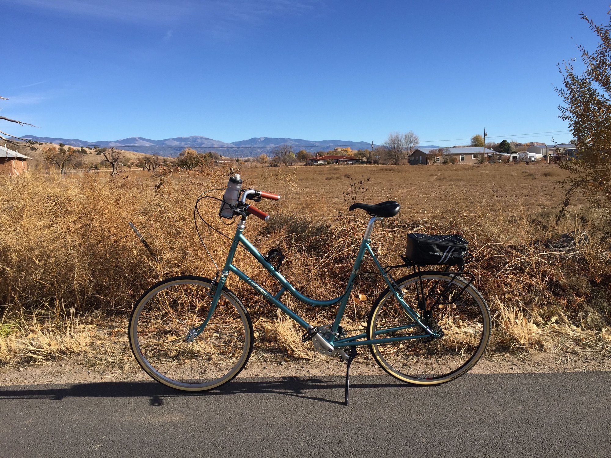

Rivendell Clem Smith Jr. step-through frame
Although steel, my brother's new Clem Smith Jr frame, built up as shown, weighs 32.2 lbs. in total. And it's huge.

Steel mixte frameset from
www.somafab.com
The Buena Vista is available in rim or disk brake version ~$600.
