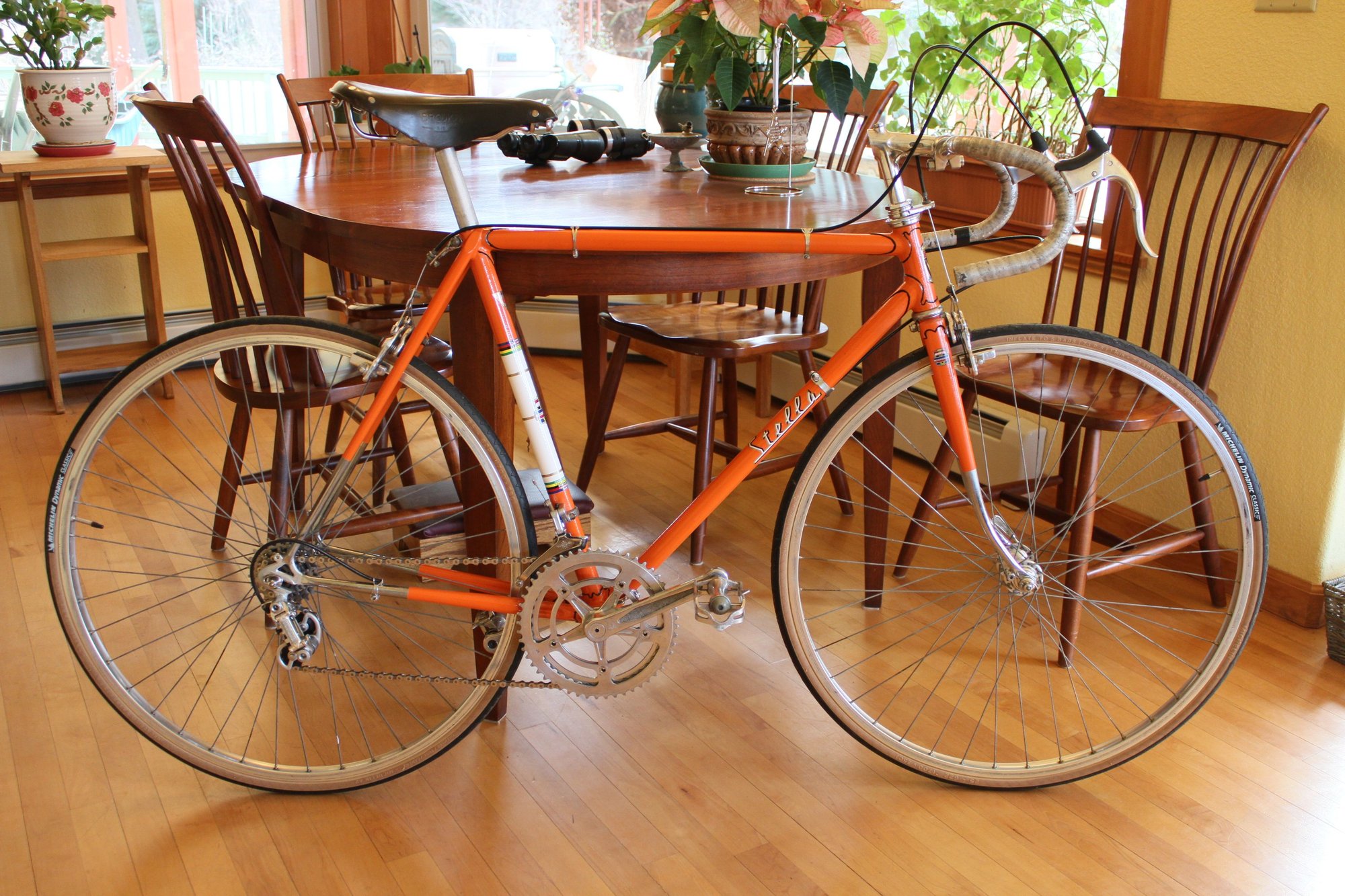

Trimmed a cheap paint pen. Still gave slightly thick lines, but OK by me. Don
1971 Stella Series 70
Almost complete

One Shot with a brush over brushed on Rustoleum.
Classtime , that whole paint job looks great. Did you thin the Rustoleum? How many coats? Sanding between?
ehcoplex is offline
Old 03-31-23, 07:07 AM
Classtime
Classtime's Avatar
Location: Los Angeles
Posts: 4,524
Mentioned: 52 Post(s)
Quoted: 1863 Post(s)
Liked 1,788 Times in 1,011 Posts
IME, a new can doesn't need thinning. I had the can at room temperature. Three coats of primer, three coats of color, waiting a week before sanding after each coat. The waiting at least a week between coats is key. It held up really well for two years of commuting. The picture with the Bontrager bar tape was from my for sale pics. I miss that bike. At the time, my wife was still counting bikes
