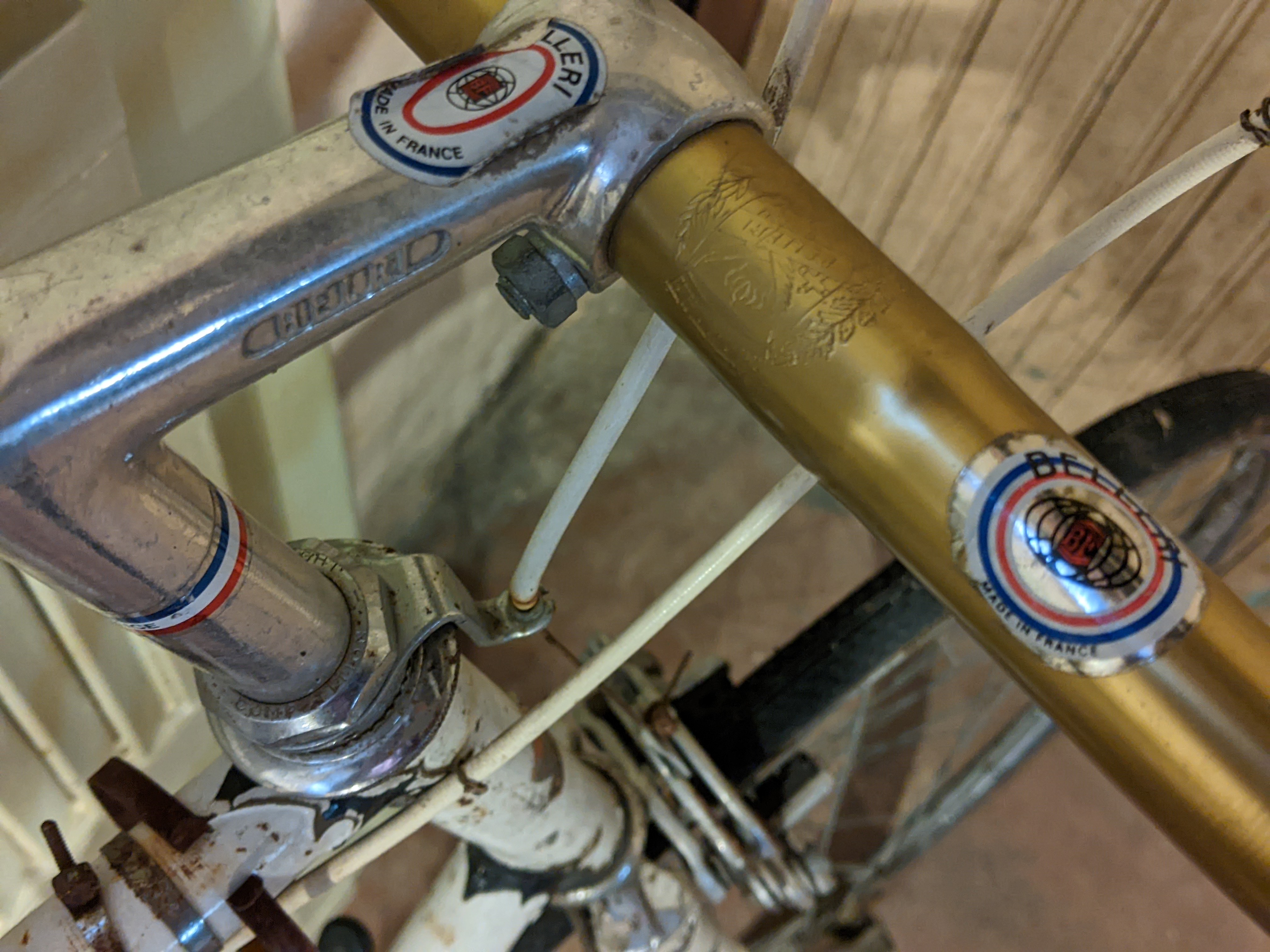

The fork decal is a very good sign. What size is the seatpost? Mid 26 should mean butted main tubes.

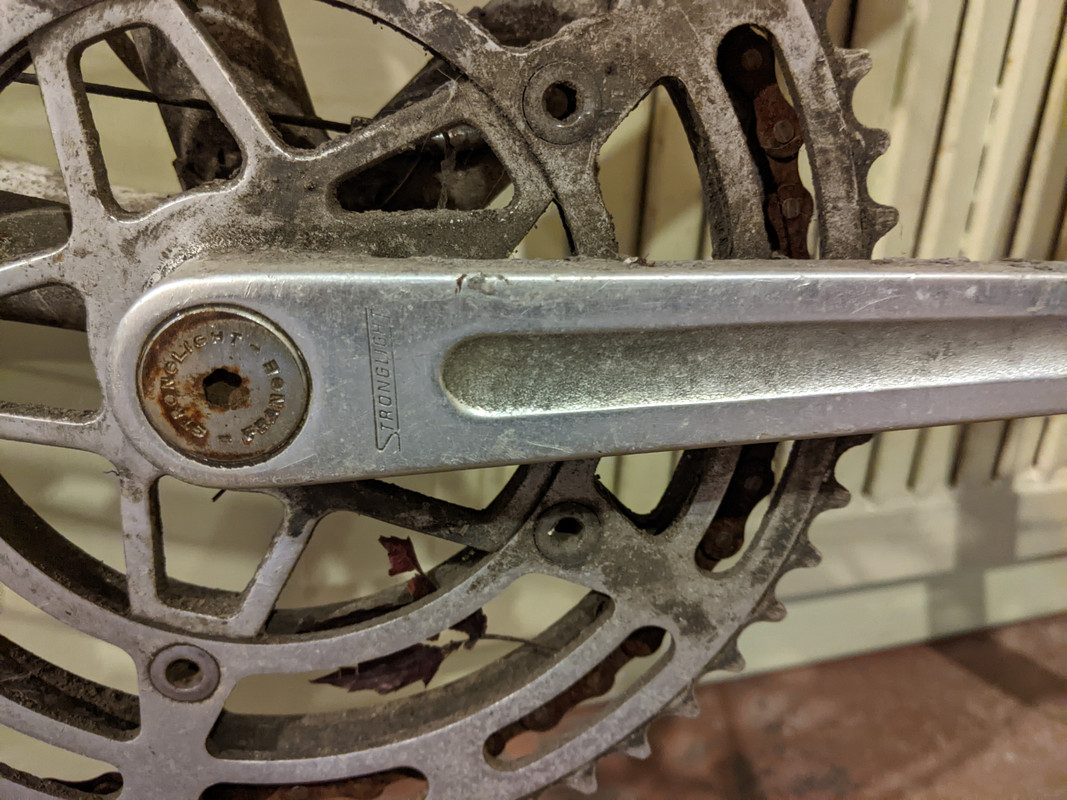

Does anyone have a year estimate? Any idea why there's a wire loop on the bolt that attaches the front brake?
brian85 is offline

Originally Posted by brian85 View Post
Thanks!
"wire loop"
this thingus is termed variously a "tyre saver" & a "flint catcher"
the idea is that it knocks off small sharp bits which may get stuck in the tyre's tread before they can go round again (and again) until they cause a puncture
date -
currently leaning toward nineteen and seventy-three
would need better image of chainset to determine; may be slightly earlier
pillar size -
26.6mm (may be marked 26.4mm)
juvela is offline

Wow, I've never seen front chainrings with so many "holes!" Is that a weight-savings thing?
is this a 1969 PX10 that you own?
Yes, weight weenie madness, plenty of factory and plenty of homegrown/machining examples abound as well as exquisite craftsman work, Jon Williams, Curtis Odom and many others.
I'm no expert but also leaning towards older, the DT livery is earlier than many that we see, 69-73 could be spot on, very cool no matter what, even as rough as it is.
And as Tom Peterson always said, "free is a very good price".
'LXXII nominally out due to lugz...although there was a small sprinkling of transitionals
a better chainset image will permit closer bracketing

The seat tube decal appears to be a triangular shield (hard to tell) and not a square one so that would be pre-1972; down tube lettering is gold like pre-1972 as well.
Downtube lettering is I believe pre-1971, thinking this bike is 68-70 range.
The fork rake appears to my eye to be pre-1973, later forks has less rake bend in them.
I try not to judge angles from photos, the parallax distortion can change the angle that appears on my screen.
A straight-on photo from the side, taken at considerable distance, will best render the angles semi-accurately.
It's not unusual for the larger frames to have a steeper headtube angle, not sure if that's the case with old PX10's though.
