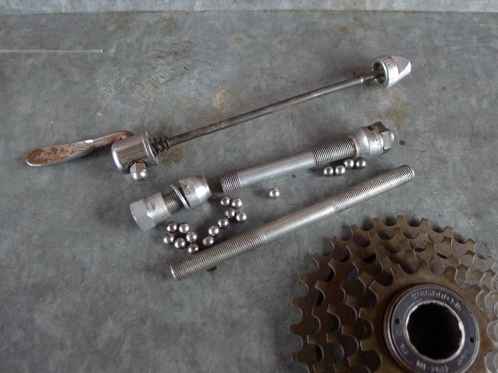

Dealing with a broken rear axle on old Raleigh with vintage Japan components.
Bike shop sold me a 3/8 x 26TPI axle, which did not jive with my cones, that don't look so hot.
I bought an old/new axle set just for the new cones, and also found the axle I needed 10x1x131mm on feeBay, although I have yet to see it, even though coming from the same state.
Also picked up a 500 ball assortment of BC Precision ball bearings in the popular sizes, as well as some Park grease.
Owning any old bikes and new having replacement balls/grease on hand would be madness.
The axle from the bike shop measure 3/8" x 26TPI x 135mm and I can't use it.

Liked 5 Times in 5 Posts
I was finding them on Amazon but the key seems to be knowing how to read the descriptions. Many sellers measure incorrectly or include incomplete info so its good to know what exists and what doesn't.
the one I think might fit my bike is:
HUB AXLE SET RR WM 10x1x130x141QR7sCRMO
I think "hub axle set" means it has cones and locknuts
rear
wheels master
10mm diameter
1mm thread pitch
130mm OLD
141mm length
quick release
7 speed freewheel
CrMo steel
but they're selling it as a 130mm axle. It took me forever to figure out that there is no such thing and it had to be a 141mm.
I have no advice on cones, I was just hoping the original ones would fit the new thread pitch (1mm vs 26tpi) or the new cones would have a close enough curve to function with the same balls and cups.

Actually, QR rear axles of approximately 130mm length were common at one time.
Given the photos you posted previously, your rear hub appears to be a freewheel hub; your freewheel appears to be a 5-speed Shimano freewheel. That implies that it's likely 120mm OLD and thus needs an axle about 130-131mm in total length: 120mm for the distance between the dropouts, and 5-5.5mm protrusion on either side for location within the dropouts. This is consistent with the photo you showed of your damaged rear axle having an overall measured length of a bit over 131mm (the damaged section not "mating" perfectly IMO would account for the slight excess length).
Such axles still available: https://www.ebay.com/itm/264628976557
The link is for a NOS 10x1x131mm axle designed for use with Shimano freewheel hubs having an OLD of 120mm. Based on the caliper measurement you posted previously of the length of your existing axle, I'd guess that's the length rear axle you need.
Unfortunately, it's only the axle. So an axle set with cones is likely what you'll need.
If you ordered a 10x1x141mm axle set, I suspect you may have to shorten the axle you ordered substantially to make it work.

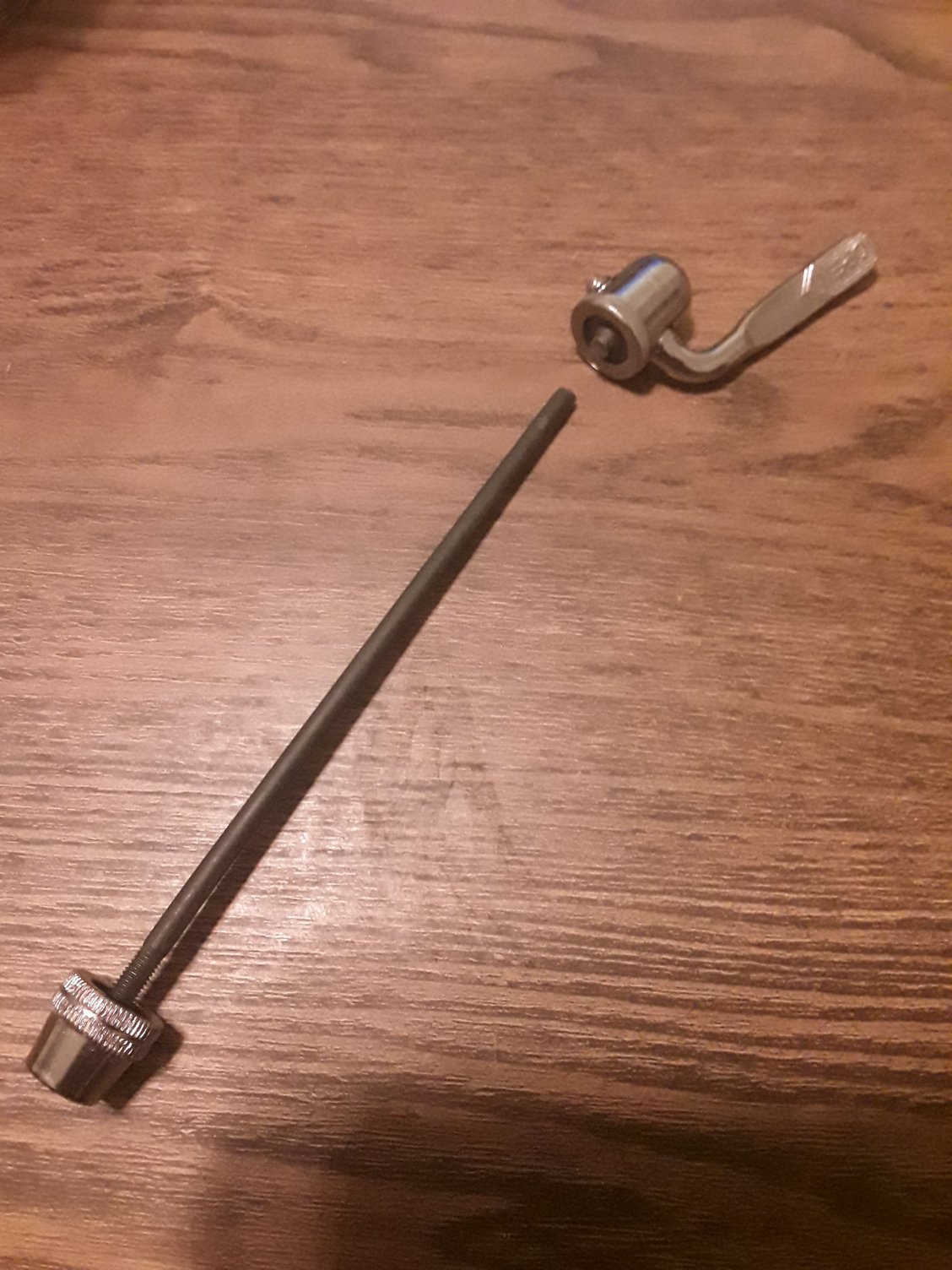

I decided to wear a helmet to the store today. You guys kinda freaked me out and while I really can't live without risk I'm not completely crazy. As I was on the way there, maybe 8-10mph (normal speed on this bike), with my weight back, I asked myself what I'd do if the skewer broke. Then I realized, I already did break a skewer on this bike!
Last winter I used a $45 stationary trainer all winter. It came with a QR skewer. Of course I got what I paid for...
It broke as I was heading out of my apartment complex (I think I stood up because downshifting is hard on that bike).
You've probably experienced what happens when a bolt-on or QR axle is just a tiny bit loose. It works fine until you pedal hard, and then the right side pulls forward and the tire rubs against the left chain stay.
That's exactly what happened when the skewer broke except the tire was rubbing much harder. There was no option of simply pedaling thru it like you can sometimes do before stopping to tighten the axle. I was going slow and came to a stop in a matter of feet.
I bent down to tighten the axle and the lever end fell on the ground! It's funny now but I was pissed when it happened.
So, if you wanted to know what happens when a skewer breaks (at least on a low end '78 Schwinn with horizontal dropouts), now you do.
Also I wanted to say I do appreciate everyone's advice, even if I don't take it.
Hope your next ride's a great one.

This is a pic of it here, the store sold it to me not realizing it was SAE thread, not metric.
Nice axle, I would have taken it back to the shop by now, but way out of the way.
