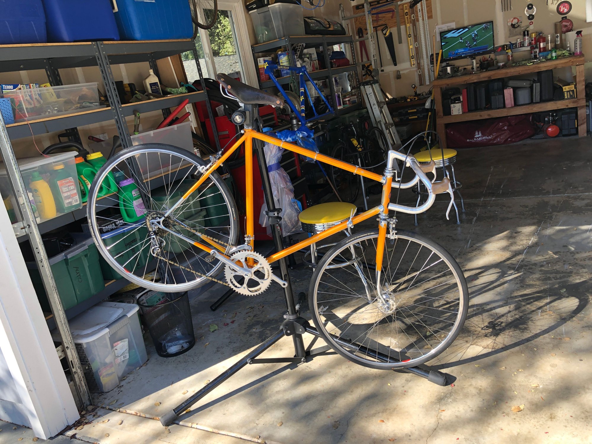

I picked this up earlier this week after seeing it on the eBay CL thread. It was advertised as an early 70’s paramount.
serial number of K942. Based on the Waterford guide I think it’s from October of 1969. Am i interpreting this correctly or could it be something else?
Would this have come with Nouvo Tipo hubs and 27” Fiamme rims?
is there a way to tell what model Paramount this is?

congratulations on the new arrival...looking good...luv the colour
have never heard of any model of Paramount of any year coming with NT hubs or FIAMME wired-on rims
the curved lever QR skewers that are in there did not exist in 1969
pedals are Sheffield Nr. 655 which also came on no Paramount of any year

Unfortunately the colt is a really bad rattle can job. So it’ll have to go. But that does give me a clean slate to work with.
I figured the NT hubs didn’t belong, but they are close to period correct (as opposed to the cyclone RD).
I’m thinking only the top tube cable clamps, headset, bottom bracket and crank arms are original.
I’m going to try some 700c wheels with HF NR hubs I have. It feels like it should be a full NR build. I’ll finish up a quick build from supplies on hand as I figure out what to do long term.

The different lugs (begin with a Pr.....) point to 1969 as the correct date. P-13 is most likely the model number.

lug pattern is Prugnat 62/s
employed on Paramount 1967-71

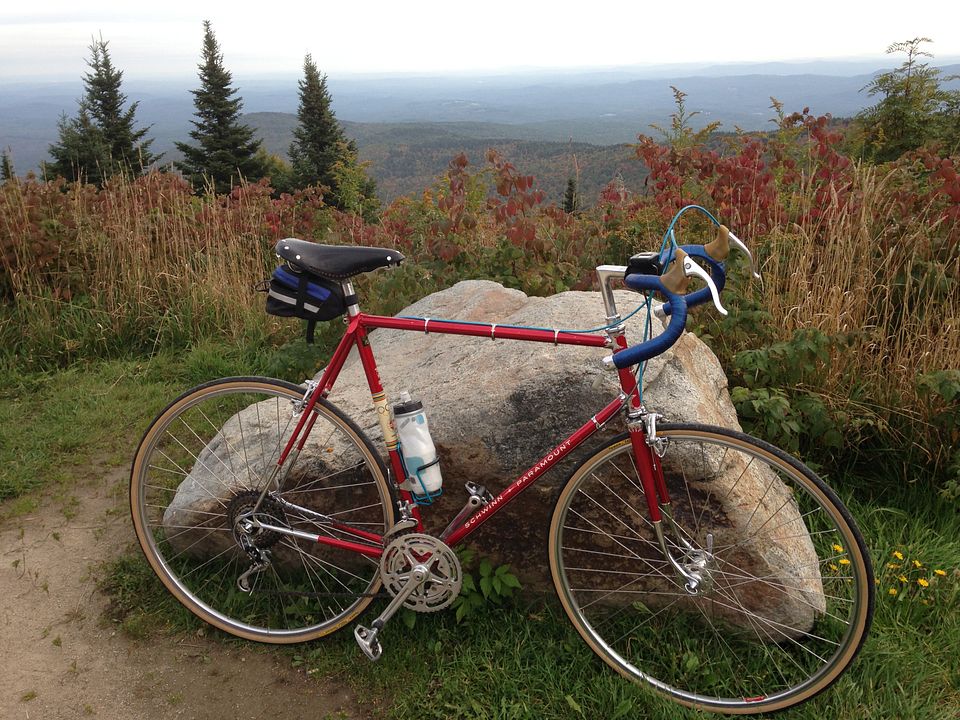

Very nice find. I have a '68 Schwinn Paramount that I have not yet rebuilt but it did come to me with the original parts. It was set up as a tourist though with flat bars.
https://www.bikeforums.net/classic-v...paramount.html

So I did a wick build from the parts bin. The handlebars are 38’s and Cinelli criteriums (the last set of drop bars I have). The bars will need to be replaced but they allowed me to do a short ride.
I put some wheels NR HF hubs and some clincher rigida rims. The brake reach is borderline but works. I’ll file the slots later.
The rest of the build is NR except for the SR RD.
I’ll need to ride it a lot more but first impressions were great.

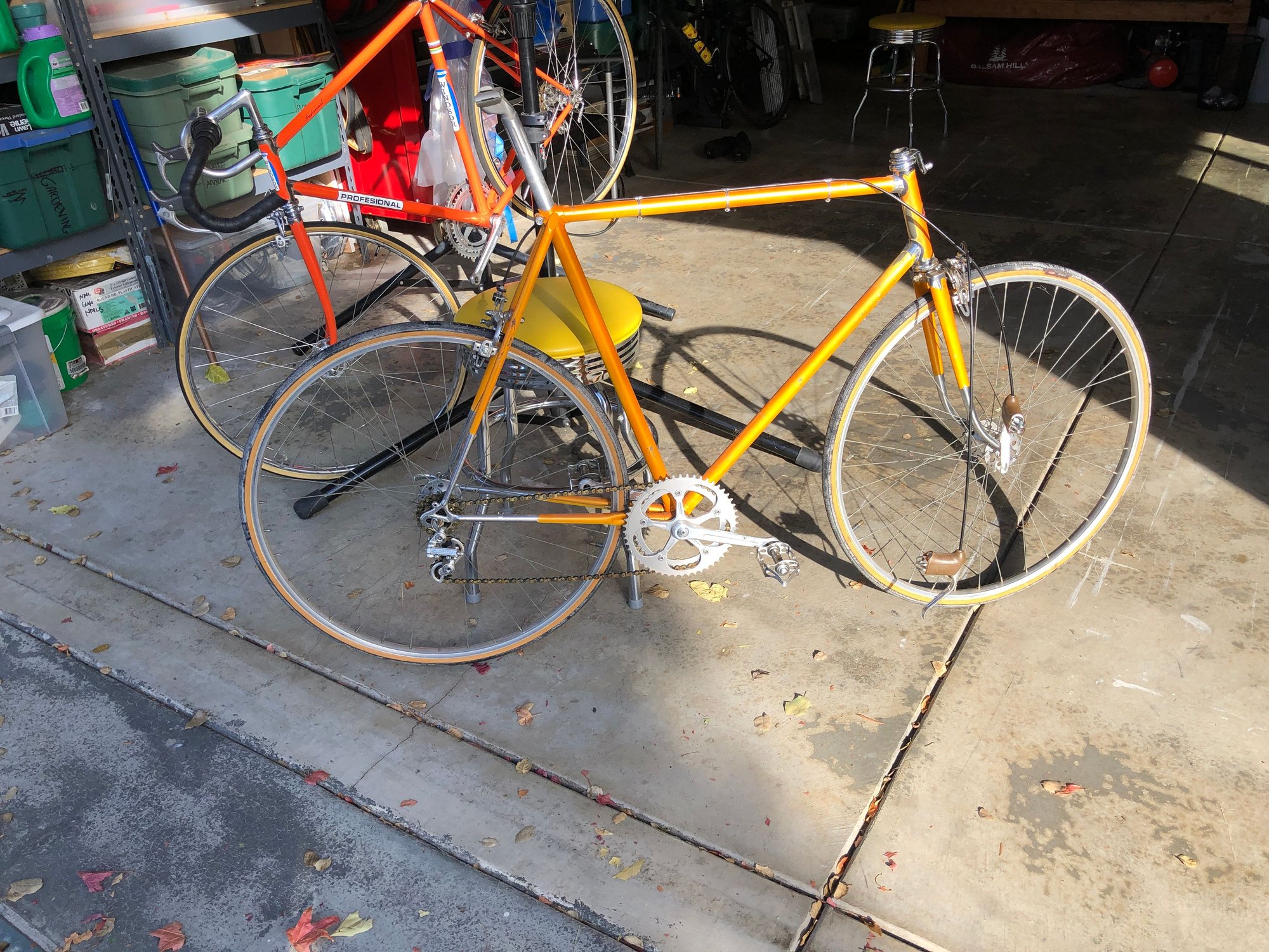

ride - would expect it to be somewhat more forgiving than the A-M
frame might be a few grams lighter as well...

Yes, very different rides. To compound the differences the Windsor is on my limit on the small size and the Paramount is right at my top end. In addition I had my lightest racing wheels (with high end Vitoria tubulars) on the Windsor and did the test ride on the paramount with the Nouvo Tipo wheelset with non racing tires. I have the NR wheels on now with GP 5000 tires. I’m hoping to get a ride in this week around work and travel.

'69 sounds right based on the head lugs, but wouldn't a '69 model originally have had cable guides brazed on the top tube for the rear brake cable?
I thought that those didn't go away on the P13 until ca. '72-'73 when the P13 was revamped and the old P13 became the P10.
Sierra is offline
keep in mind they could be ordered however the customer wanted them
possible this example may be a bespoke one
To add a data point, my March 1971 P13 lacks the brazed-on cable guides and uses the 27.2mm seat post. The '66 P13 I did own also had a 27.2mm seat-post, and cable guides brazed on.
Bob
