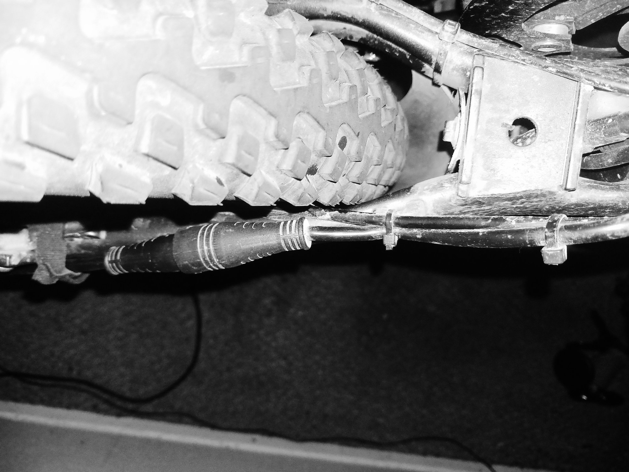

Just reinstalled my rear wheel, and noticed that it's not turning evenly. At one point, it's touching the frame. At almost the opposite point it's a few mm away from the frame (but still not centered). Pretty sure it wasn't doing that before and that I put it back on correctly. What could be the issue?
UPDATE: It seems there are two issues: 1) the wheel is not centered in the frame and 2) there is one spot where it's hitting, but the rest of the wheel is running parallel. Initially I thought the wheel was at an angle or something. But it seems to be in straight, but there's one spot that's hitting. Here's a video: https://www.dropbox.com/s/kiv069hjmt...75230.mp4?dl=0
Touching frame
Not touching frame

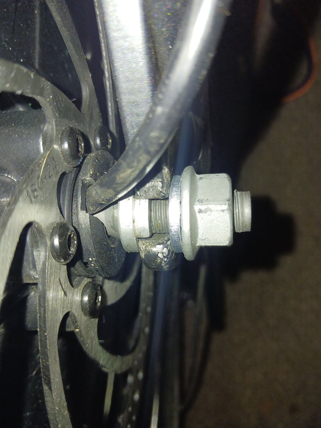

Yes, it's an ebike (2018 RadCity). And, yes, the torque washers are in place.Actually, I just remembered something.
I noticed when I was reinstalling the wheel that one of the torque washers was on the inside of the frame, instead of being over the dropout, as it should have been. This was on the side that's away from the tire.
When I secured the nuts, it pulled the frame in, so that that torque washer was over the dropout and the tab was sitting in the slot. But it should have been sitting in the slot initially, not just when I tightened the nut. So perhaps the frame is bent?
Here's an image that shows the torque washer and how they sit in the dropouts.

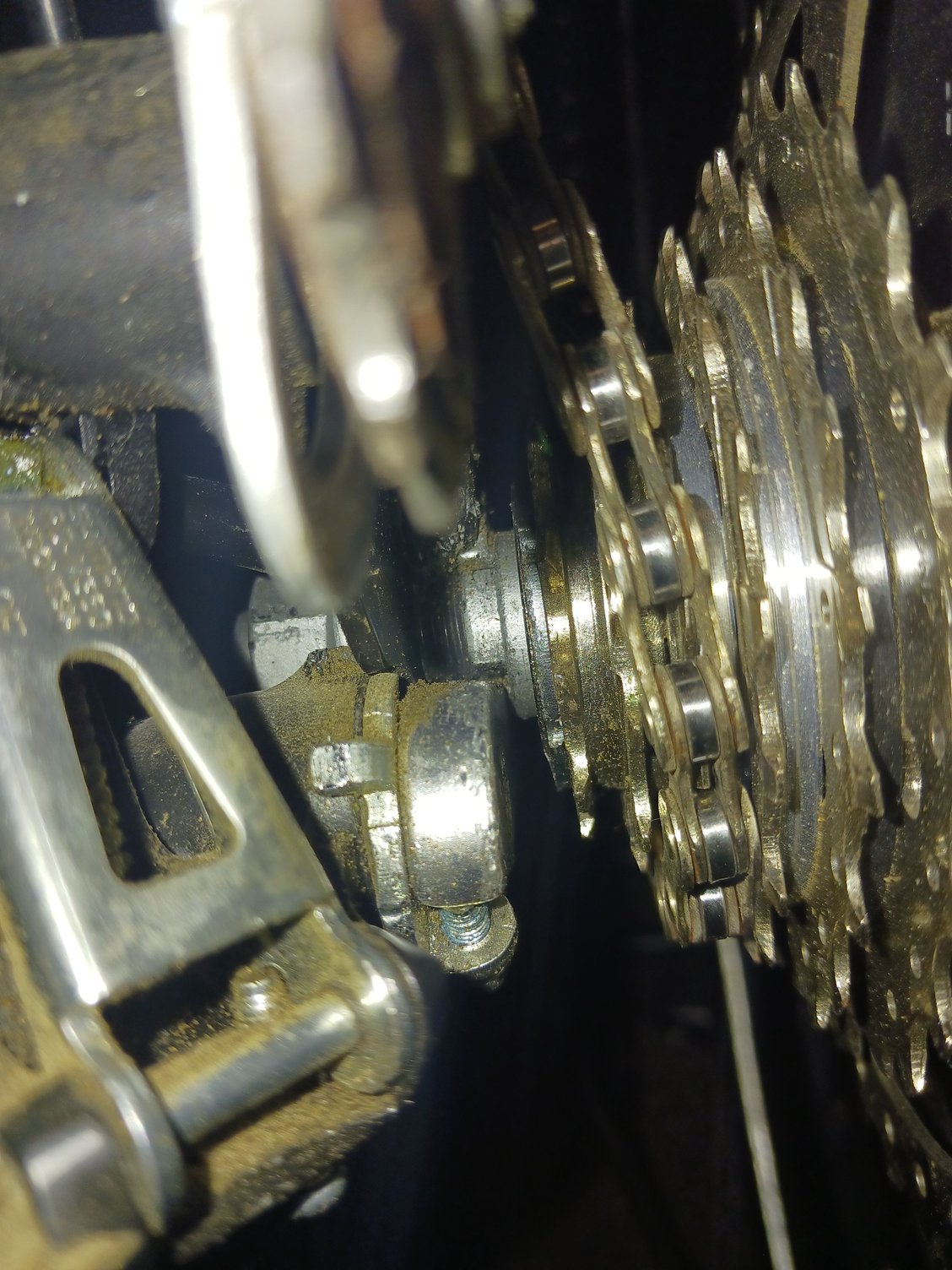

I'm happy to try reinstalling the wheel. But not sure what I would do differently.
I just added some pictures to the post that show the dropouts and the torque washers. Let me know if you see anything that looks off to you.
