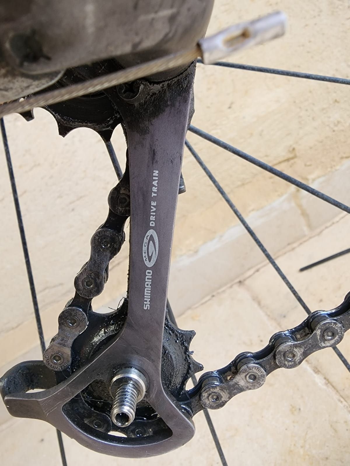

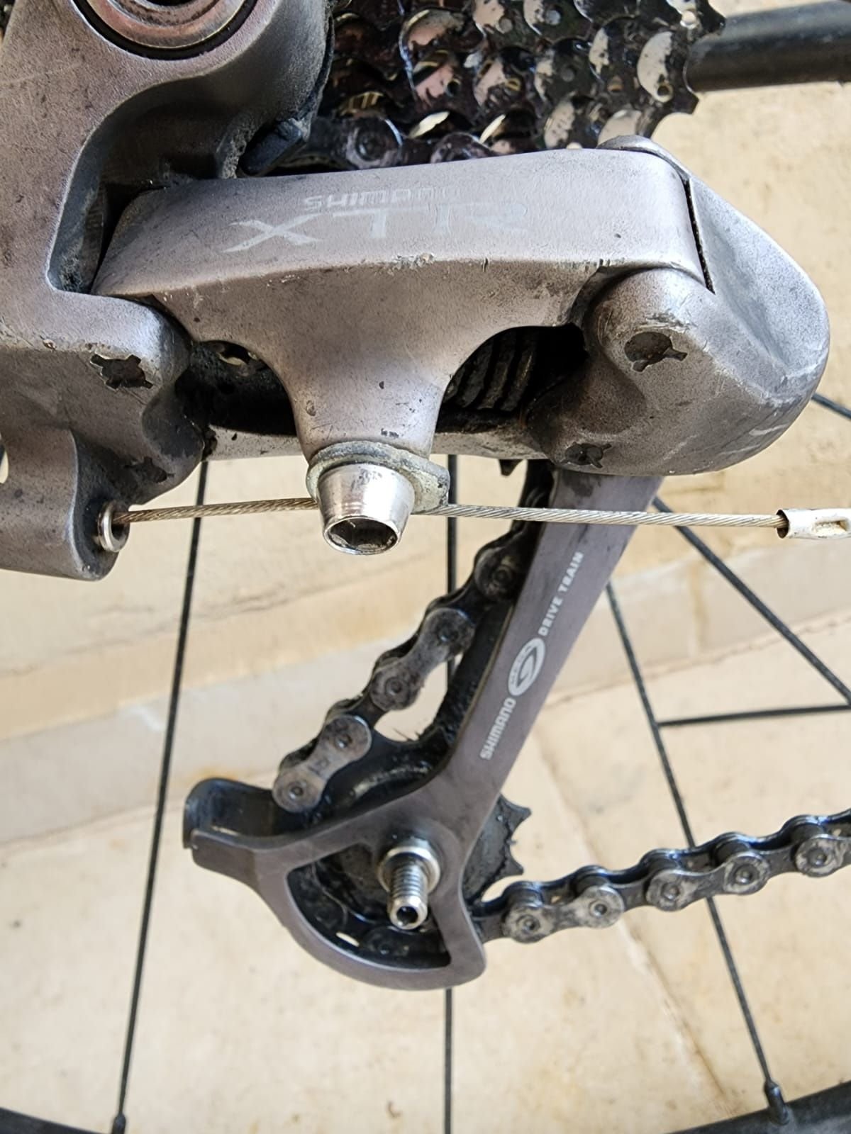

Guys, Thanks for the help! Considering the above I may just get a Shimano Sora FC-R3000 Crankset - 175mm, 9-Speed, 50/34t (current chinrings are ~finished) + new chain and cassttee - end of story 9 or 11 doesn't meeter much to me on this bike
1 question please - the RD in the below photos - what largest cog it can handle ? 36 ? maybe 40? (it currently works with 11-34)

Without a model number, what follows may not be correct. But here goes anyway.
The 9-speed Shimano XTR RDs appear to have been from the late 1990s/early 2000s, and appear to have had 950 or 960-series model numbers (e.g., "RD-M95X" or "RD-M96X", where X is another number.
The oldest Shimano specification compilation listed in Shimano's specifications repository is from 2004-2005. Several models of the M96X and M95X are listed there.
Shimano indicates a 34T max rear sprocket or all of the 9-speed XTR RDs listed there. However, Shimano's noted for being fairly conservative in their specifications. A 36T may work "out of the box" without a RD hanger extender - or it may not. And that may have simply been the largest rear cassette sprocket they were selling at the time.
RD hanger extenders are fairly inexpensive, and may well allow a 40T or larger largest rear sprocket. I understand shifting smoothness/responsiveness may suffer a bit with a hanger extender, but I've never tried one personally so I can't verify that.
Hope this helps. With a specific model number (it will be embossed on the RD somewhere, likely on the inside of one of the cage plates), I might be able to be definitive on what Shimano says.

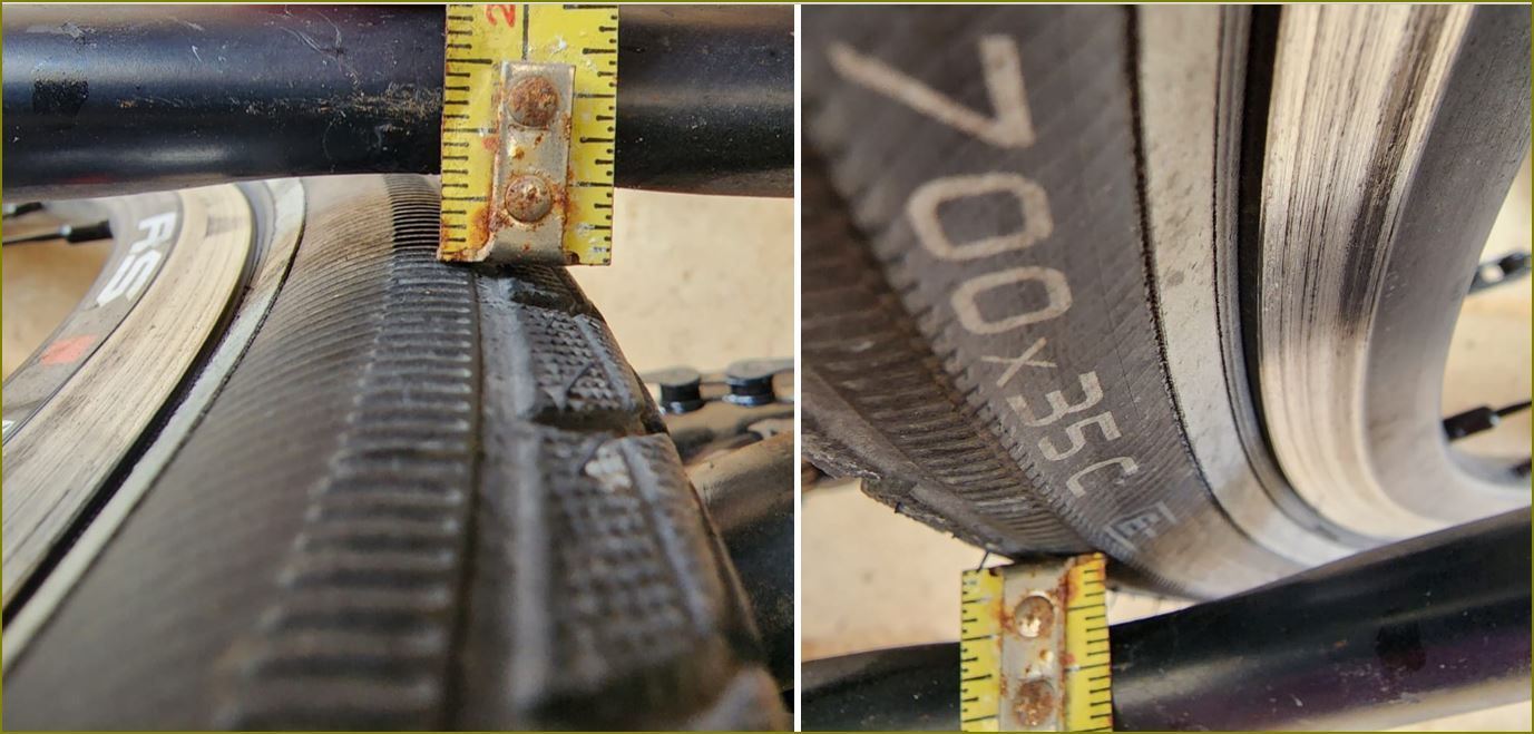

Hi, Can you please look at the enclosed photo? that's a SCHWALBE Marathon Plus 35mm. Do you think this clearance will safely allow a 40mm tire? Thanks!
