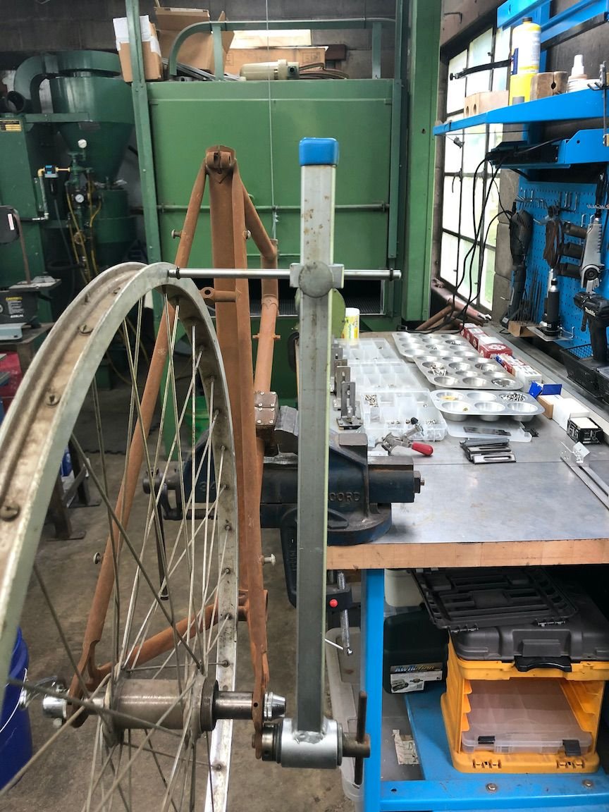

I am a framebuilder that has spread rear triangles hundreds of times in my career. The process can be reversed if one wants to take it back to original specs. It is possible to do it yourself but I strongly advise against it. Most classic era built frames were not that well aligned coming from direct from the factory (except Japanese made frames). Even the very best frames were sold at modest prices that prevented perfectionistic building techniques.
I begin by chasing the treads and facing the face of the bottom bracket shell. The drive side face of the BB shell serves as my reference. Then I align the front triangle on my 3' X 4' cast iron very flat table with a surface gauge to check discrepancies and bend the errant tubes to my will. Often I have to use special holders to stabilize tubes that aren't being bent so they don't move. Now I am ready to spread the rear triangle. It is an unusual frame where the dropouts are already equidistant from the frames centerline. I have a special tool that has a V and steps that shows what needs to be bent so the dropouts are just a hair over 130 and equidistant from the center of the frame. This bending probably makes the dropout faces crooked on each other and they are now bent parallel with "H" tools. Next a dropout alignment tool is used to make sure the dropout hanger is also on the frame's centerline. This is a common source of shifting problems if it isn't right. Then a final check has to be done over the entire frame because bending one thing can move another.
And since the frame is already at a frame builder's shop, it only makes sense to have the fork aligned now as well.
tools to align a frame
using H tools to make the dropout faces parallel to each other
this tool aligns the dropout derailleur hanger.

I would define a "professional" as someone that has the proper tools, knowledge and experience to do the job right. Look at the pictures in my post #18. There is a lot of expense in specialized equipment there. Amateurs are unlikely to have those tools unless they dabble in framebuilding. And even if you have the tools you have to use them properly. Bending a frame combines strength with a certain touch. You pull on the chain stays to widen them and they don't go and then you apply too much and it goes too far possibly damaging them. When you are experienced you get a feel for hard (but not too hard) to pull. If it is a dumpster find you won't care but if it is a 50 year old Cinelli you will care a lot.
If your main tool to spread dropouts is a 2X4, how do you insure your whole frame is still in alignment when you are finished? If you have indexed shifting, do you care that your derailleur is aligned in the dropout hanger so it shifts properly? If you dropouts are not exactly parallel to each other, do you care that when your QR clamps the wheel that the pressure puts a bind on your wheel bearings wearing them out sooner? How far out of alignment any aspect of the frame is before it is noticeable can be a matter of debate. I like all of mine to be spot on. Your standards may be different. By the way, Its going to be a very unusual bike shop that has the proper equipment to spread rear dropouts so everything is where it is supposed to be when done.
Doug Fattic is offline

can be done with basic equipment but not 2x4 easy. Unless you are correct in the assumption that the frame is straight and true, seat tube not bowed. One has to understand the limits of the tolerance stack you have accepted.
I would never respace a frame without H tools.
a frame with a braze on front derailleur mount- just a situation asking to distort the tube.
Not a lot in general but 20mm of one side of the tube is being heated up to brazing temp and the other side not? Held between two points? There will be some movement.
what Mr Fattic is basically stating, know what you have in reference to a strong, reliable datum. So all can be reviewed before and after.
