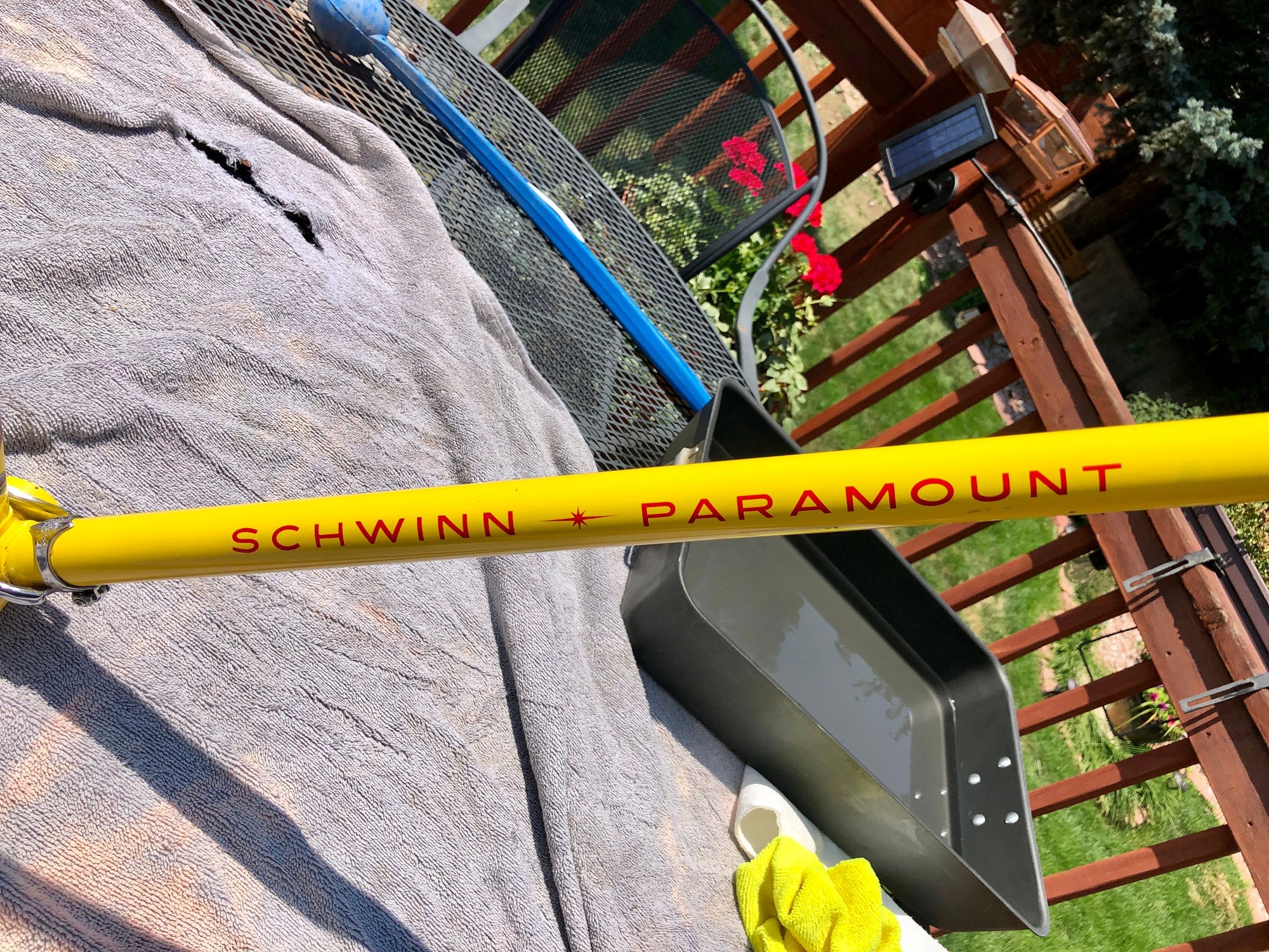

Well it arrived today, a 1971 Paramount P-13-9 Kool Lemon frame! Thanks to Pastor Bob for being my Paramount sherpa....!
1971 P-13-9 Kool Lemon... this is version 1, with the geometry of previous Paramounts, meaning it won't allow Campy brakes, but it does have the Prugnat chrome lugs, rather than Nervex...
50th frame of February (B) 1971

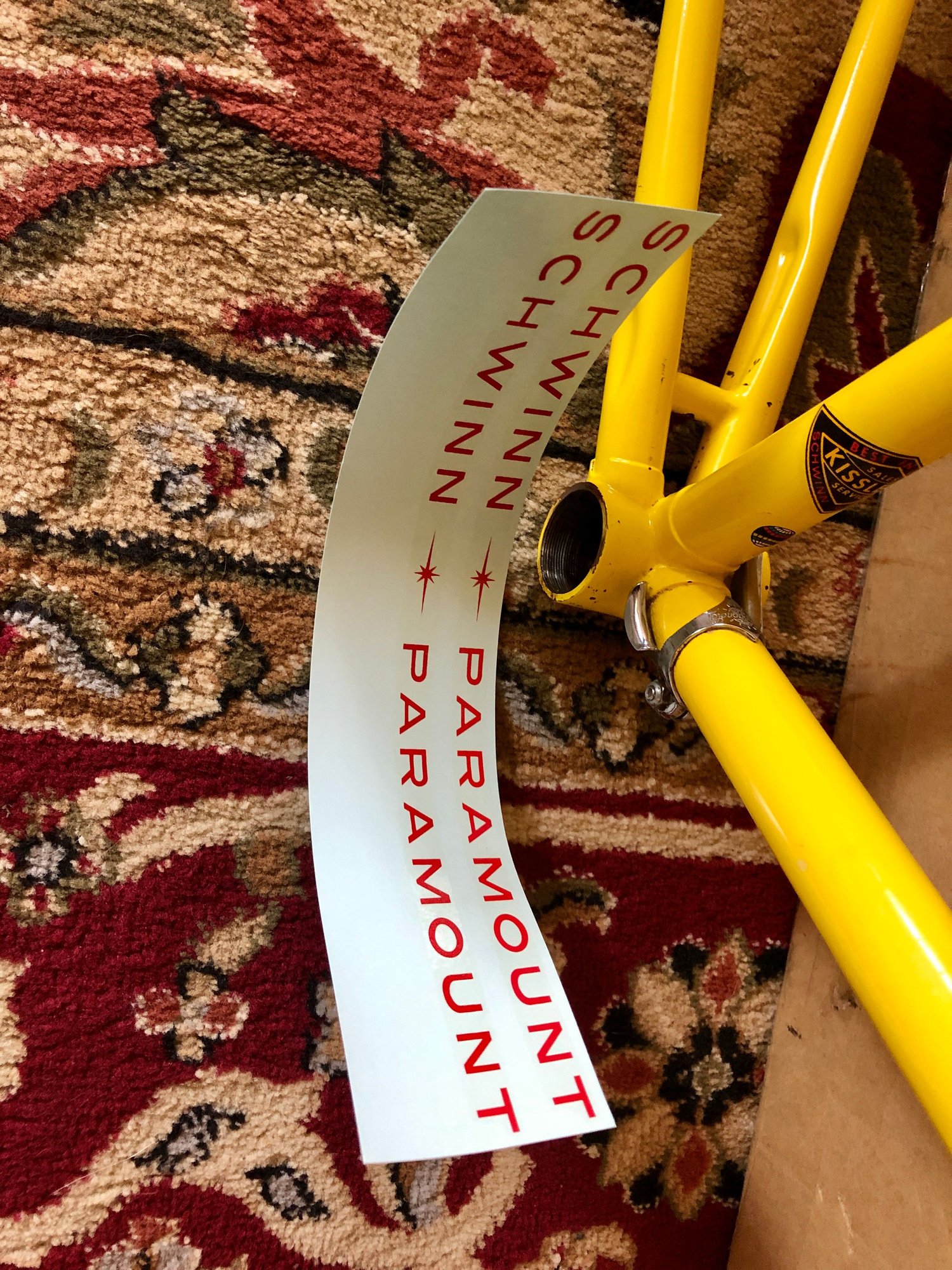

Original paint but missing the Schwinn Paramount decals, so got these from Bicycle Bones on eBay... red pin striping around lugs means red decals, I think.....
Looks like it came from Kissler's in Portland, a really Kool bike shop sticker....
Applied decals....
Voila! Step 1 along this journey accomplished!
Applied decals....

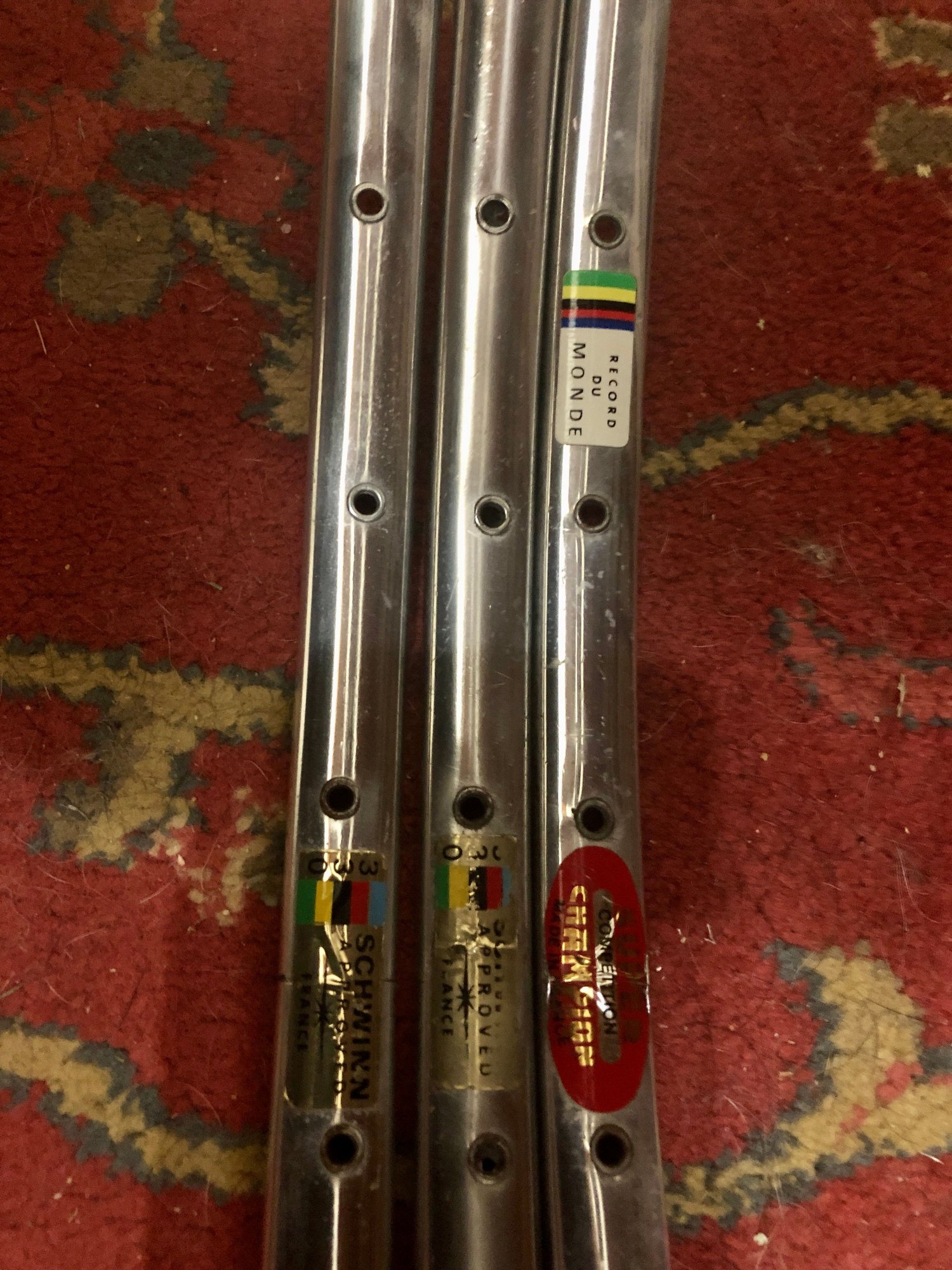

On a related topic, here are the rims I plan to use, which are "Schwinn Approved 330" aka Weinmann tubulars...

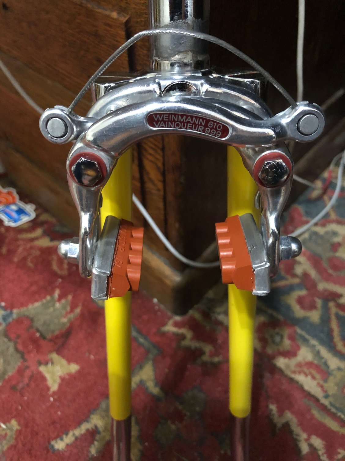

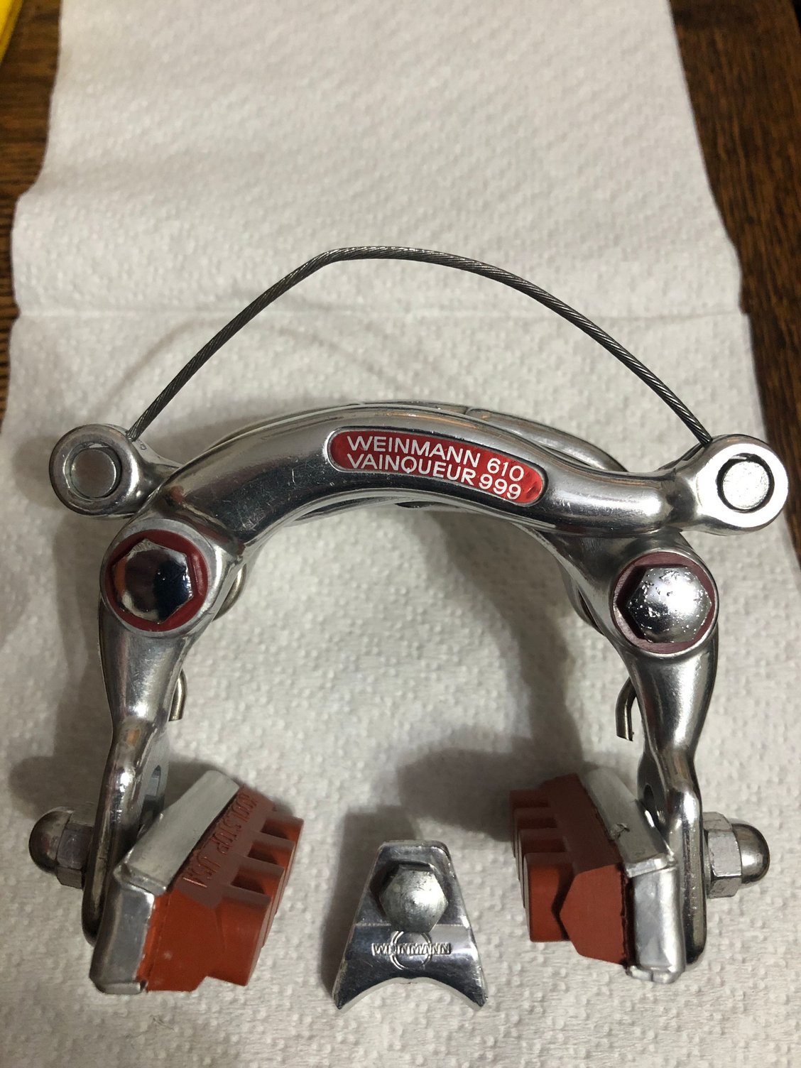

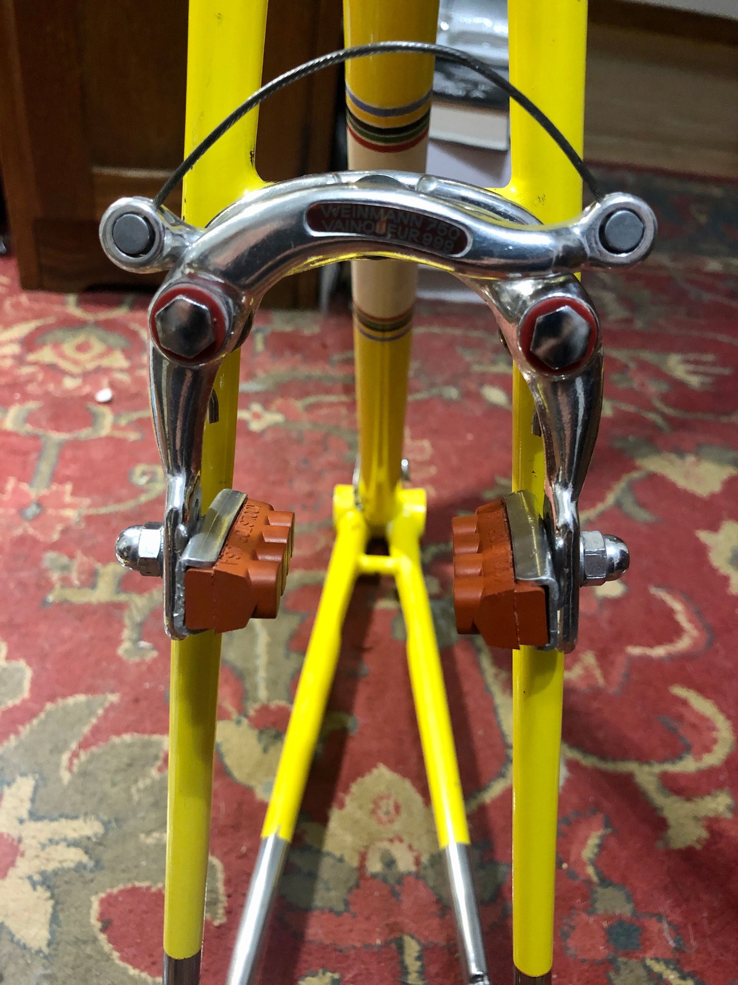

Weinmann 750 rear brake
Measured a Weinmann 750 rear brake today, looks like it will reach a 700c tubular just fine....
Weinmann tear down
Weinmann 610
Weinmann 610 for the front with new Koolstop pads
Weinmann tear down
Weinmann 610

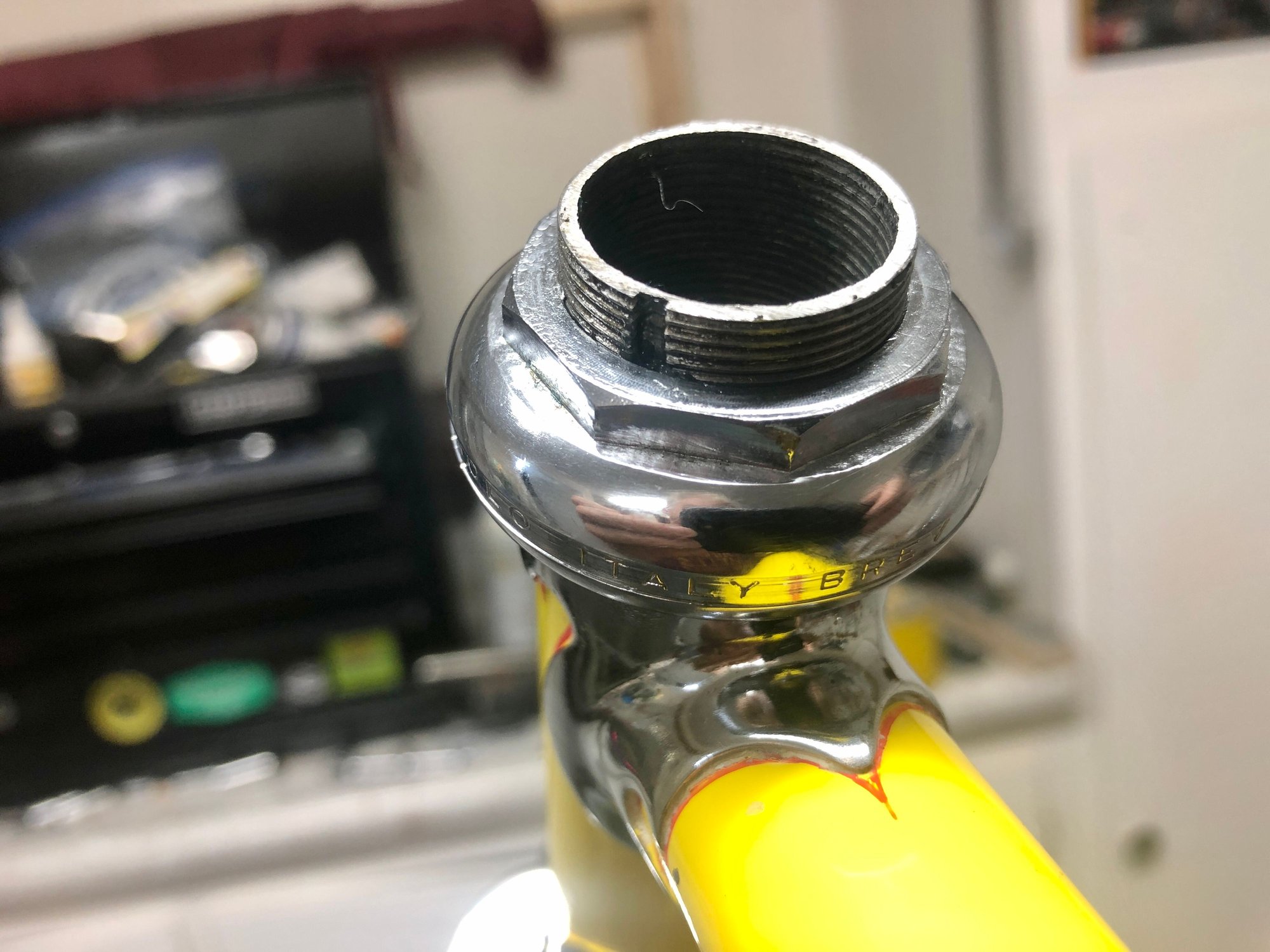

Campy NR headset
Campy NR headset installed..

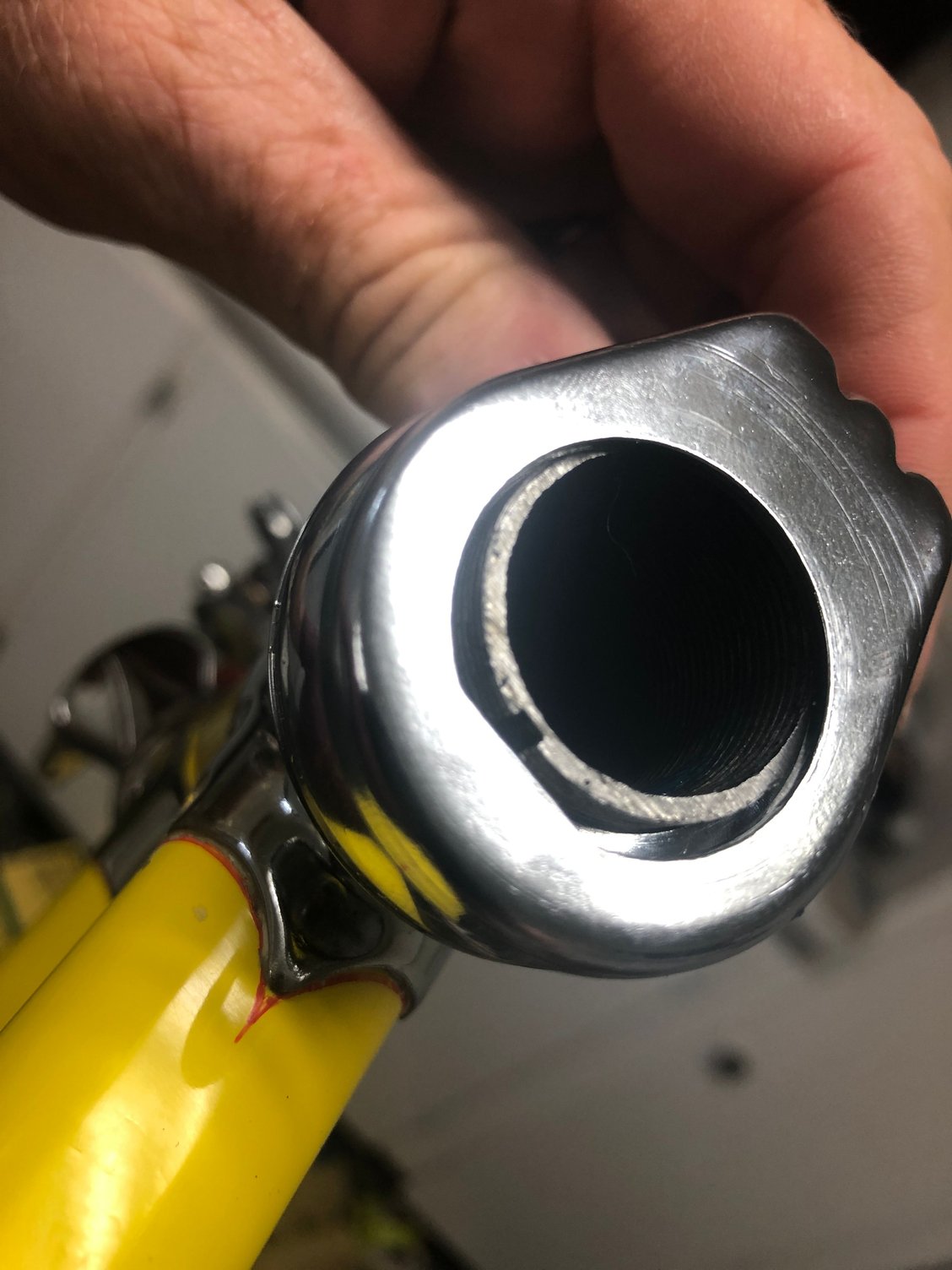

My only issue is that I have a Weinmann front brake hanger that has a flat spot for alignment with a head tube that also has a flat spot. However, I have discovered this Paramount has a slot, so I need a hanger that has such a slot....

Brake hanger compatibility
Head tube has a slot rather than a flat spot
My hanger has a flat spot and I need the type that has the slot.... this one was original to a Motobecane....
Posts: 20,305
Mentioned: 130 Post(s)
Quoted: 3464 Post(s)
Liked 2,827 Times
1,995 Posts
Find correct part
or
file / dremel this one to fit
French Steerers were often filed the way of your Motobecane. Note they are 25.0 -not 25.4mm, depending on the tolerances you may have to remove a bit of material around the circumference.
or

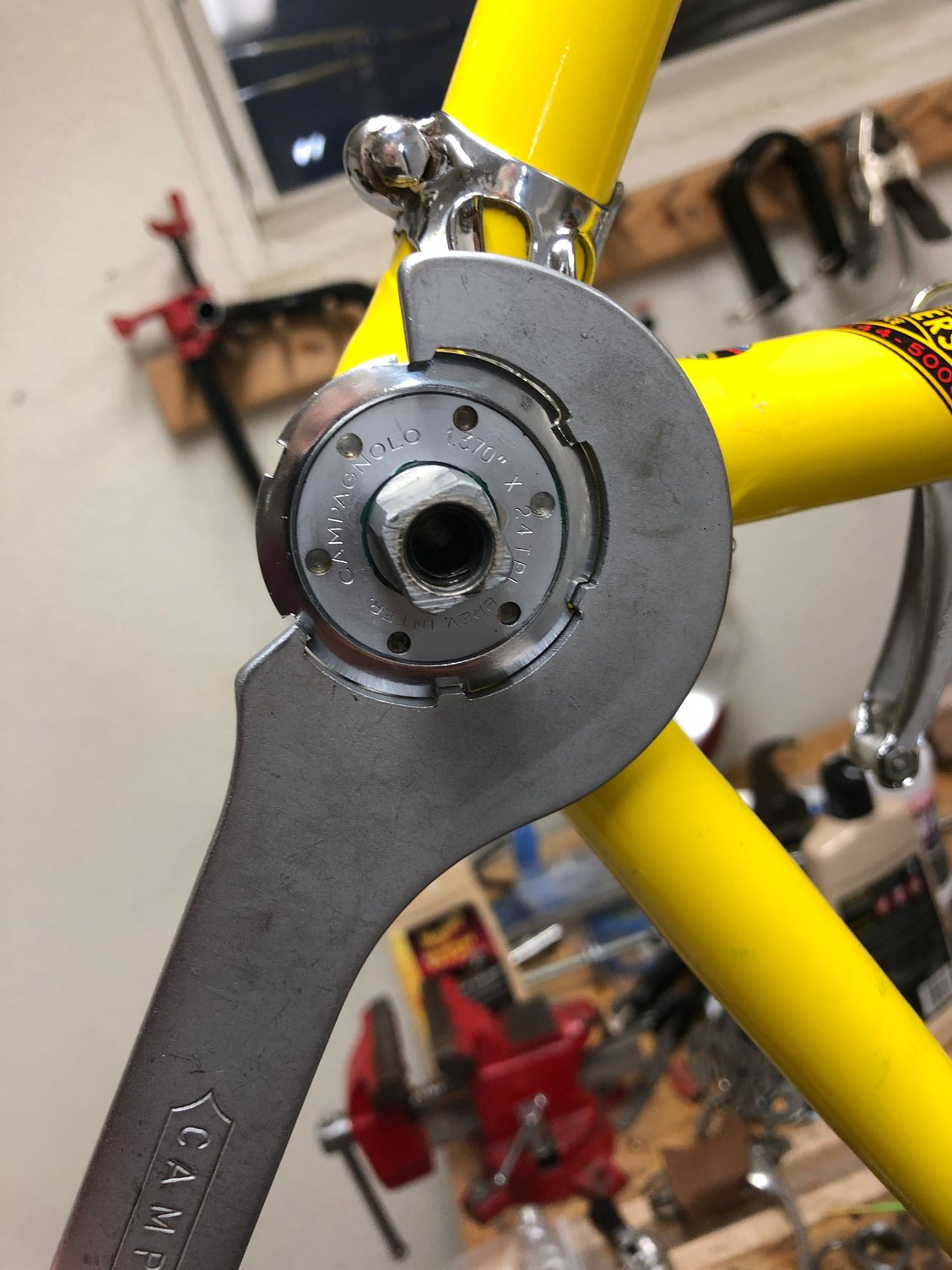

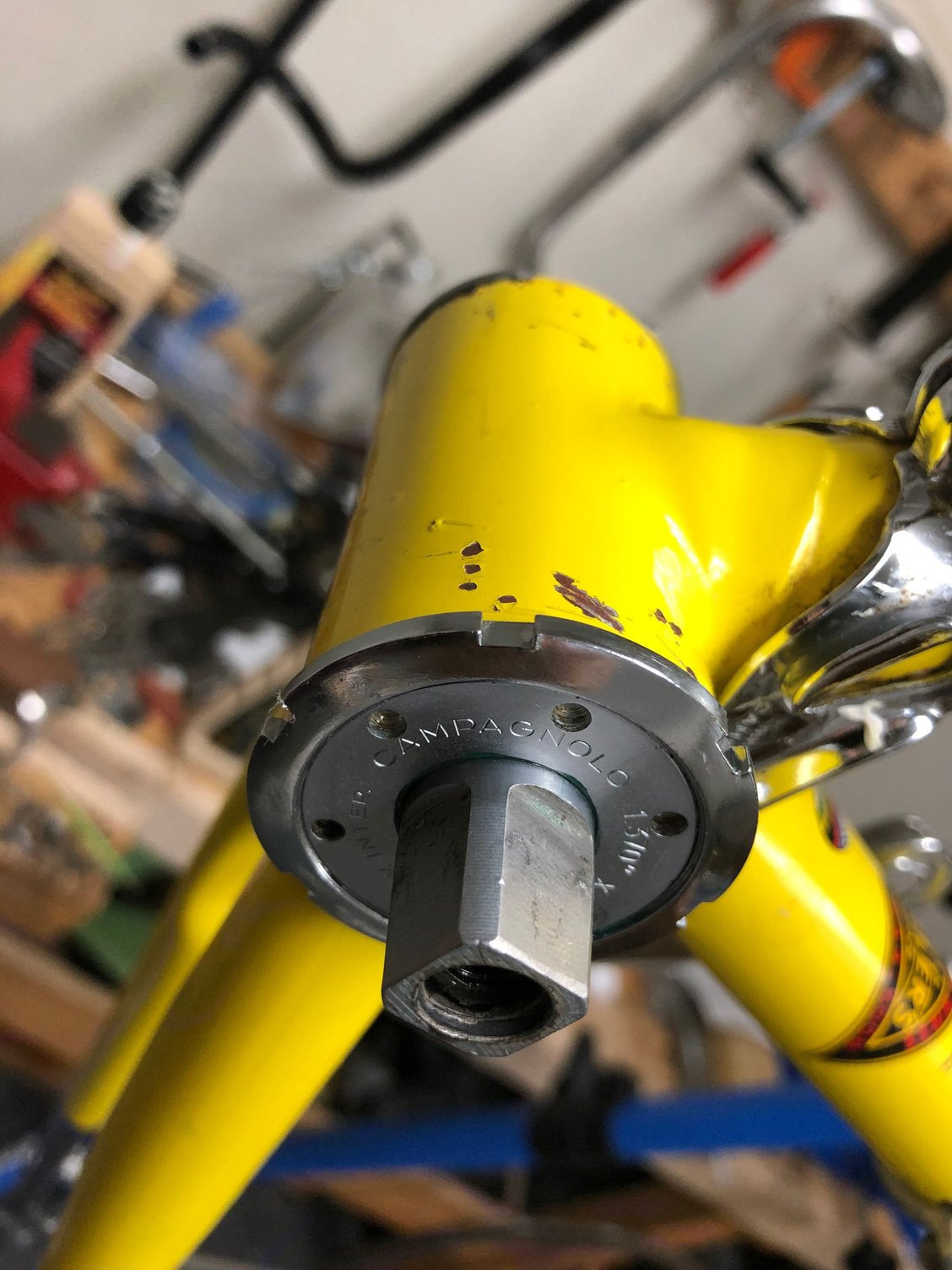

Bottom Bracket
Installed the bottom bracket today....

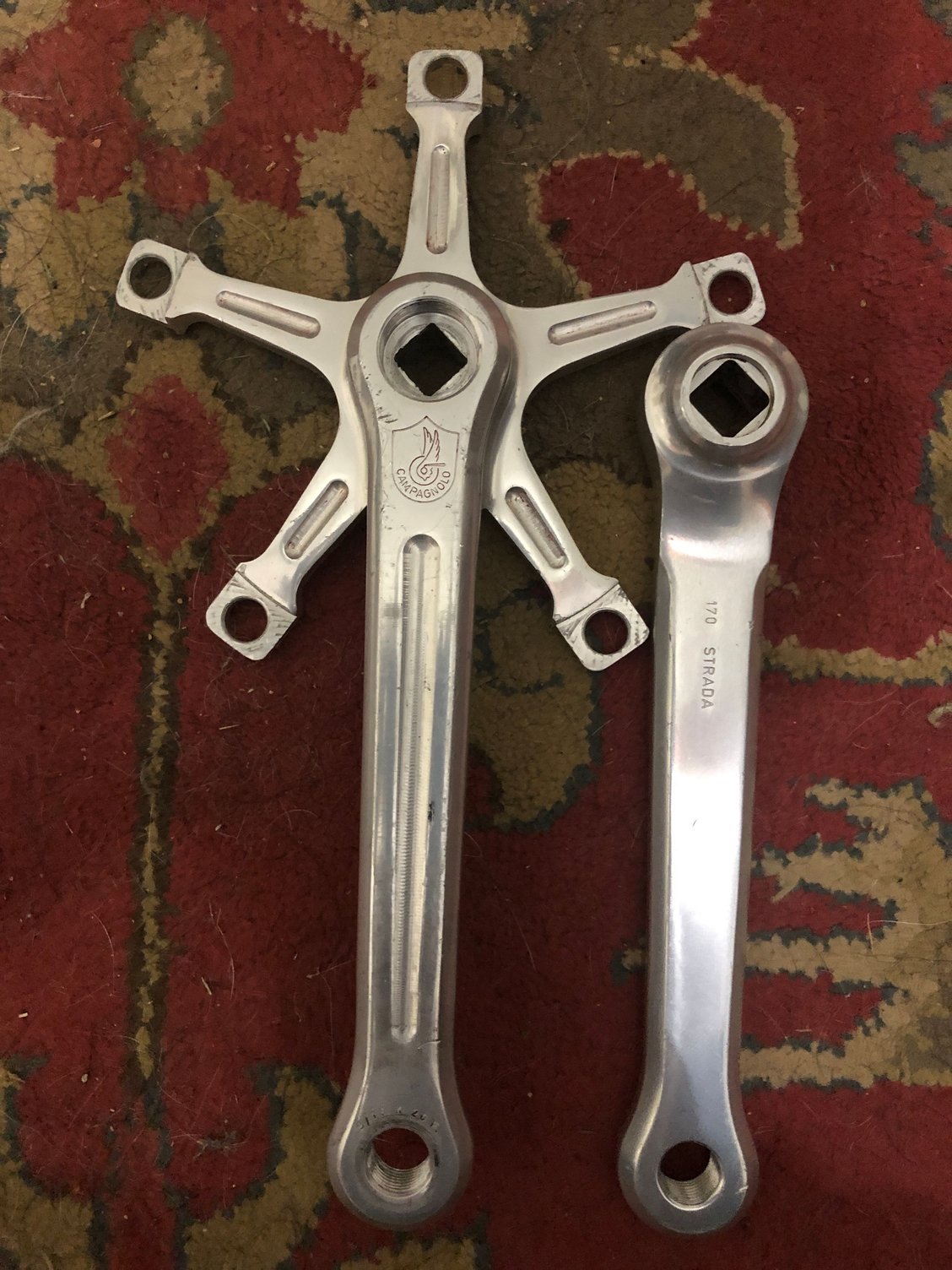

Assembled derailleurs, crank, stem, bars, etc.....

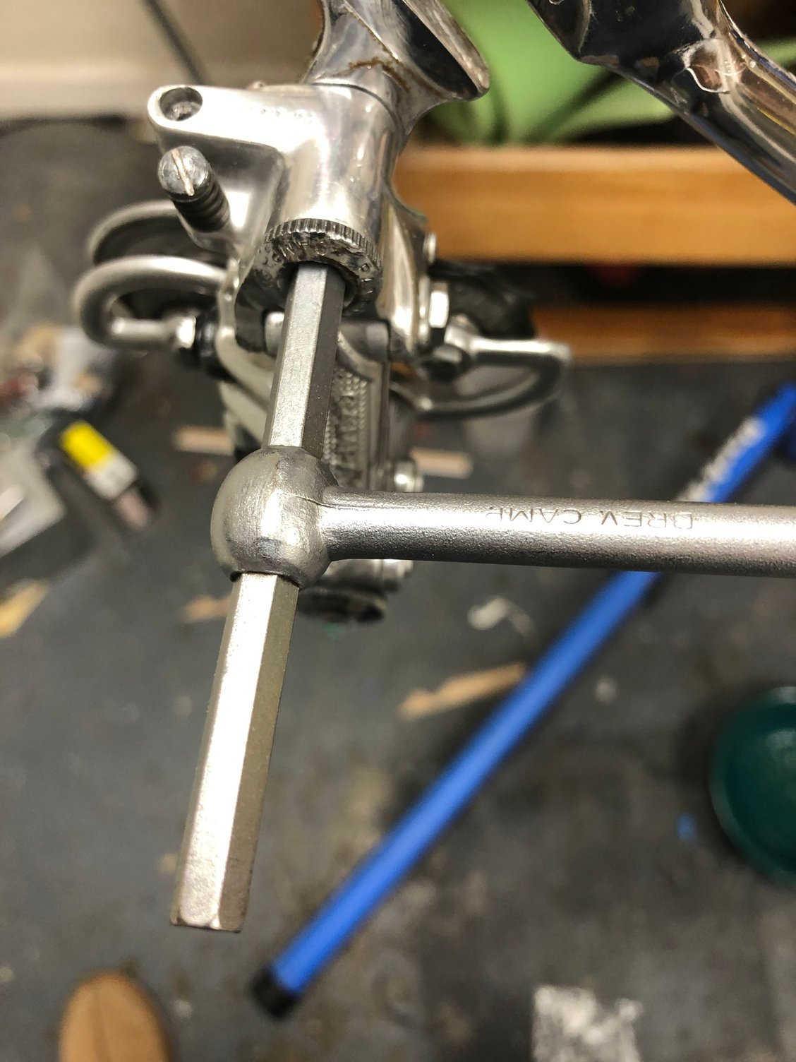

Correct, non-dated Campy crank (appropriate for pre-73)....

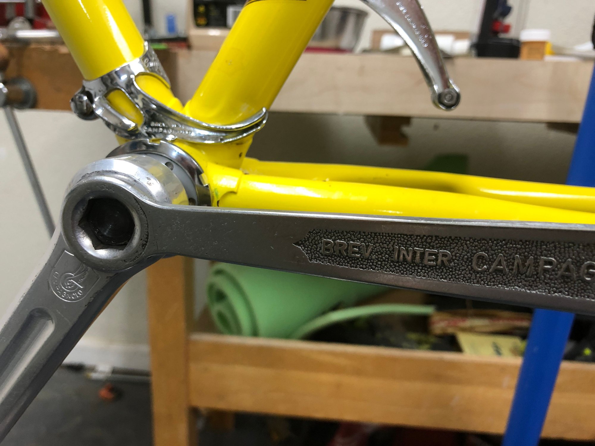

Install using my peanut butter wrench...
Drive side...

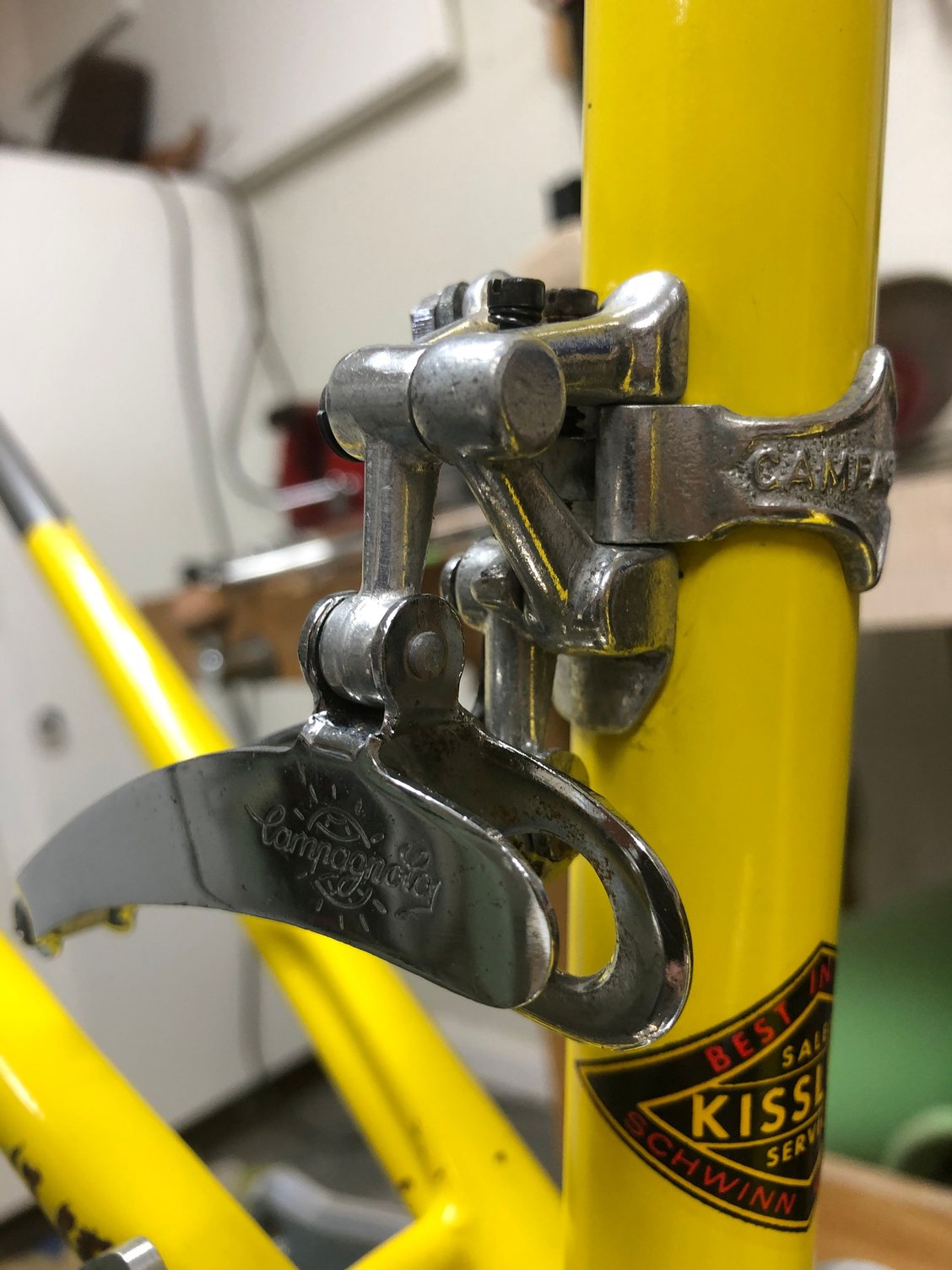

Campy pre-CPSC front derailleur...

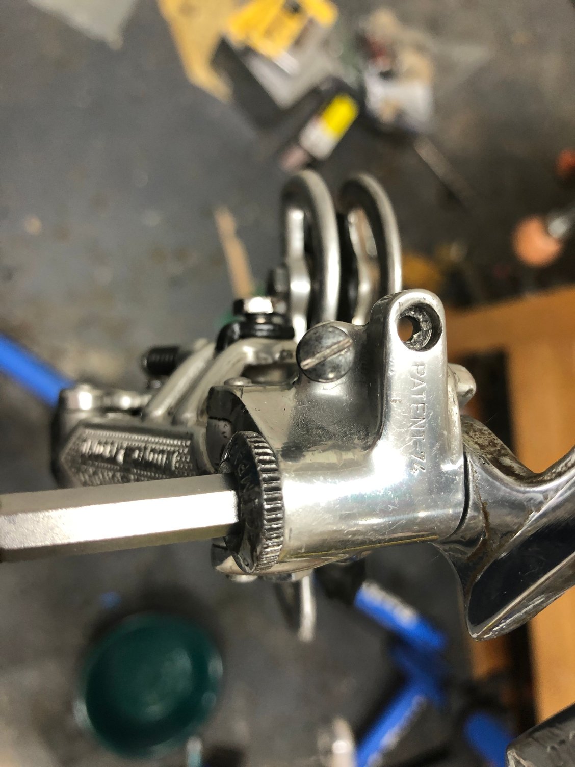

Install NR rear derailleur, using my t-wrench...
I don't have a PAT-71 rear, but looking for one.... meantime, will use the PAT 74 I had on hand....

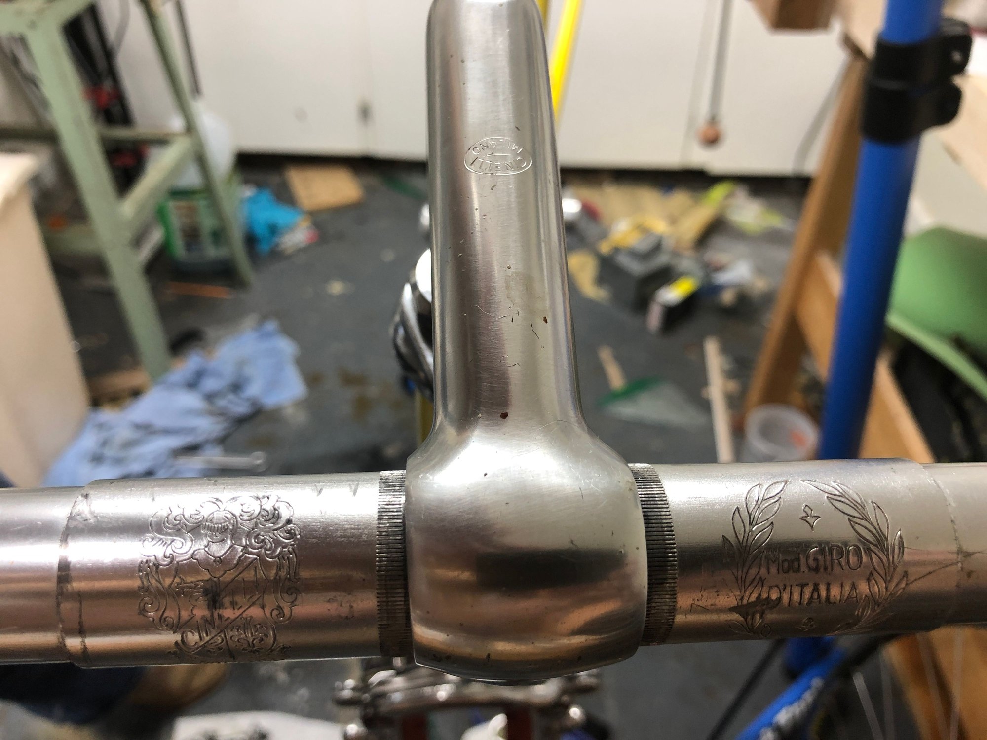

Cinelli 1A stem with crest Model 64 Giro bars...
Old logo Cinelli 1A stem, with a 6mm Allen fitting, not sure if a '71 would have had the old 7mm...
Drive side...

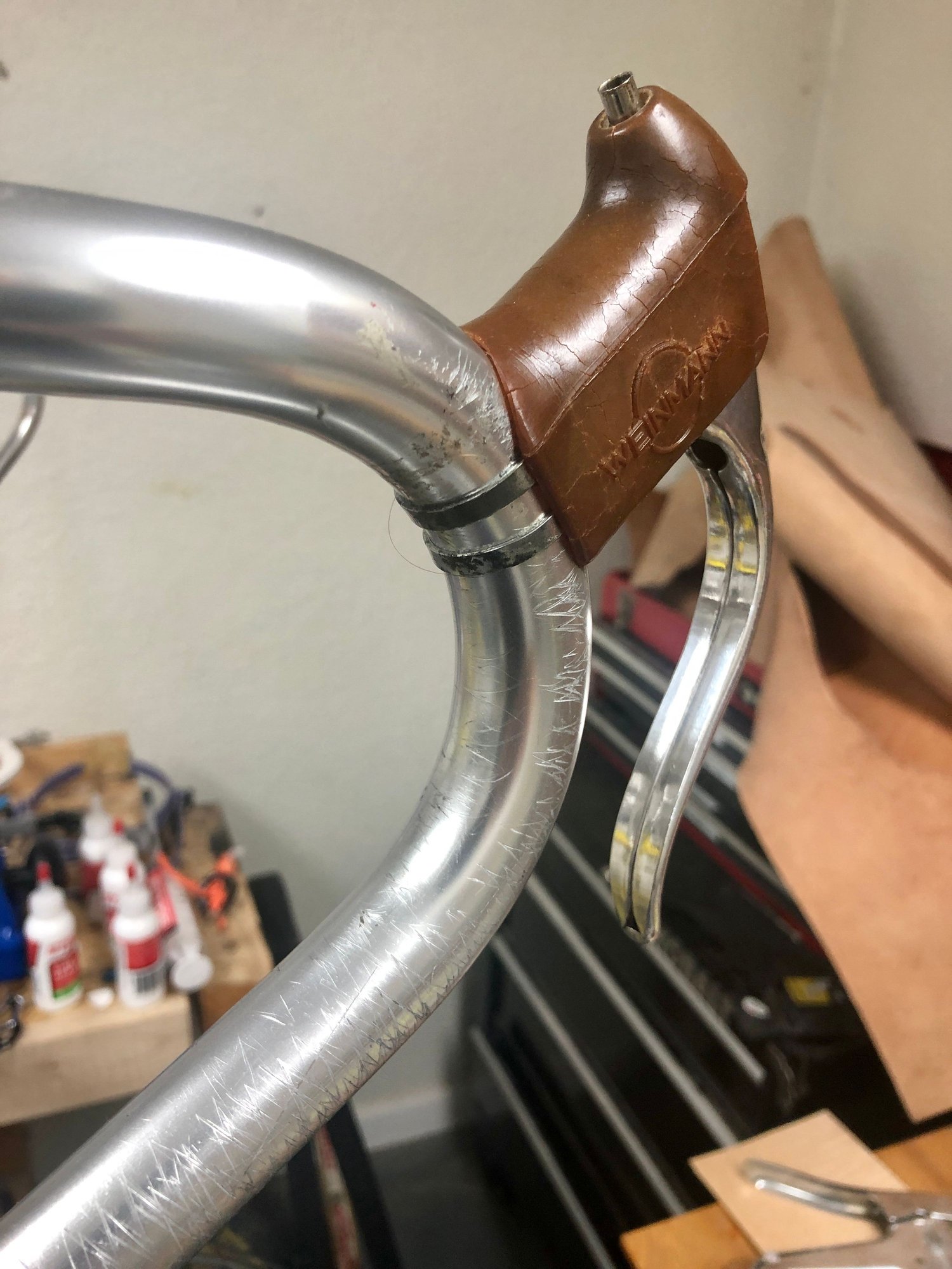

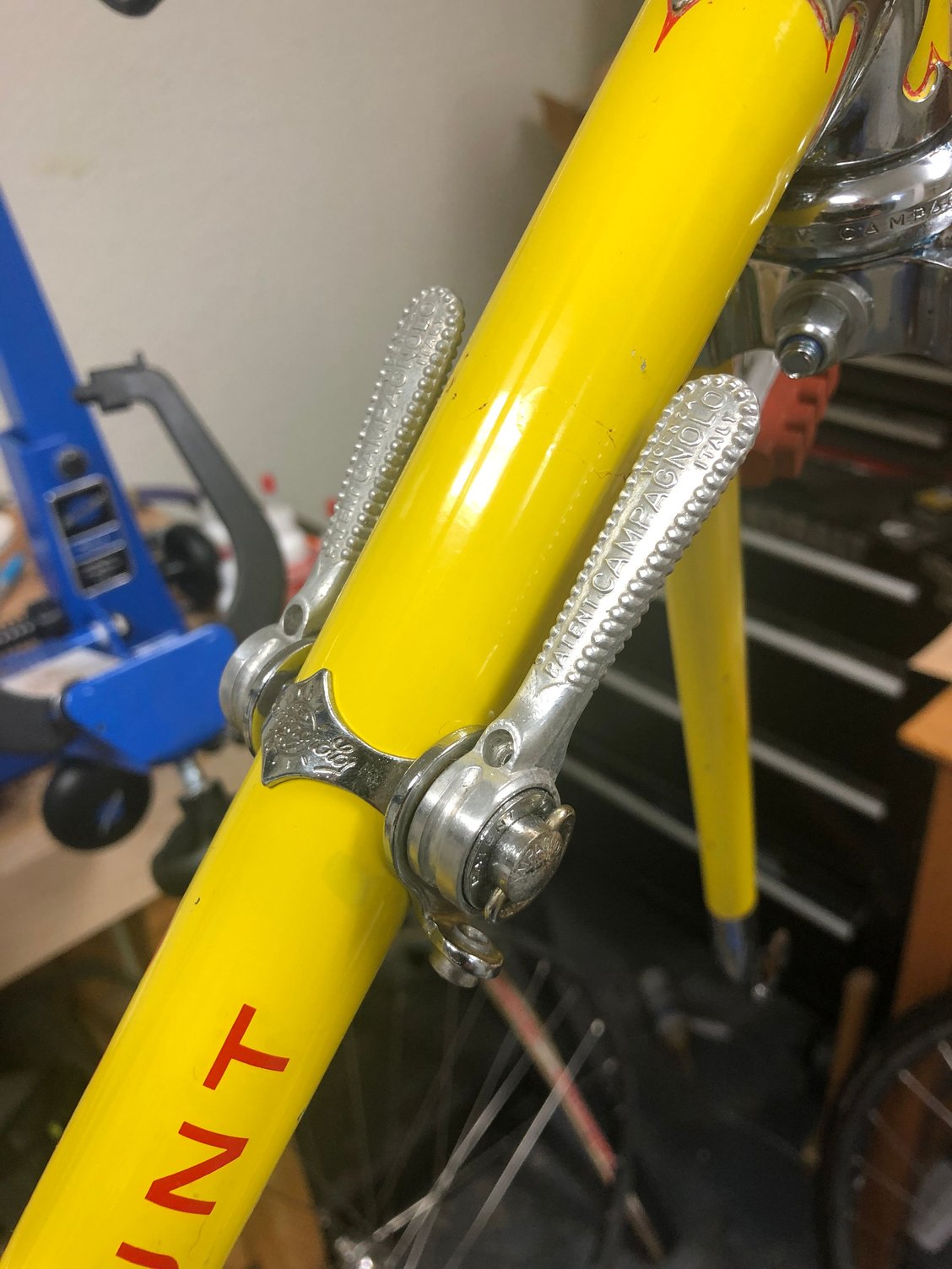

Brakes, saddle, shifters, working toward wheels...
Campy NR shift levers....
Weinmann center pull brake levers...
Yes, they are a bit crackly and worse for wear, but by comparison pretty intact....
Does anyone reproduce these with the Weinmann logo? I have some of the Cane Creek ones, but they're not quite accurate

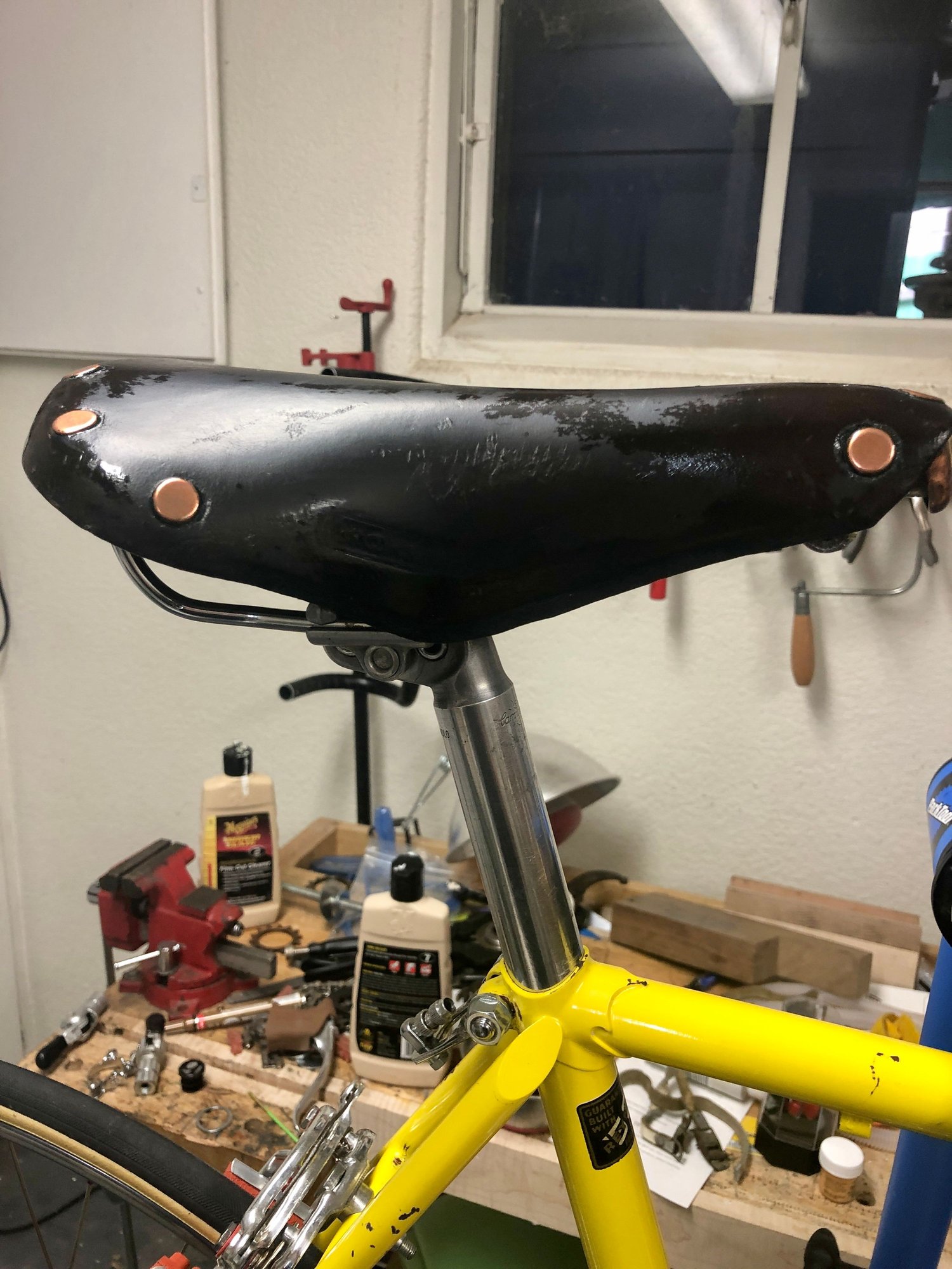

Brooks Pro with a fresh coat of Proofide....
I will build the wheels with high flange Campy hubs, plus a set of "Schwinn Approved 330" rims. One has never been laced, the other had quite a few miles on it, but an hour or so with 0000 steel wool and Simichrome got most of the gunk off...
What I have learned is that in '71 the tubular rims for the P-13-9 stock were generally either Weinmann hollow or Weinmann wood-filled. They did not go to the Schwinn Approved until 1973 or so, so these are not exactly accurate, though in my opinion highly appropriate. Another interesting thing is the Schwinn Approved are actually Super Champions, rebadged. I think these in particular were based on the SC Record du Monde, which are 330s. I have also seen Schwinn Approved 260s....
