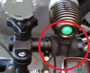

fwiw, I save used grips. if turned inside out, they can be used on handlebar extender extension accessories to increase the diameter so that a headlamp which is attached w/ an elastic is tighter & won't move when hitting bumps in the road
not all lights need it because they have adjustable collars, but sometimes the extra squish is helpful anyway, when making the final adjustment
experimented w/ two similar light heads the other night. misplaced the elastic for the one on the right & had to buy some after-market. but w/o the extra diameter of an old grip, it kept shifting position during my ride. pretty annoying
