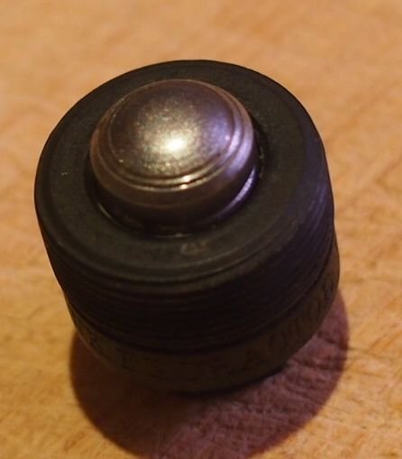

Got one of these?
Brand is Lifu, has a little chrome button with an 8mm hole drilled partway into the backside, so it covers the end of the crank bolt that you just undid and screwed into the end of the extractor.
The hex is the same size as the crank bolt so the same spanner fits both, and it weighs 48g, great for touring.

Makes a good argument for cleaning and carefully inspecting them before slamming a tool in.
And perhaps the raison d'être for dust caps?
