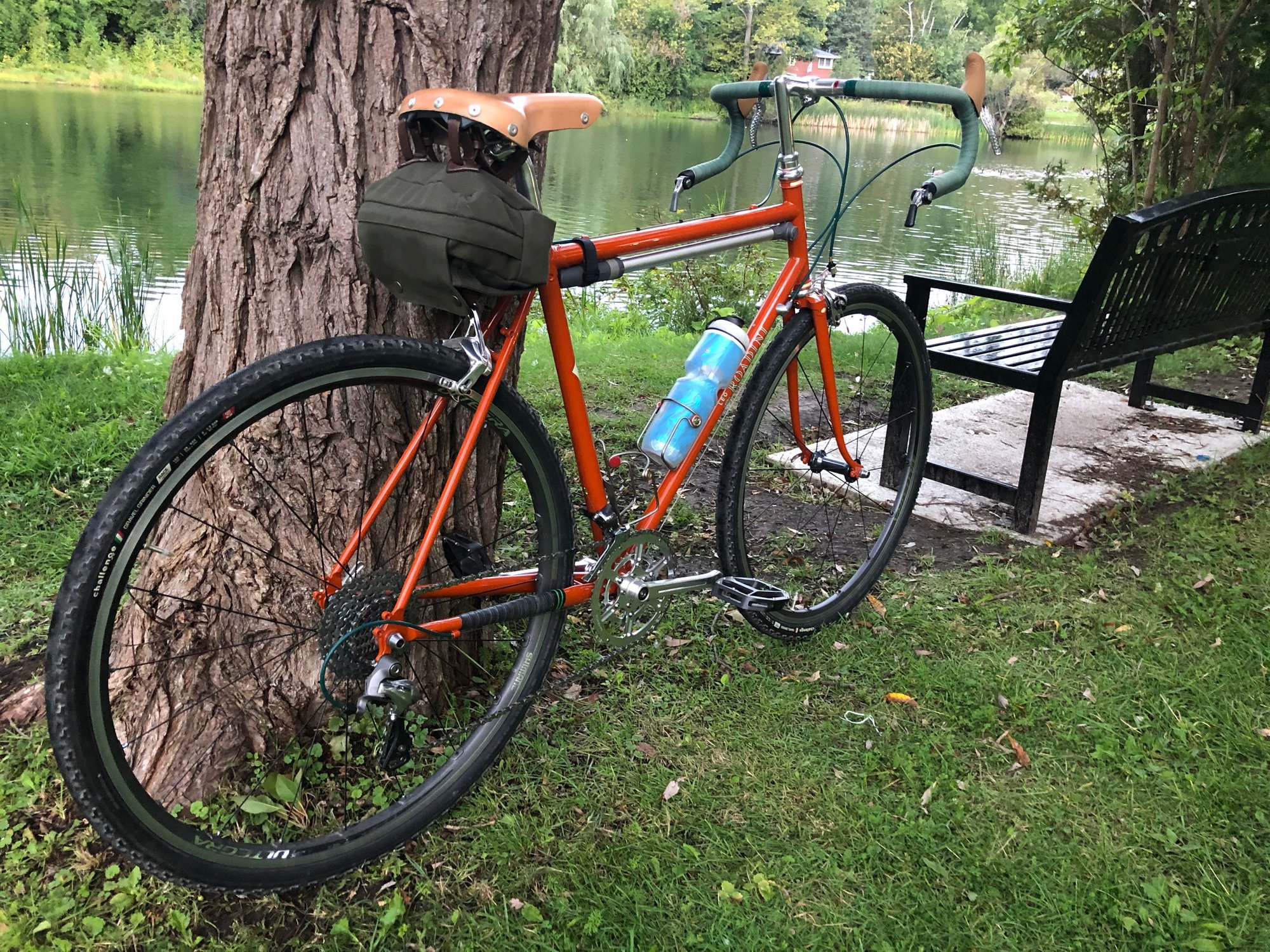

Couple more shots in different light. And yes, I do prefer colored electrical vinyl tape finish to twine I like to change things up often and it is easier with tape.
One thing I completely forgot to do - chainstay protector. I did the first wrap with old tube for draft build and planned to re-do it after test build, wrap it thinner and finish with matching bar tape on top + shellac. But alas - will do it when time comes to replace the cables.

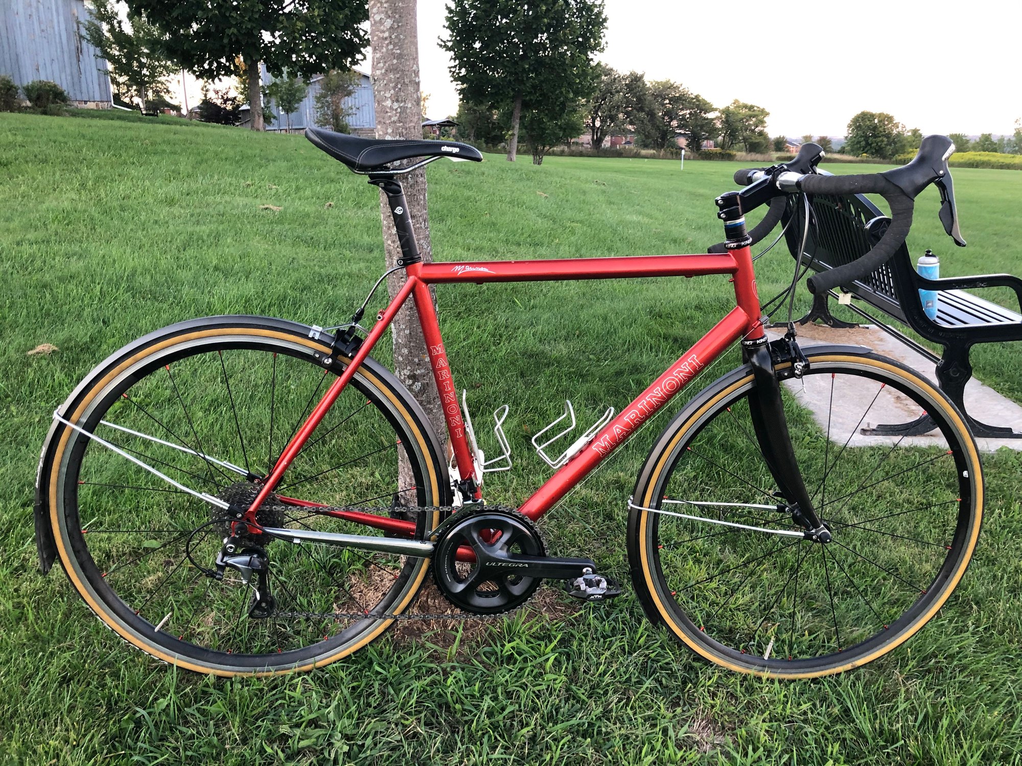

It is 2006 Marinoni Ciclo with 2x11 mix of Ultegra and 105. I built it originally for early spring/late fall rainy weather when I usually stick to good pavement but I do ride it often year round and fenders don't affect the ride.
You can also check my Centurion thread for more traditional fendered look. So if Roadini will end up getting fendered - it will be a nice looking set.

Quoting again as you got me thinking if I can show you one of my bikes with fenders. There are some absolutely stunning fendered builds on the internet but here is one of mine. IMHO it goes very nice with the bike. My only dislike about this specific fender set is rear mount to the brake bridge. I understand why they did it this way (to maximize clearance) but wish it was a bit more elegant.

The ones on Roadini are OK, good tires, 700x36 but lower TPI count and it feels even when mounting them, a bit more robust feel to sidewall compared to 700x30, 260TPI. I have several other tires to try on it longterm but happy with them for now.
I want to build another set of wheels first. Really like the current Ultegras but woud like boxed rim with eyelets, 36H, probably NOS Mavic Open Pro laced to some shiny hubs (WI or Hope, may be older Shimano Ultegra or DA).

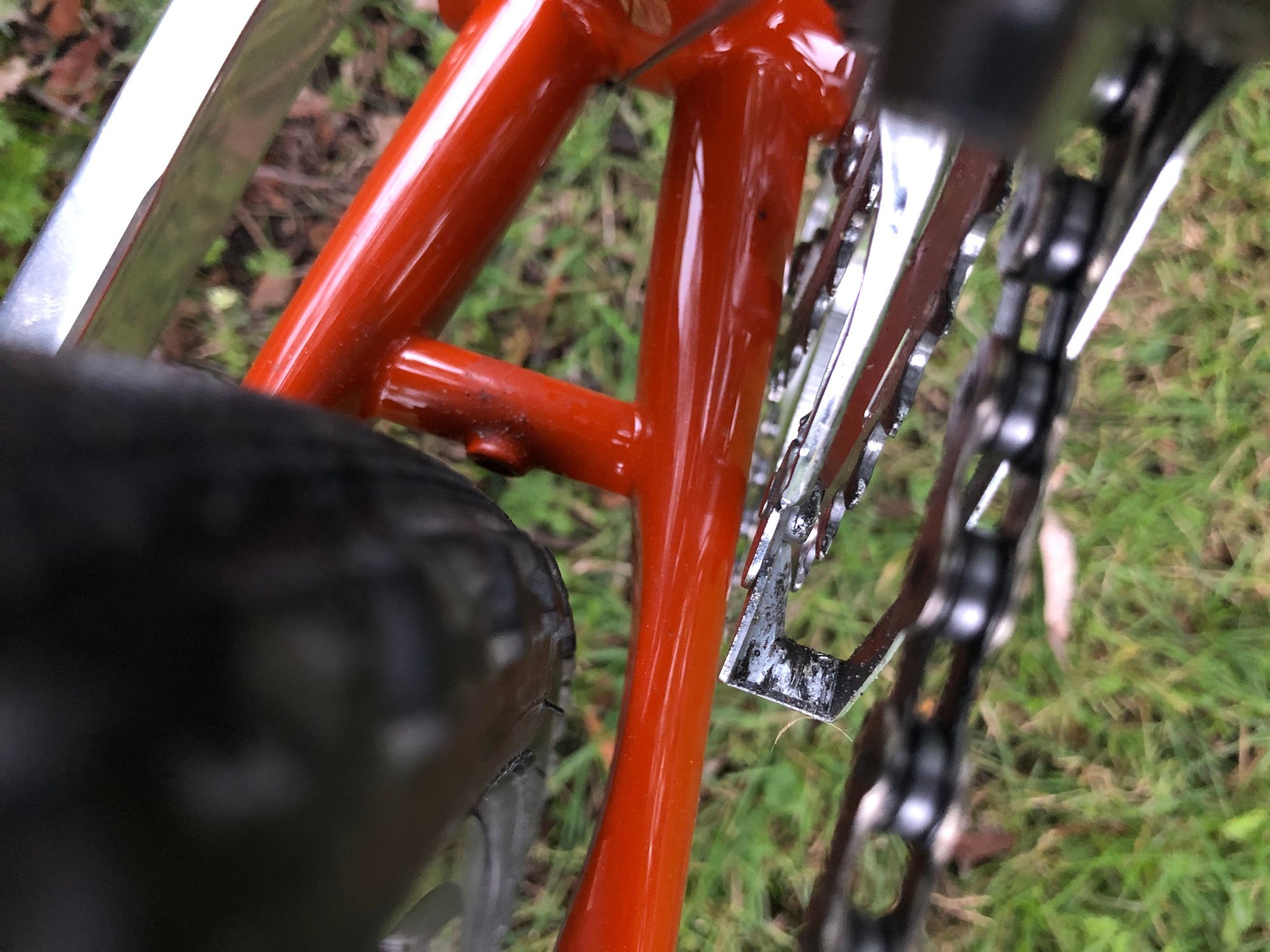

Couple of shots with different tires from this morning. I decided on no fenders for now so figured might as well try fatter tires. In the pics - Challenge Gravel Grinder Pro, 700x38, Race Series, 120TPI. I pumped them to ~70psi first to set the bead and check the fit. On Ultegra wheels they mount at just under 38mm sidewall to sidewall + knobs. For the ride and the pictures you see = front is at ~40 and rear is at around 45, just around 37 measured at casing.
So glad I went with TRP calipers with help of Mike Varley's post - frame got tons of clearance, you'd be limited by your brakes.
Chainstay
Seatstay and brake bridge
Fork - front view
Fork - from the rear
Chainstay
Fork - front view
