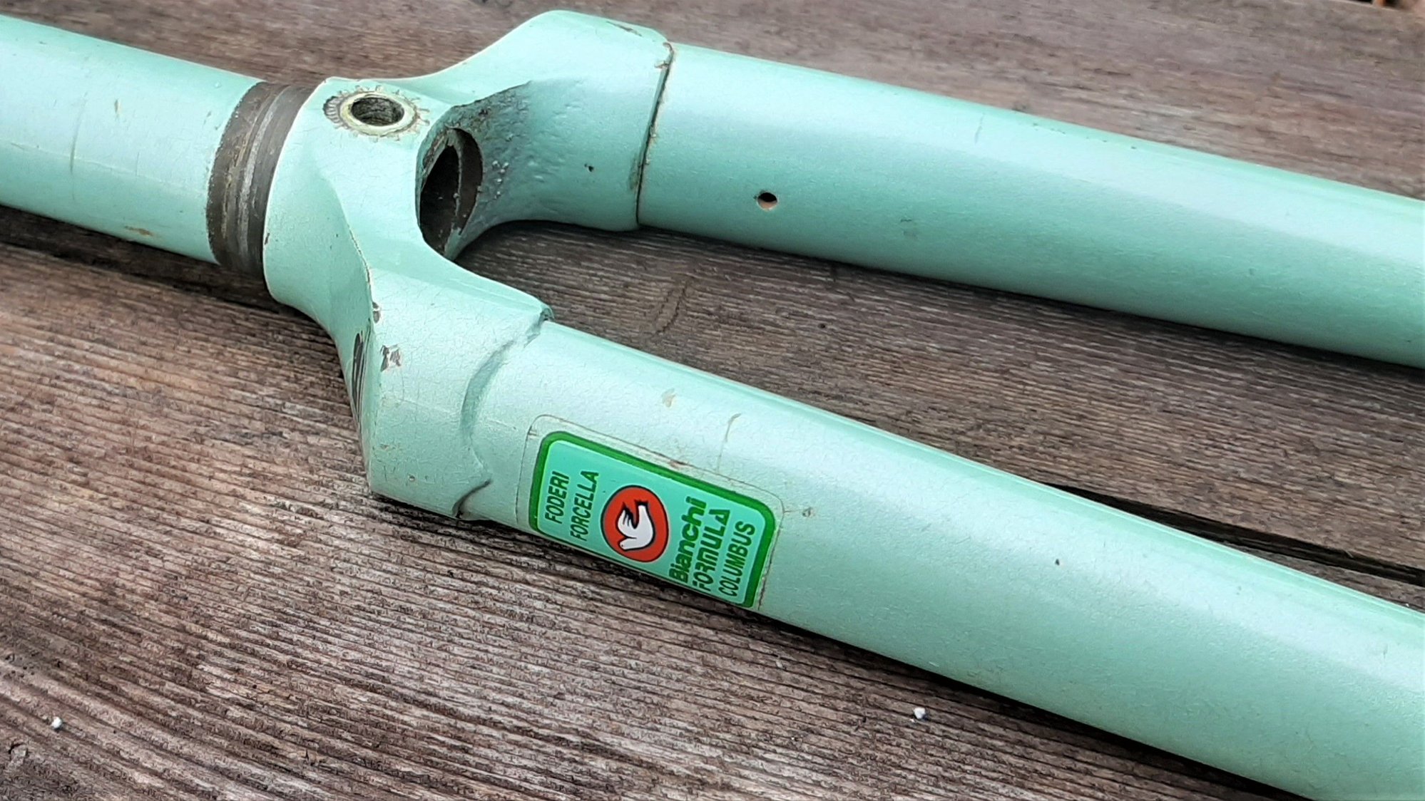

No matter what I am shipping, I usually cut a box to fit the item inside. Handlebars are pricey because the length + girth elevates postal costs and FedEx or Puralator are out of the question. Forks can also be pricey, and the post office wanted close to $70.00 CND to send this set to Australia (I live in Canada usually)...

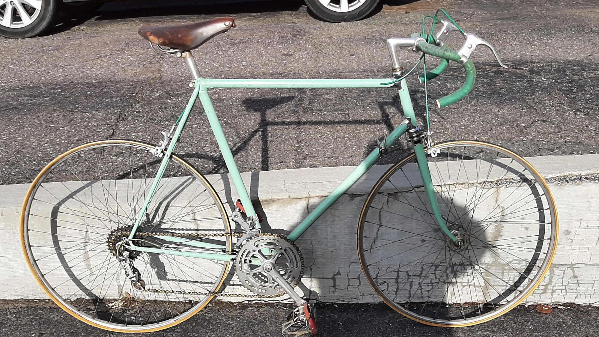

I managed to get this Bianchi into a box 40" long x 29" high x 9" wide...
To get the bike into that box meant removing wheels, handlebar/stem, saddle/seat post and drive side crank. Cost to ship 1000 miles (approx) was $127.00 CND. Had I not removed the rear wheel, the box would have been 56" long, jumping the shipping cost to $214.00 CND and I would have been forced to use FedEx or Puralator because the box size would exceed postal limits.
In short, make the box as small as you can to reduce shipping cost.
