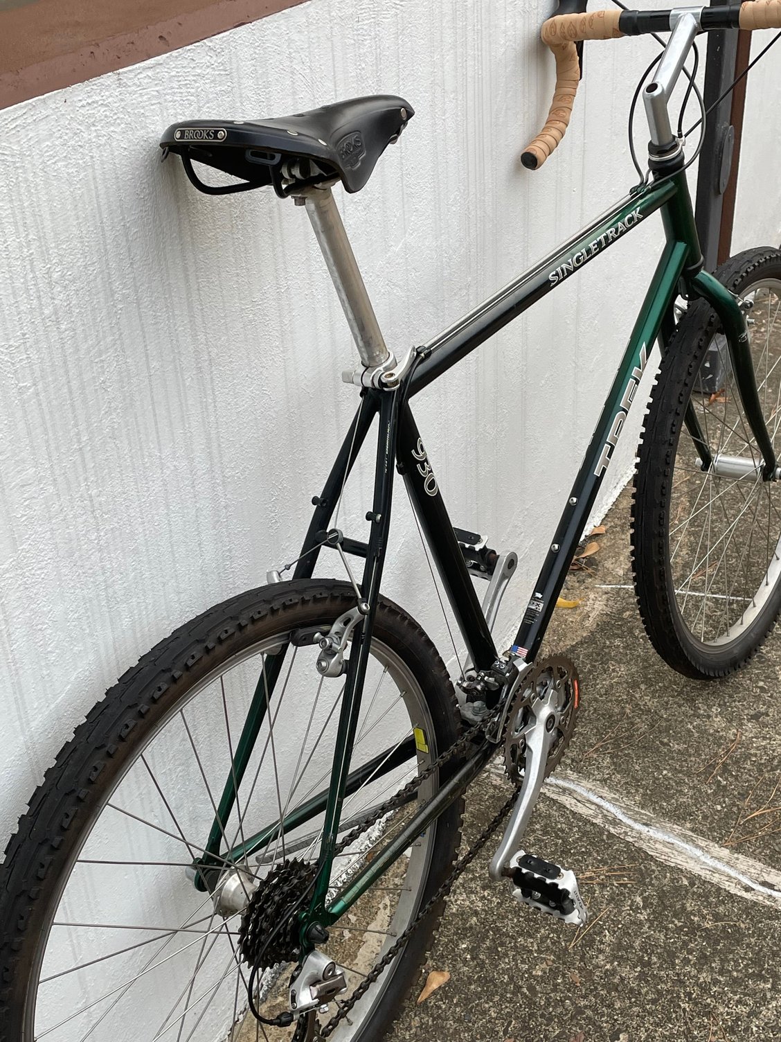

Posts: 35
Bikes: 3 Frankenbikes (Stumpjumper, Karakoram, Trek 930), Fuso, Tarmac Pro, '72 Fuji Finest, Soma Saga, El Diente, Cannondale tandem, 2 mountain bikes, more...
Quoted: 9 Post(s)
ah! thanks for clarifying unfortunately, i have no experience with 11 or 12 spd technology. in short, i can't advise you the derailleur. sorry. anything before that, i can help..lol. someone here will be able to, though. you might try over in the bicycle mechanics subforum, too. the folks that frequent there deal mostly with modern equipment
Not entirely clear on your intent but some things to consider... (food for thought)
The 1x12 derailleur will work as a friction derailleur BUT shifting between more than 7 or 8 cogs requires a lot of precision. So a 1x12 friction drivetrain would require accurate shifting and trimming.
The freehub body for a 12 speed cassette is much wider than 8 speed which is wider than 7 speed. SRAM 12 speed cassettes require the XR freehub body which would not fit on any of the vintage hubs. Shimano 11 speed cassettes have the same splines as 7 speed so maybe one could fit 9 or 10 of the 11 speed cogs onto a 7 speed freehub???
12 speed chainrings & cogs are MUCH narrower than the 7 speed chainrings & cogs so the 12spd chains are much narrower. The derailleur's jockey wheels are designed to match the chain width. So putting a 12
The pull ration of 12 speed derailleurs is incompatible with 7 speed shifters - indexing would not work.
NocoRider is offline

Ready to ride. 1996 Trek Singletrack 930
With 3x7 microshift levers, bars and new Cinelli bar tape. Total budget on this one came in at $245 which includes $80 worth of labor at the LBS not including the brooks saddle.
