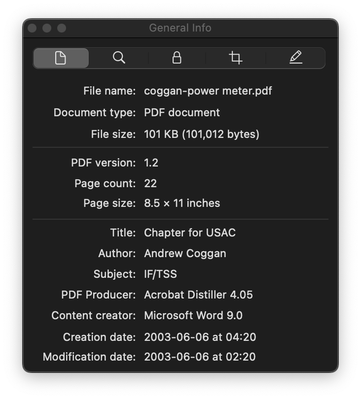

Old 09-17-22, 10:47 AM
RChung
Perceptual Dullard
Join Date: Sep 2009
Posts: 1,992
Quoted: 628 Post(s)
Liked 662 Times in 272 Posts
Originally Posted by terrymorse View Post
Moreover, since HR responds relatively slowly (half-life = ~30 s) to changes in exercise intensity, HR monitoring cannot be used to regulate the intensity of shorter efforts, such as brief intervals aimed at enhancing anaerobic capacity or sprints designed to increase neuromuscular power."
Andrew R. Coggan, Ph.D., Training and racing using a power meter: an introduction, 25 March 2003 (revised)
Andy's talking about something related but slightly different: an initial "impulse" in power has a HR response that's quite quick but it has a HR response that lasts a long(ish) time. You can see that if you look at power and HR traces: HR jumps up faster than it falls (i.e., the response is asymmetric).
As a historical oddity, it's kind of amusing whenever I see a reference to that March 2003 version. Not many people had access to pdf-generating software in 2003, so Andy sent me the original Word document and I converted it. Like many Word docs, I had to fiddle with a couple of the graphics to make them fit. I still have Andy's original .doc file.
RChung is offline
Likes For RChung:

Old 09-17-22, 08:01 PM
terrymorse
climber has-been
terrymorse's Avatar
Location: Palo Alto, CA
Posts: 4,852
Bikes: Scott Addict R1
Quoted: 1428 Post(s)
Liked 1,295 Times in 691 Posts
I remember receiving the PDF when Andy was asking for comments.
The amusing meta info from that March 2003 document (Distiller 4, Word 9):
Ride, Rest, Repeat
terrymorse is offline
Likes For terrymorse:

Old 09-18-22, 07:11 AM
RChung
Perceptual Dullard
Join Date: Sep 2009
Posts: 1,992
Quoted: 628 Post(s)
There's a story about that, too. March 2003 was a pretty wild time: we'd invaded Iraq. In early June I was producing a pdf of one of my own papers when it occurred to me to check the metadata for the pdf I'd produced from Andy's .doc. It still had my default metadata, so I had to re-generate that pdf, and I gave it those fields. As yet another aside, he used North American month-day-year date format. That "Revised 25 March 2003" on the front page was added by me to let people know the June re-generation was the same content as the previous version, it just had different metadata.
RChung is offline
Likes For RChung:
