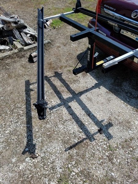

Was just on my way home on the xpressway and had my bike on a hitch-mounted carrier. As I was rounding a corner I look into the rear view mirror only to see my bike flop backwards and disappear.
..wtf..
..at least I didn't see it under the car behind me, so there's a plus I guess. I was in the left lane on a right-turning interchange. Only about a 3/4-sized shoulder...perfect. I pulled off the road tight to the wall and sort of climbed out of the car. Around back I see my bike hanging off the rack by the rear wheel tray-strap. It looked like it was sliding down the road on the right shifter.
Cars are blowing by me about 3-4 feet away at 70ish mph and they are all a bit surprised to see me as they come around the bend. As I released the rear tire from the rack-tray strap I'm noticing the multiple layers of rubber and paint the concrete wall next to my car...perfect. I'm in place where human beings don't usually stand. Scotty..beam me up..
I put the bike on the second tray of the bike carrier, climbed back into my car, and headed for an off-ramp.
Looks like the bolt that held the fork-mount to the aluminum rail on the bike carrier failed. The fork-mount remained connected to the bike/fork. Fortunately the rear tray-mount held onto the carrier frame as did the strap holding the rear wheel to the tray. The entire tray with my bike attached was hanging (upside-down) in space held to the car-carrier by the rear tray mount...my nice, perfectly functioning Ultegra shifter supported the front of the bike as it dragged on the pavement behind me at 65-70mph..perfect.
The bike frame & fork seem to be fine. The shifter also seems to work perfectly. The bars..also look ok. No idea if I can source-replace just the shifter hood...never faced that question before.
Word to the wise...check your bike carrier hardware and replace any fasteners that are old...even bad ones may look good. Nuts and bolts are cheap..even SS ones. Bikes cost the real money. I got lucky.
Now to put humpty-dumpty back together. I may or may not replace the bike carrier. Depends if I can find the right parts. As for the shifter(s). This is my favorite bike and it and the shifters work(worked) perfectly. If I can find a set of shifter-boots I may put up with the remaining shifter appearance..though in reality, probably not. The bike is scheduled for a repaint soon and I'll look around for some new(to me) (3x9) shifters ...$ouch.
Given what could have happened..I got off light.

I'm curious: how old was the rack, has it been exposed to the weather a lot, etc...?
That sort of info might be of use to some of us in assessing when to replace our own racks.
Actual age of the rack..not sure as I bought it used. As a guess..10-15 years? Has been working fine. No visible corrosion. I have replacement straps for the rear tire-tray, but haven't needed them yet. Fork mounts are solid and function well. It's outside most of the summer being used. Inside in the winter. A heads-up for people to evaluate their own racks is why I made this post initially. Had I updated the fastening hardware(as I'll be doing now) before this happened, it wouldn't have happened. I have seen replacement tray/fork mounts on the web that have a more substantial bolt in place of the one that sheared on my rack. Thule may have been aware the original bolt was "light". I haven't decided yet whether this rack will continue (for me) as I've been focusing on the shifter-hood. In the grand scheme, the damage is minor. That said..I value keeping older bikes/equipment maintained and in good use. Looking at the shifter now..I'm bummed. I rode the bike the day before this happened and was thinking as I rode..the bike and shifters really couldn't run more smooth. On the stand, the shifter seems to function normally. I'll tape things up today and take it for a ride..we'll see

Your experience with the rack is certainly a misfortune. The bolt you show in the picture seems to be ok. It looks somewhat corroded but the threads do not appear to be stripped? Was there a failure on the part that the bolt screwed into?
