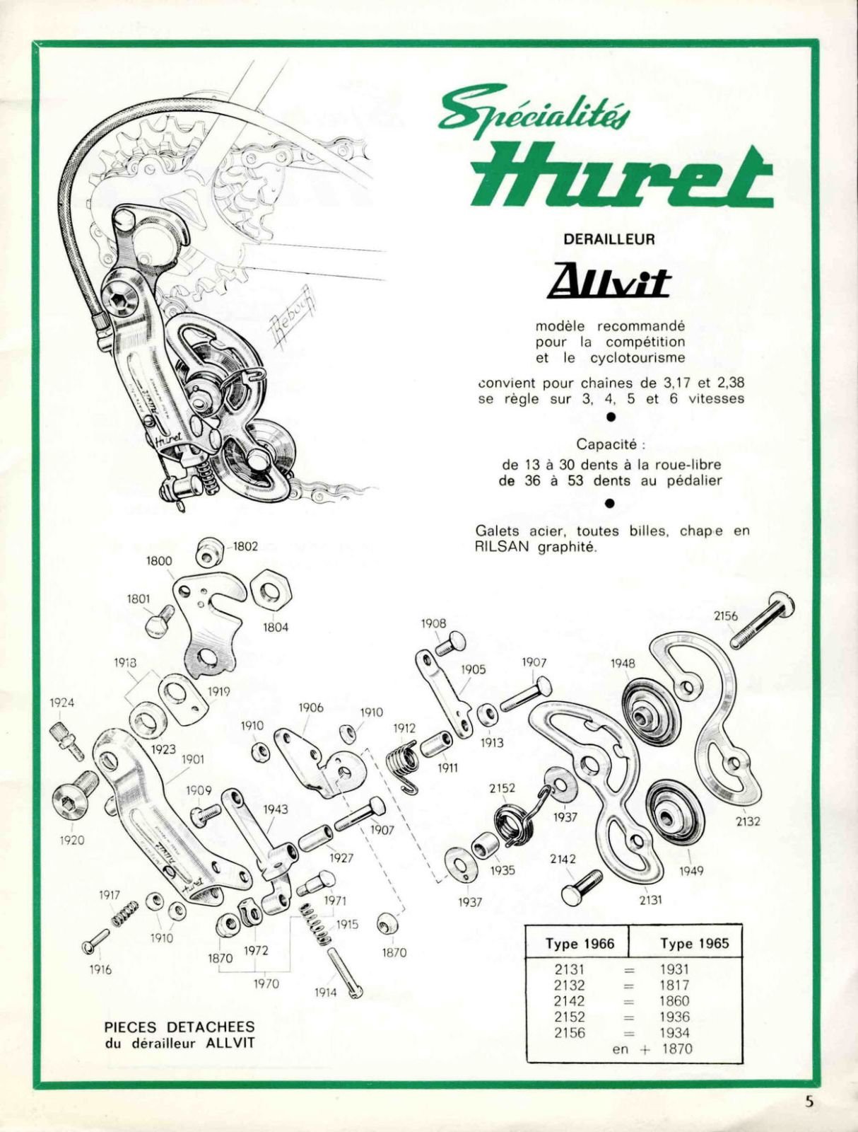

Originally Posted by subgrade View Post
On a related topic - what adverse effect comes from a worn tension pulley? Obviously, a worn guide pulley does negatively affect shifting precision and speed. But I suspect that with the tension pulley, given it spins freely and there is no play in the bearing, there shouldn't be much difference up until it is worn near round.
Am I wrong in thinking this?
Derailleurs have come with round jockey wheels as designed.
The benefit of teeth, is probably to keep the chain on the jockey wheels. Shifting hard with round jockey wheels, may push the chain hard against the side of the cage. The chain probably does not come right off the jockey wheels, because there is not enough space.

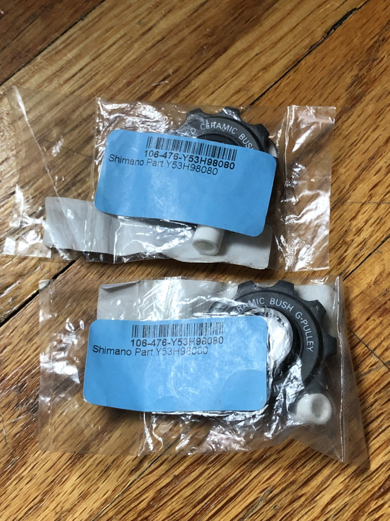

DorkDisk
Location: Kips Bay, NY
Posts: 1,926
Bikes: Ritchey Swiss Cross | Teesdale Kona Hot | Haro Extreme | Specialized Stumpjumper Comp | Cannondale F1000 | Shogun 1000 | Cannondale M500 | Norco Charger | Marin Muirwoods 29er | Hiawatha 3sp | Shogun Kaze | Breezer Lightning
Quoted: 470 Post(s)
Liked 636 Times in 339 Posts
Stock pulleys for me; since most of my bikes are 90s MTBs, I keep a stash of these around.

Quoted: 1708 Post(s)
Liked 1,359 Times in 880 Posts
30 years of production and millions of Schwinn and other brand10 speeds with Alvit derailleurs says it worked just fine.
I am not disagreeing. However I am suggesting, shifting hard with round jockey wheels, may push the chain hard against the side of the cage. So the cage takes the lateral force. Whereas when jockey wheels have teeth, the jockey wheel itself can take the lateral force.
