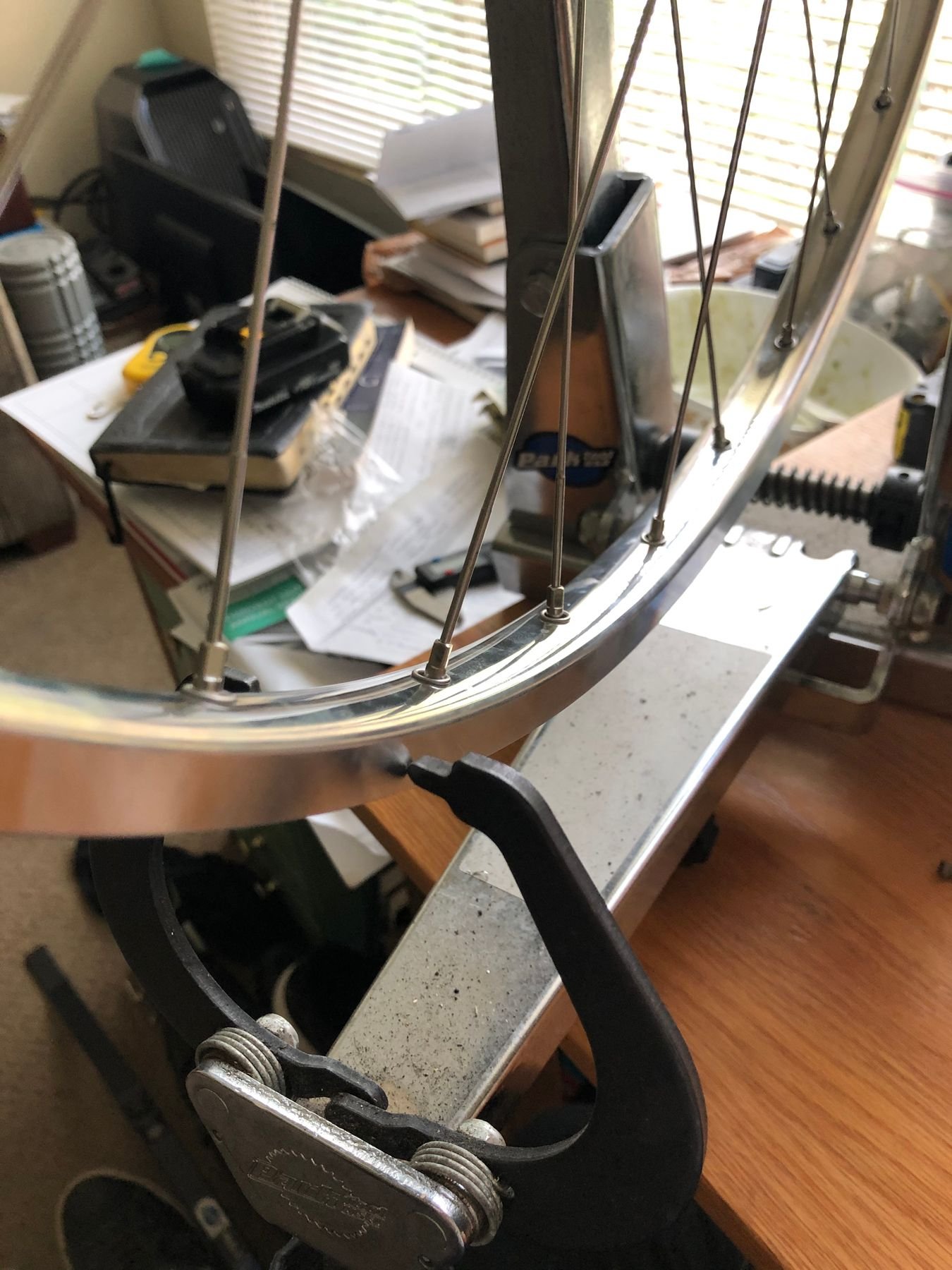

On a whim, I decided to peak behind the (rim tape) curtain and see how the spoke/nipple situation was doing. I was greeted by this (and a lot more brown caking in other holes):
Yikes! But then, that's nearly 30 years of life with the last five or so being under my tenure. I bought the wheelset for $200 shipped and have enjoyed many miles with them. They don't owe anyone anything.
I also noticed that at least half the spokes on the non-drive side of the rear wheel, and all of the spokes on the front wheel, were a bit 'shy' of the base of the slit in the top of the nipple [edited as I had spoken of a certain thread engagement amount as ideal and it was incorrect--this has been omitted]. It was a good surprise. Why? Because it meant that I could theoretically swap Brevets or TB14s and have a better spoke thread engagement situation than before. In fact, it was so much better in my mind that I said "forget another MA2, lets go straight for new!"

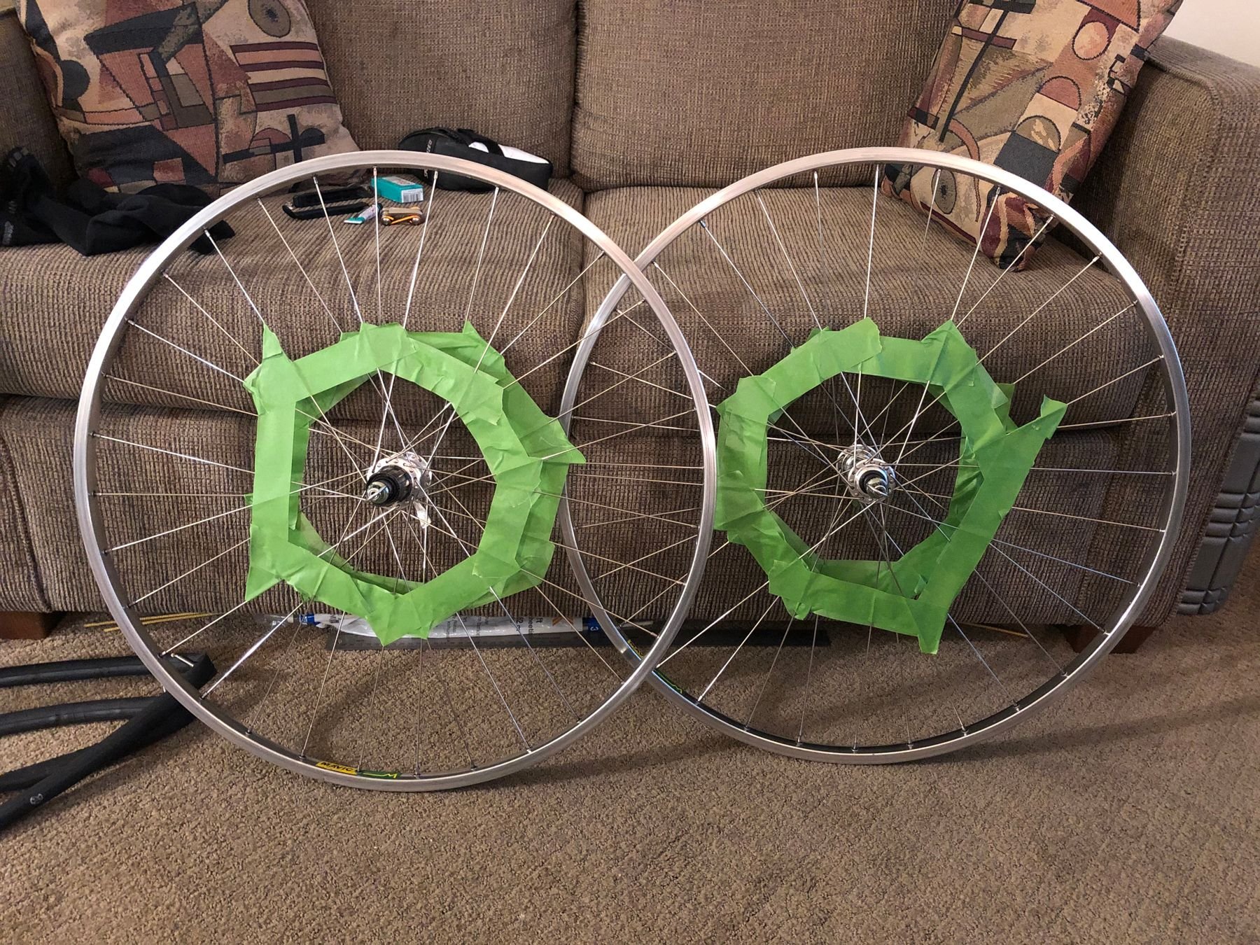

So off I went to order some TB14s, as the price and availability of Pacenti wheels always seems to be less stable than the more plentiful TB14. Many of us know that you pay a little more for the Brevets and get a 50g lighter rim with essentially identical width/depth specs to a TB14. That weight was something to consider as MA2s are generally in the 440g range. A Brevet is spec'd at 450g and a TB14 is officially 490g. Stouter rims for a touring bike? Doesn't seem like a bad idea to me. Nor does the bump in external width from 20mm (MA2) to 23mm. Plus, I had recently built up a Superbe Pro / TB14 wheelset and had a great experience. They more or less true themselves as you walk up the tension. I had no qualms.
Ordered. Paid. Shipped. Received. Unpacked. Former era, meet the new era.
Last photo of the former component union. It was a wonderful time, but we celebrate what is to come next!

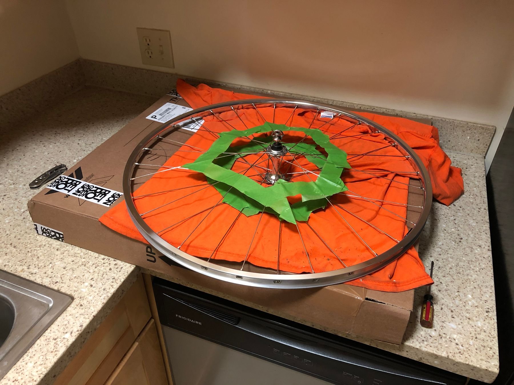

The spokes are all taped up. A small 10-15 minute price to pay for the utter convenience (and lack of incurred frustration) of spokes not floundering around, getting out of order.
We're not going back now!

I think Mavic didn't use stainless eyelets? Sure looks that way
RofS;
I had exactly the same thing happen except my MA2s had badly worn thinned sidewalls but no eyelet cracking.
I replaced only the rims with TB14s (love'em I've got two wheelsets built up with them.)
I did the tandem masking tape, swap one spoke at a time thing.
No problems with running out of thread.
You should be fine, in fact the proper thread engagement is to the top of the nipple according to Wheelsmith.
You'll likely end up right about there.
If you haven't built TB14s, all of mine camera came out of the box dead round and flat, makes for an easy build.
Edit: Oh, just noticed you've built TB14s before........

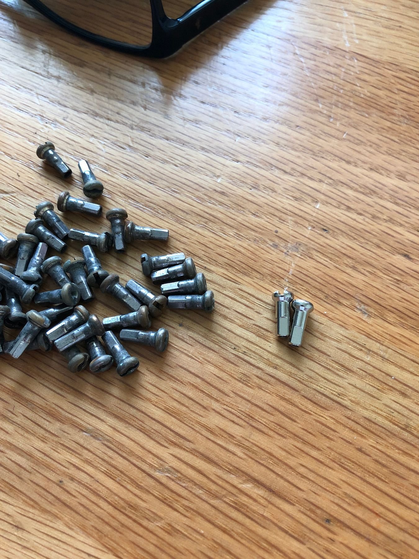

I ordered some DT Swiss brass nipples to replace the veteran nipples on the wheelset up to that point. There were certainly some grumpy spoke-nipple combinations that didn't want to come apart easily. They were almost exclusively on the rear wheel, which makes sense. The front wheel was essentially hassle free.
The spokes, as I mentioned before, were in excellent visual and functional shape--even their threads! That was a relief. The nipples were fine, when on the bike and half lost in the overall polished composition. But when you compare them to brand new ones. Well........

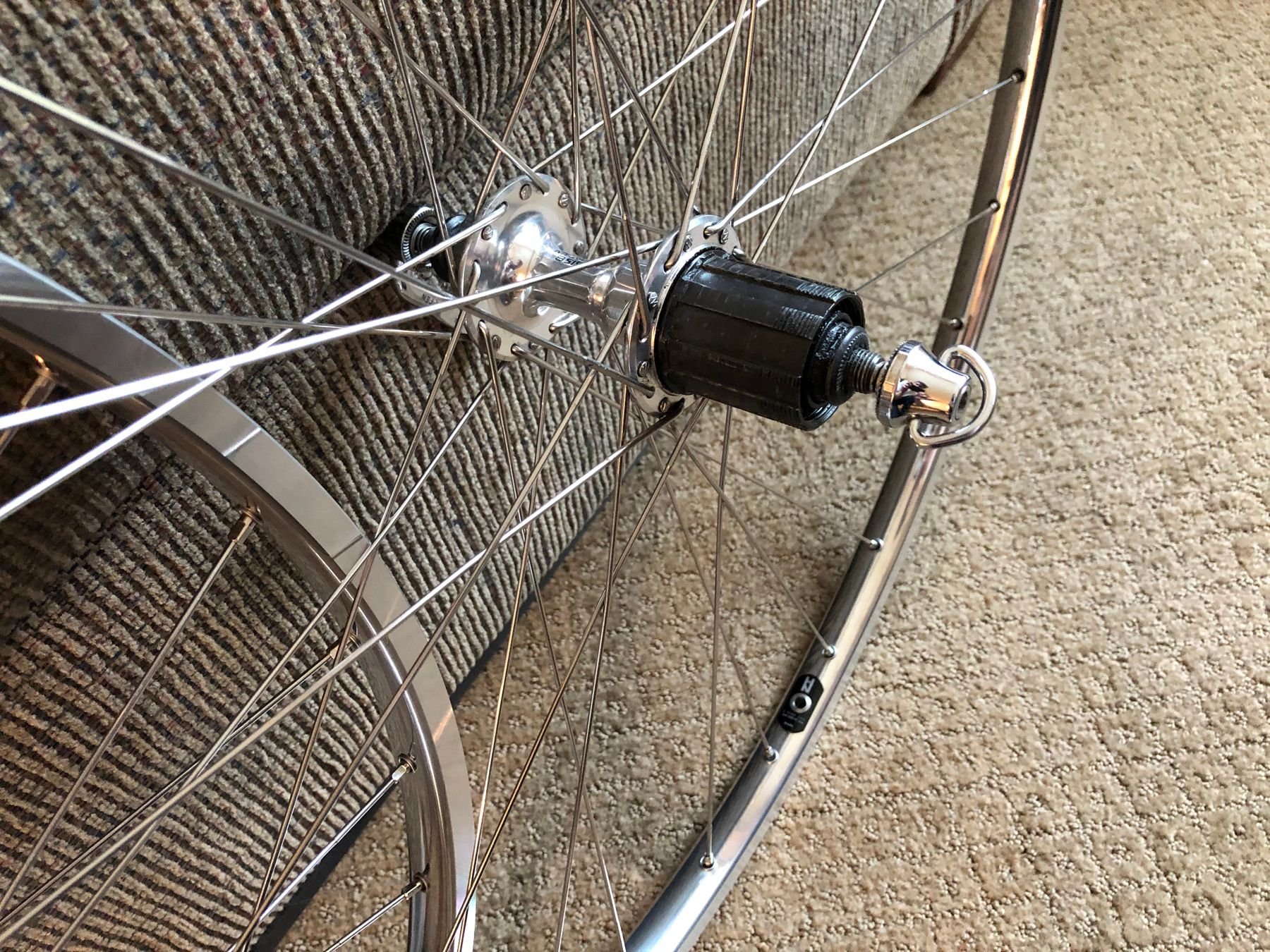

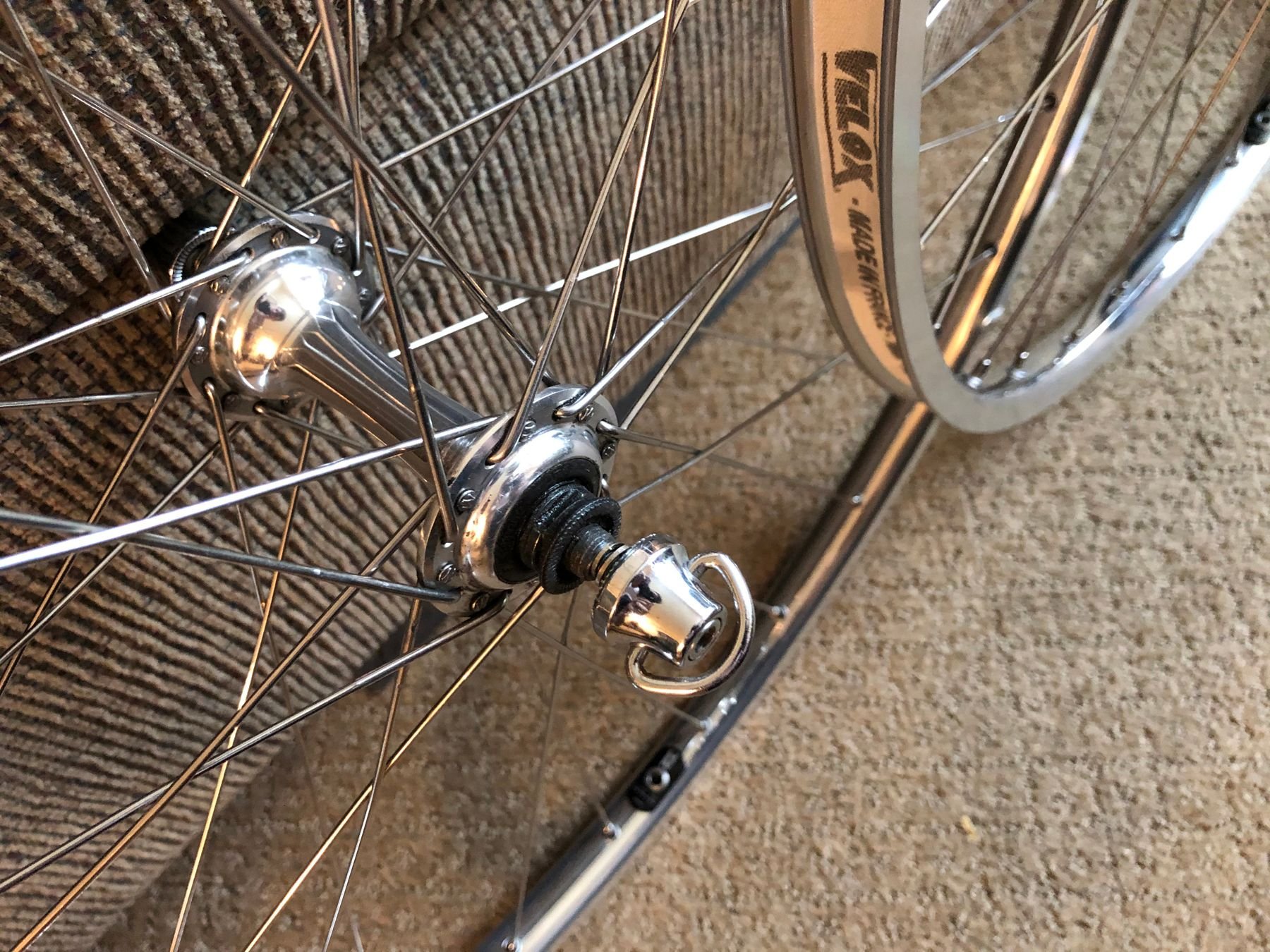

I picked up some 16mm (closer to 17mm) wide Velox rim tape. TB14s have a trough in them that is perfectly sized to accommodate that, and 17mm tape more than covered the spoke holes. I wasn't worried about needing extra width. So here we have some finished product shots:
It may be 'half new' but it looks brand new!
Gotta love that UG and HG compatible freehub.
Love the polish and how both old and new work together visually.
Used Grand Bois tires, due to the increased rim-lip-to-rim-trough depth (over the MA2s), were MUCH easier to mount. I cleaned the Ultegra 11-28T cassette as it was only fitting.

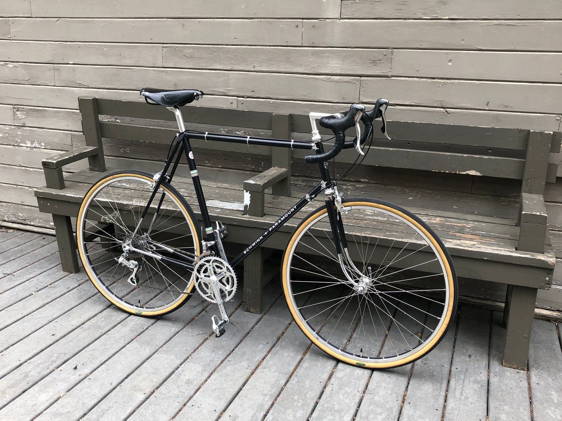

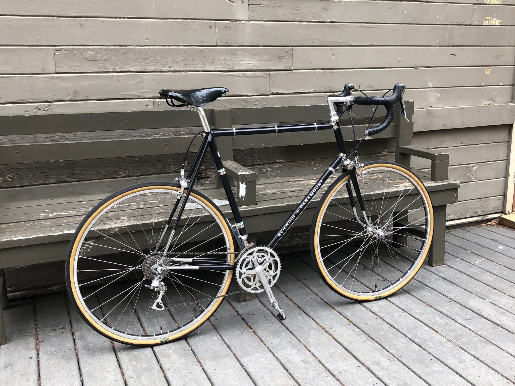

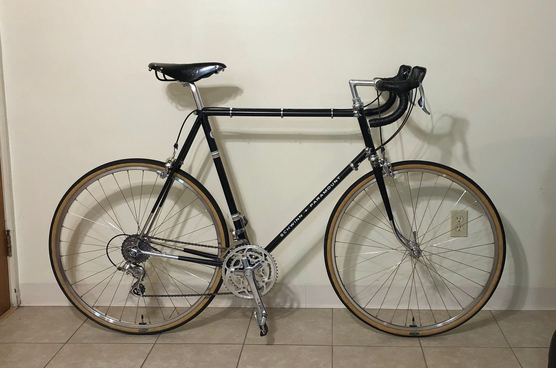

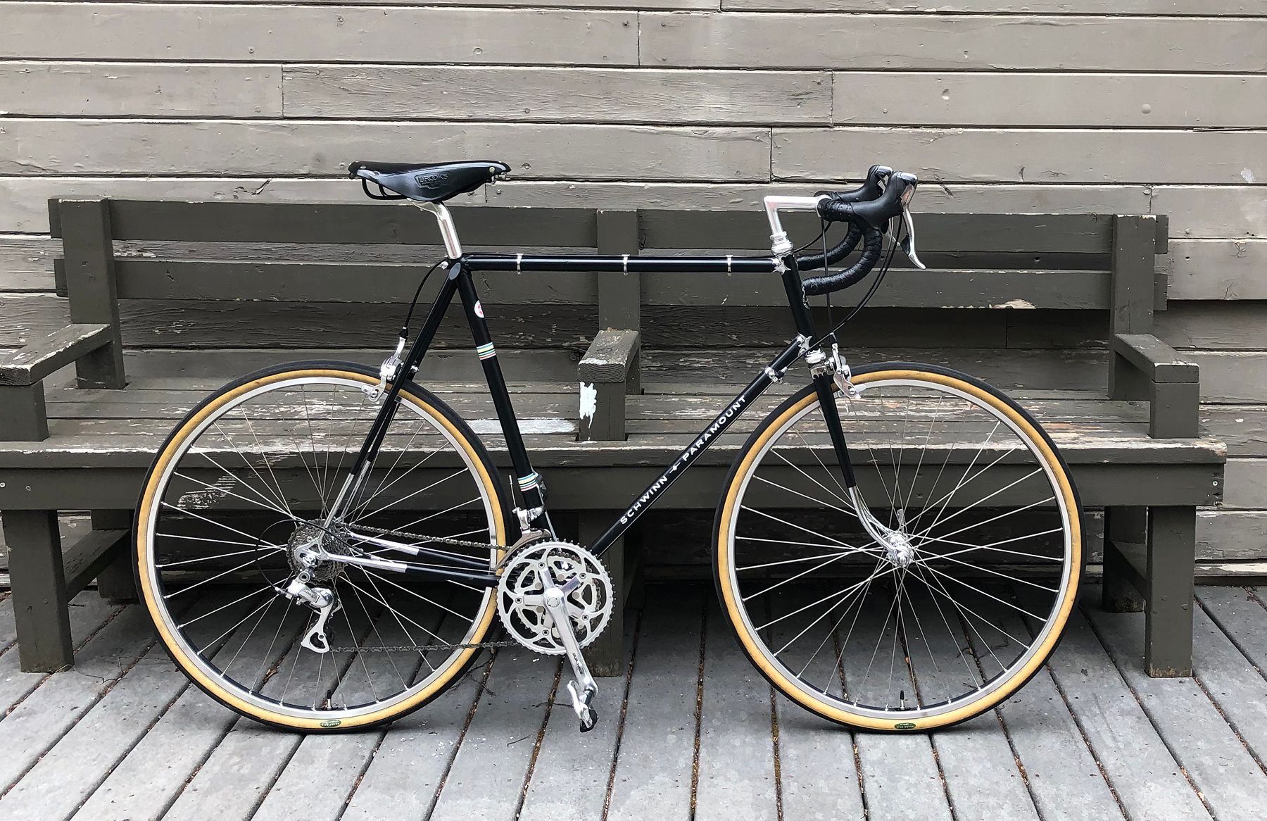

This isn't a weight weenie build, but I'm glad it happens to be right in line with some TB14/Shimano 11-speed hub wheelsets in weight. Yes, I did increase rotating mass, but the wheels are stiffer and wider (thus surer) over the MA2s and I know my Paramount responds very well to stiffer wheels. How much so will depend on the test ride I do later today (yesterday was raining). My Paramount is also the recipient of (another) new, wider axle BB-UN55 to correct non-drive-side Q-factor issues (too narrow before) while also eliminating drive-side BB spacers (for required chain line). Big changes, for the better, that I am sure will set me along for hopefully decades.
Indoor photo of finished project. Outdoor photos to follow:
Going full numbers nerd, for your amusement, information, and posterity. Weights and (some) measures. Keep in mind the MA2 has an external width of 20.0mm and the TB14s 23mm.

Front wheel assembly weight - B wheel weight, plus tube, tire: 1429g
Rear wheel assembly weight - B wheel weight, plus tube, tire: 1656g
Wheelset weight C: 3085g
Rear wheel weight C plus Ultegra cassette, lockring, and spacer: 1892g
Gross wheelset weight (D): 3321g
Rim lip to trough depth - MA2: ~7.0mm
Rim lip to trough depth - TB14: ~8.3mm
Subtract 0.6mm for Velox rim tape thickness, so 6.4mm and 7.7mm respectively
MA2 lip-to-lip diameter: 633mm
TB14 lip-to-lip diameter: 633mm

I love the idea of the TB14s, but they build into such heavy wheels! The lowest spoke count they come in is 28, but that count is irrelevant to most vintage wheel builds. With 32 spokes, you have to try every lightening trick to get to the 1700-1800g range (aluminum nipples, super butted spokes). Yeah I know tubulars exist for people like me, but sometimes I don't want to spend a weekend fixing a flat.
Likes For RiddleOfSteel:
Master Parts Rearranger
Join Date: Mar 2015
Posts: 4,116
Bikes: 1989 Davidson Impulse - 1985 Trek 620 - 1982 Trek 728 - 2014 Trek FX 7.3 - 1989 Trek 420 - 2008 Trek 1.5 - 1986 Univega Viva Sport
Mentioned: 207 Post(s)
Quoted: 1343 Post(s)
Liked 1,283 Times
677 Posts
RofS;
No clue, but yeah, the corrosion sure implies that. The eyelets on the spoke/out side looked completely fine, just normal age or patina (a dull grey).

Those are sharp-looking wheels and are using one of my favorite tires. One nit: They're not Compass (nor Rene Herse)--just Gran Bois in Japan (though I think Panaracer makes them and J. Heine might have sold them at some point).
Join Date: Mar 2015
Posts: 4,116
Liked 1,283 Times
677 Posts
Thanks! Thank you also for pointing out the tire error. That makes a lot more sense. I have corrected it in prior posts!
Posts: 15,539
Mentioned: 394 Post(s)
Quoted: 2888 Post(s)
Liked 3,460 Times
1,575 Posts
I'm currently cooking up a single-speed project that'll feature those tires. Wheels arrive tomorrow!

RIDE REPORT:
Well, I think the first errant semi-pothole / crevice in the road let me know that the new rims mean business. What would normally be a still-alarming whomp with the MA2s would nevertheless be a bit tempered by the lesser rim weight, reduced rim width (less "bulb"-like shape to the tires to suspend), and lesser rim strength. So welcome to your new wheels, Riddle; I hope you like them.
Only about four rim-settling 'tings' emanated from the front wheel upon some initial out-of-the-saddle pedaling. I will count that as a win in my wheel-building book. And perhaps it was the low-profile machined sidewalls, but my brakes certainly had noticeably extra bite. I will always welcome extra braking, especially when the tires have plenty of grip to spare before skidding.
If I'm honest, I would have light-heartedly joked that the MA2-hooped wheelset and tire combination would have been "mush" in some senses. They tempered a strong or stiff, less willing-to-rock-back-and-forth frame. They took my somewhat whippy 1981 Trek 716 and dropped it below my approximate "too mushy / supple" threshold. They brought my Paramount to just at or above that threshold. They softened and made more willing my '86 Cannondale SR400, my '85 Peloton, and my '85 Paramount. [side note: knowing what I do now about out of saddle shenanigans, a wheelset need not be the remedy, but rather drop bar type and height]
So I asked myself, would the lighter Pacentis feel a touch more sprightly? Would they be as stiff or strong, or am I still better off with the you-can-actually-find-them-for-sale-in-32-hole TB14s? Have I done a sports car modding faux pas in gaining wheel strength/stiffness/responsiveness by simply "going bigger", incurring the traditional penalties of added rotational mass and harshness? Would a lighter yet still as stiff wheelset yielded near the same result? Or would its lessened rotational mass act as an additional damper in a hard pavement joint? Or would it have been just as mushy?
Let's start with some obvious first-pump-worthy stuff: The new wheels absolutely rail medium and high speed turns. This is where the touring frame weight, touring bike wheelbase, heavier and stronger rims--suspended ultimately by generous tires--work to the advantage. Descents are a non-issue with these. That feels really cool--an unflustered cornering effort.
How about out of the saddle? This is something I am fond of doing, and analyzing. Normally with tall, big tire bikes, the rocking back and forth of an out-of-saddle acceleration effort is met with some pondering and slow swinging. This is very true of frames that are normally spec'd for 25mm tires yet can fit a 30-32mm tire under their brake bridges, fork crowns, and calipers. I draw from a number of accommodating touring bikes in addition to the Paramount: an '82 Miyata 1000, a '90 Cannondale ST400, the aforementioned Trek 716, and an '84 Miyata 610. The Cannondale was in its own league, but the Paramount is now quite close. The 610 was also very good, aided by its very light and quite stiff wheelset (running 32mm tires).
There is no real 'snaking', to use a term, when accelerating or climbing. Especially climbing. There is a 10%+ grade that I do hill-climbs on near my home. Only about 0.2 miles, but it's done out of the saddle in either a 39-24 gear combo, or a 39-21 if I'm feeling real good and on my Davidson. And it's not even too difficult thanks to a taller drop bar setup on both Paramount and Davidson which allow for fairly upright out-of-saddle climbing--like walking up a flight of stairs. With the old MA2s, the Paramount would 'snake' as I rocked back and forth casually, climbing the grade. That 'snaking' is essentially gone. Nothing wrong with before, as it was part of the slow dance up the hill, but it's more business-like now.
Flat road acceleration is equally 'stiffened' and the bike rocks back and forth more willingly. It's still not a race bike, but she rocks plenty well. Sometimes I think I can feel the extra rim weight on spin up, and perhaps I can. Still, I'm not as strong as I've been in the past a bit, mostly due to a knee (IT band) that I still can't see a fitter/PT guy about because of the virus stuff.
So, some final quick thoughts before I give you some pictures and limit my ramblings here: 35mm tires are a go now, and I do have Paselas that I used on a previous 23mm wide rim (the black ones when I had this built with Campagnolo EPS). That will be cool to test. Those Campy-splined wheels were just over 1800g with their Origin8 hubs and Velocity A23 rims. Stiff and light and a great match with the Paselas. I will do a more granular break down of wheel component weight for those wheels and mine, and see where things lie.
I am pleased with them overall. Now to get used to them and re-true the front wheel as I expected to do some touching up after riding them.To pictures:
