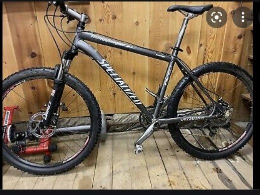

Currently bike is boxed and in attice, but gonna bring it down and clean up this coming week - but here's a web picture which shows the frame - parts are mostly all XT/XTR, 3x-9, 11-32, current wheels are high end shimano tubeless, so I'll prolly go tubeless on the new 27.5 frt wheel as well.
Stumpy M4 - similar to mine
