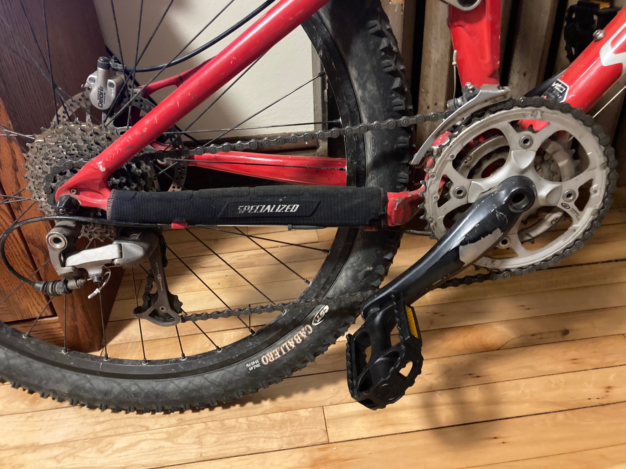

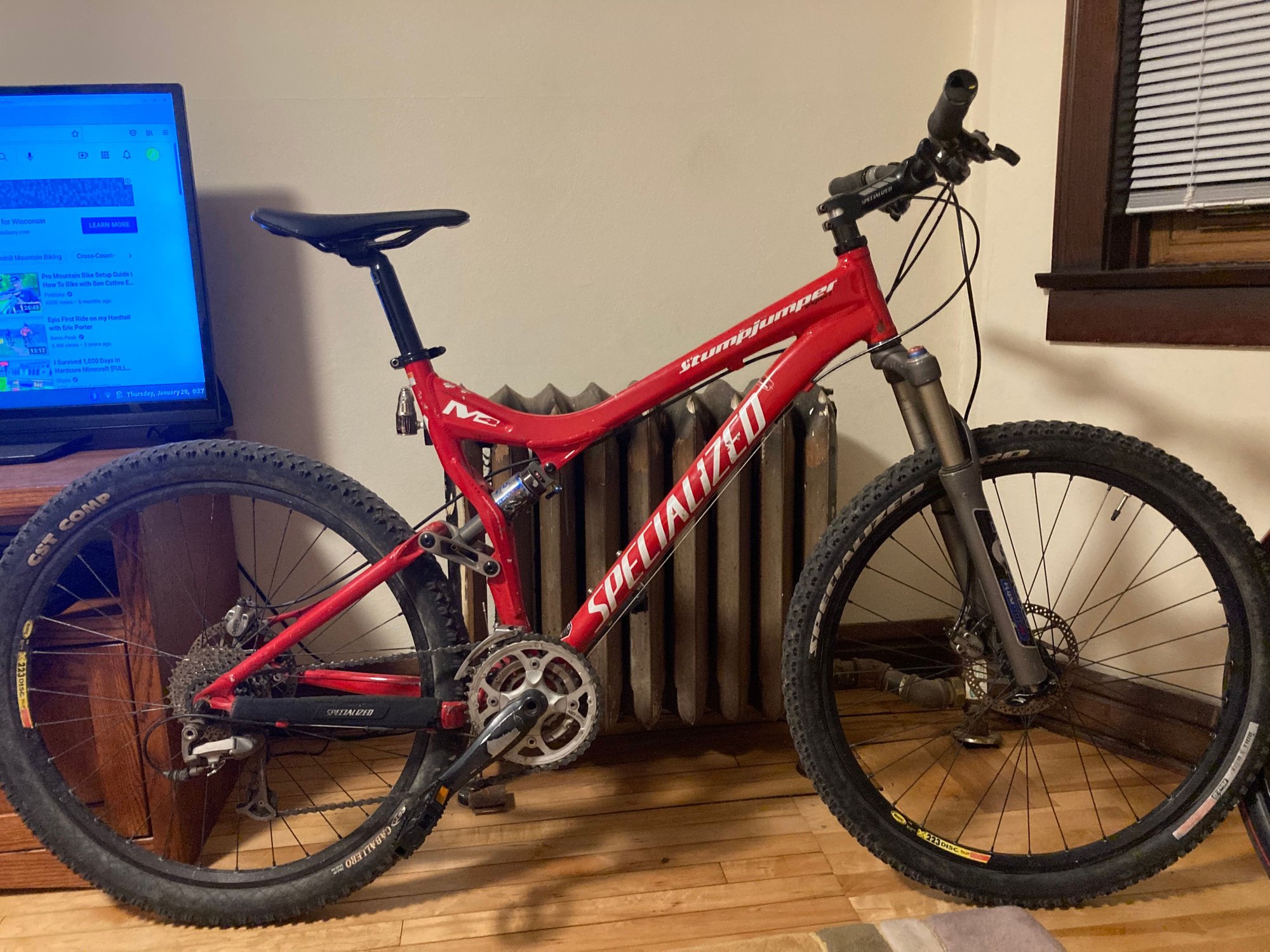

Alright. Here痴 the before. Realized maybe I値l weigh it too, just for fun to see if that changes at all. No idea if it値l go up or down. Maybe up since I知 adding a dropper and beefier tires, but also ditching the triple(though bigger cassette) and shorter stem, so maybe it値l stay close to the same? I値l probably start tearing it down this weekend.

Schweet ! Nice touch with the radiator background ! and old school hardwood floors ! That stuff was Built to Last !!! And still looks/works so nice.
BTW : Those CST Caballeros were the """Schizz """" back in '06 ! I think I still have 2 NOS hanging in my tire stock... Iff'n you're in need... LOL!
yeah noticed that kink in the seattube the other night, when I looked at the '04 stumpy FS online. But it might work with a 100mm dropper - if you have the 'leg' for the seatpost height...
my Epic does have a straight seattube, so I was able to fit a 125 dropper...
same drivetrain as my Epic...
looks like the same fork, and should be able to take a 27.5... makes a huge diff. !!! will be a fun ride when you're done!
