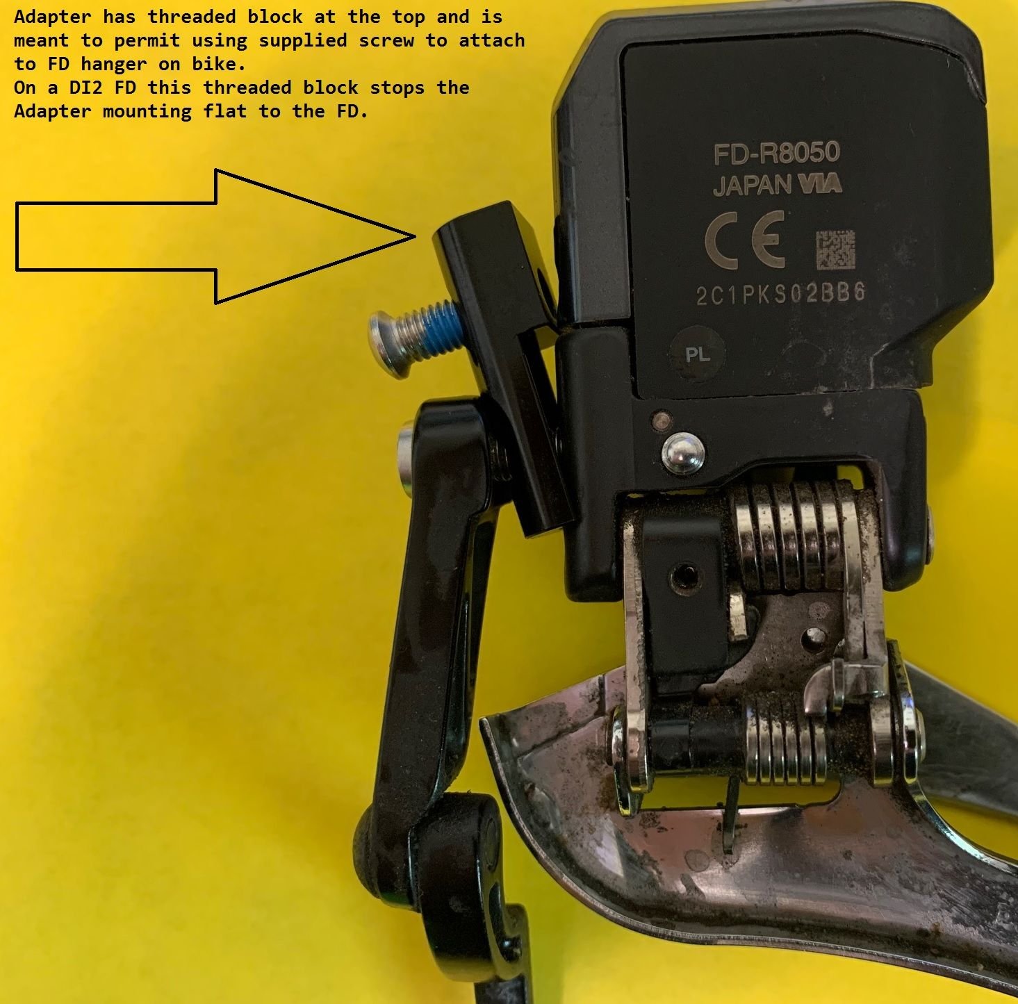

I didn't know these existed !!!!
I like it..... mainly because it would let me keep my Stages dual sided (crank) power meter.
bikinGreen CNC Chainring 46/30T FoR Shimano 4 Arm 10-11Spd Road Cyclocross Tour
I believe this is the adapter
If anyone decides to purchase one, please do report back.
Thanks
Barry

Rings are nicely made, and unlike the Shimano ones bolts go from outside to inside not that it really matters. I could not find a torque spec for the chainring mounting bolts and used a guesstimate of 9nm. After all the bolts are only going into 7075 aluminum.
Bike is an R3 so it's carbon and the RD hanger is very short in the adjustment department. In fact, it's at the bottom of the adjustment range when using the standard compact 50/34 Shimano rings.
So I need to be able to mount the FD lower and attempted to use the Bikingreen adapter.
The Bikingreen adapter does NOT fit my Di2 FD-R8050 front derailleur. The threaded block at the top of the Bikingreen Adapter hits the housing that contains the Di2 workings. I suspect this would not be an issue for a non Di2 FD, but I don't have one to confirm fit.
GOOGLE to the rescue
FSA makes a similar adapter but without the use of a threaded block at the top....... FSA Bike Bicycle Front Derailleur Super Compact Adapter Kit EL344
I've got one of these on order and will report back once I've tried fitting it.
Picture of Bikingreen Adapter WAY crooked on my Di2 FD
