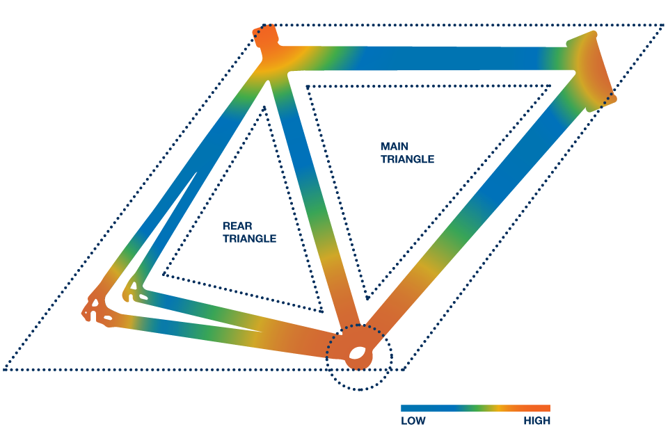

As noted, that's not your seat tube; it's part of the "seat stay", which in turn is part of the "rear triangle".
This frame element is mainly under compressive loading, so should be resistant to fatigue cracking; it's also readily available for frequent inspection.
I'd ride it with no worries, but I'd look at it once in a while. Even if it fails, it's not likely to do so in a catastrophic manner.
It's pretty well deformed; I would guess it's an aluminum frame, which puts it into a somewhat more troublesome category... though low risk. Of course, you can test it with a magnet; if it's steel there's almost literally no concern.
The "seat stay" is the left side of the rear triangle in this image. Orange is high-stress; blue is low-stress.
