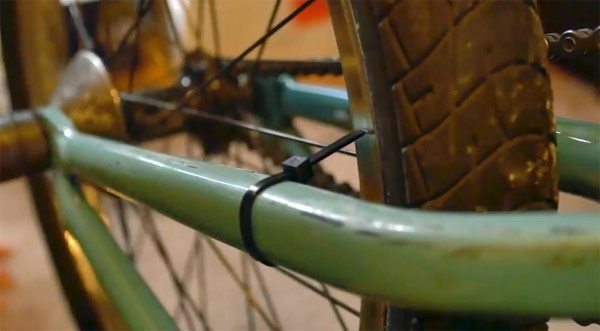

I've gott'a give that a try with the zip tie.
