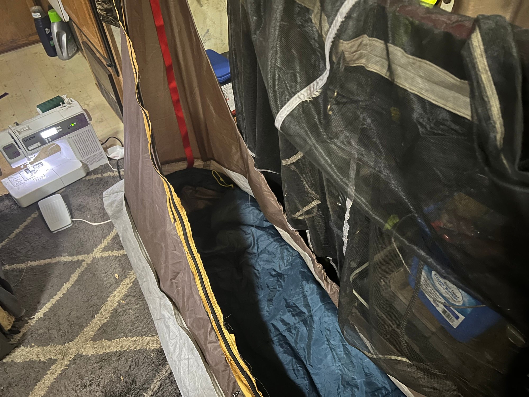

Ok, so the main goal here is not to keep the sleeping bag and pad inside the tent… I said it would be possible to roll it all up into one… The main goal is to have a light weight tent that can be set up in several different configurations depending upon the terrain.
I have muscular skeletal issues that make putting up a shelter at times a real chore… especially if I just spent 4-6 hours riding. So what I look for in a tent is one that is easy to unpack, setup, and tear down. The tent must pack well for a bicycle. And lastly sustain the 40hp winds we have been having here lately…
The tent is a one man tent prototype is a one man tent that can be set up via two tent poles and two guy ropes, a tree and a pole, two trees, or just my bike and the ground. My sleep system can roll up inside the tent (although with a self inflating pad it’s kind of bulky, but my ultralight mattress makes the system roll up a little larger than just the sleeping bag alone). Because my idea to use the sleeping bag stuff sack as the case, this means the whole sleep system can fit inside the sleeping bag stuff sack, or if the tent is wet it can be packed up without the sleep system.
Tent suspended to work on the ridge line
Tub is 26” wide and 80” long… you can’t see it in the picture but there is a 6” gap between the pad and the head of the wall.
All rolled up with self inflating pad, sleeping bag and tent… too large to fit into the sleeping bag stuff sack.
Tents fold in on themselves in most all packing systems. Mine lays on the ground cloth and the tent is rolled around the tent frame. If the fly is wet due to rain, it may (or may not) go on the outside of the ground cloth. The whole roll is then placed in a bag.
…But the key point is that if the tent, the fly, or the ground cloth are wet from rain or just morning dew, the whole tent is going to marinade in the bag and get wet from inside to outside. If a sleeping bag were in that roll, it, too, would get wet. It’s just the way of water in a closed system. You could make the bag so that it wouldn’t be waterproof but heaven help ya if it rains.
Since I have started using a minimal hoopless bivy and tarp I have started packing the pad in the bivy most if not all of the time. The tarp generall packs separately as does the sleeping bag.

I do plan on buying another tent… this was mainly a project to pass time with and repurpose trash. If the tent works for my needs, great, if not… no big deal as it was trash to begin with. The other thing is… how many tents do I need to own? I have three different backpacking tents, two duck canvas outfitter tents, a Gazelle T4 Plus, and a 3 room cabin tent. My wife is tired of my spending money on camping gear, especially tents.
The problem with my backpacking tents is they are all 4 season tents with very little ventilation… great for snow camping (which is when I used to do the majority of my backpacking/elk hunting until I could no longer do it). The other problem is since they are made for 4 season use they don’t pack down very small. My lightest tent is 2.5 lbs with stakes, poles, rain fly, and compression sack… but it only compresses to the size of a basket ball and uses priority poles that are 28” long when folded. Works great lashed to my 85L backpack/pack board, but doesn’t pack well on my bike.
As I said in my last post, the sleeping bag and pad don’t have to stay inside the tent, and the probably won’t…. But here is a question for all of you saying the bag should always be put away separately from the tent…. I have a sleeping bag that has a bivy cover attached to the bag… what is the difference between this and having a tent and bag packed up as one unit?

im hoping to get to work on the rain fly today, The bug net portion has to wait a week or two for me to order some netting and a couple of zippers.
