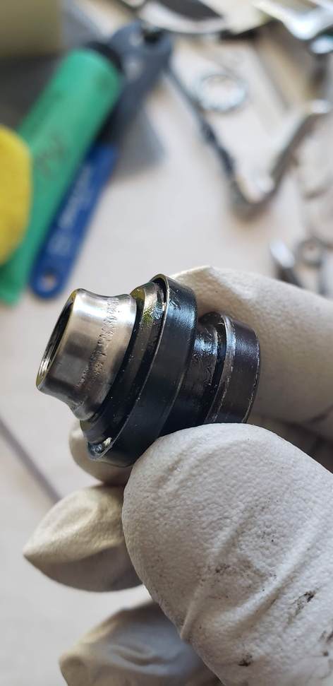

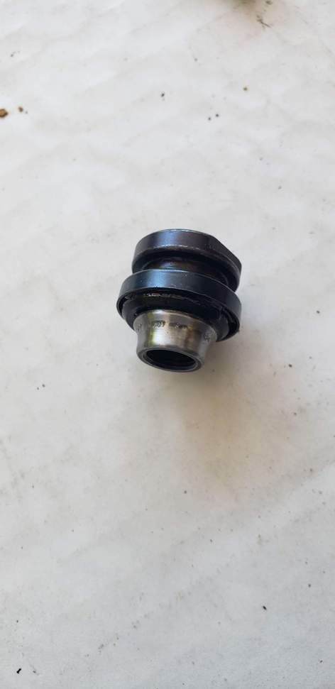

Old 06-29-22, 04:17 PM
Blaylu
Join Date: Mar 2020
Posts: 20
How about a photo of the actual cone and the damaged area.
I have done pretty well polishing out minor pits using a drill and handheld sandpaper.
I have been using fine sandpaper to light sand and smooth the pits and it helps. Unfortunately, it's getting worse. Hopping I could find a replacement cone. I will contact Wheels Mfg to see if they have a solution.
Blaylu is offline
Old 06-29-22, 05:22 PM
CliffordK
CliffordK's Avatar
Posts: 26,894
Mentioned: 213 Post(s)
Quoted: 15953 Post(s)
Liked 3,284 Times in 2,440 Posts
Those are some good sized pits. Probably a bit more than I would try to sand out. Possibly cut on a lathe, but that will greatly change where the cone will sit.
It almost appears as if there is a steel ring as part of the seal that might be removable. Still, that is a pretty complex shape that may well only be available OEM, unless some MTB cones would be close enough.
If you could find a slightly oversized cone, it could be carved to shape in a matter of minutes.
CliffordK is online now
