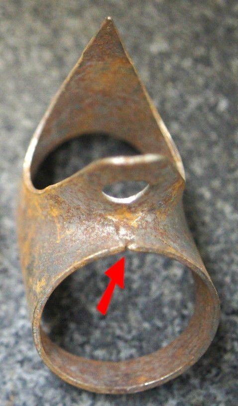

Clear Coating Bare Steel Frames
Paint hides a multitude of sins!
Removing the original paint on a production frame or even a respray can reveal a lot of surprises! All the worts become visable...
Most of the lugs used before the mid 70's were really low quality made from stamped sheet metal or drawn tubing with ugly welded seams.
Gaps in the braze along the shorelines of the lugs are usually not visible until the brazing flux is removed. The easy fix is to fill the gaps with auto body spotting paste. Same thing with scratches and dings in the tubes.
The best candidates for good looking clear coated frames are purpose built from scratch with flawless brazing and lugwork.
I've seen frames like that from Albert Eisentraut, Ed Litton, Bruce Gordon, Peter Johnson and other artisanal builders to show off the quality of their workmanship.
Back when bikes were made by blacksmiths, most were painted black! It doesn't show the dirt or flaws...
