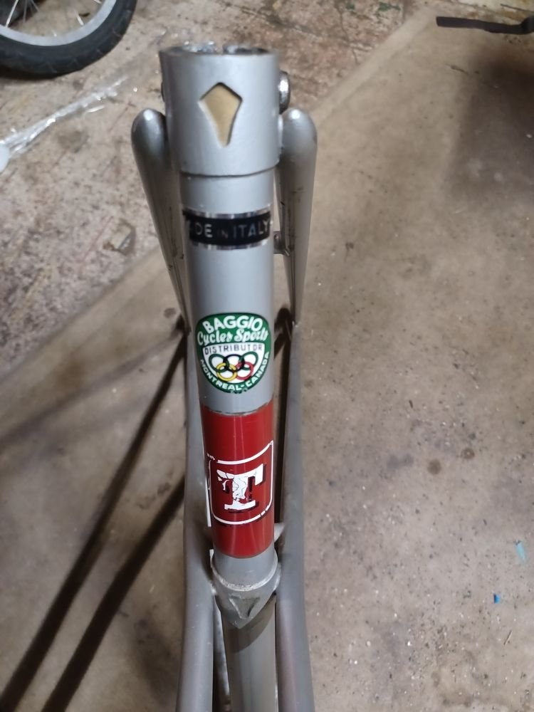

Just arrived - a frame, fork, wheels, and brakes. This was one of those deals where shipping was more then the bike.
I know it's a 1974:
It's nothing special as far as a frame; weights are 2835gr and 770gr, and the seat tube measures 51cm from crank centre to the middle of the seat lug.
It came with Normandy hubs laced to unbranded steel 27" rims, they are dimpled a la Rigida, but they are not exactly the same profile, the spoke bed looks a little more curved.
The front is hollow, the rear solid.
There's a dirt-shadow that matches the outline of a Simplex front mech.
There are a lot of little braze-on guides for the cable housings, no stops - the housings run all the way.
For a 48-year-old bike it looks pretty good.
The patch on the fork is the worst bit, the chainstays underneath show slight flattening and paint-wear from a kickstand.
How many different colours of silver are there...
This will get built, likely french period (or at least acceptably old) stuff, probably with 700c rims.
It will need a nice alloy front mech, a Simplex or Huret, and that needs to have a cable stop.
And a set of condorino bars would really look the business.

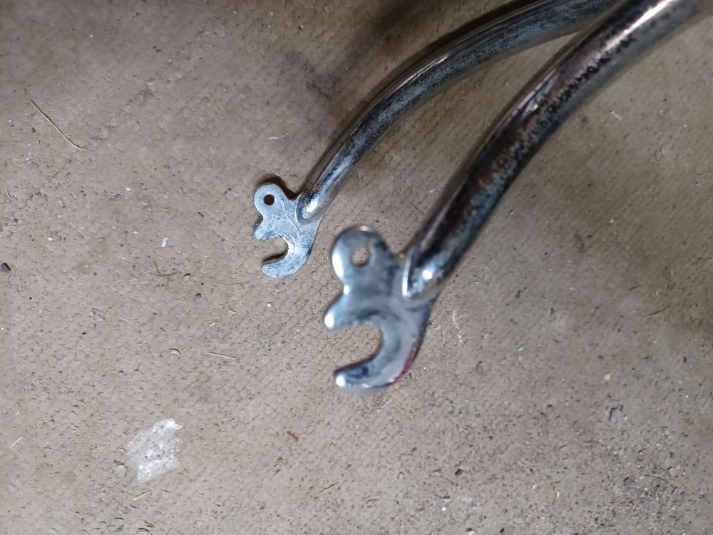

dropouts are Agrati Nr. 000.8002
fork ends Agrati Nr. 000.8010
fork crown Agrati Nr, 000.8058 (used in conjunction with the "AM" pattern lug group)
bottom bracket shell Agrati Nr.000.8507
seat lug Agrati Nr. 000.8059

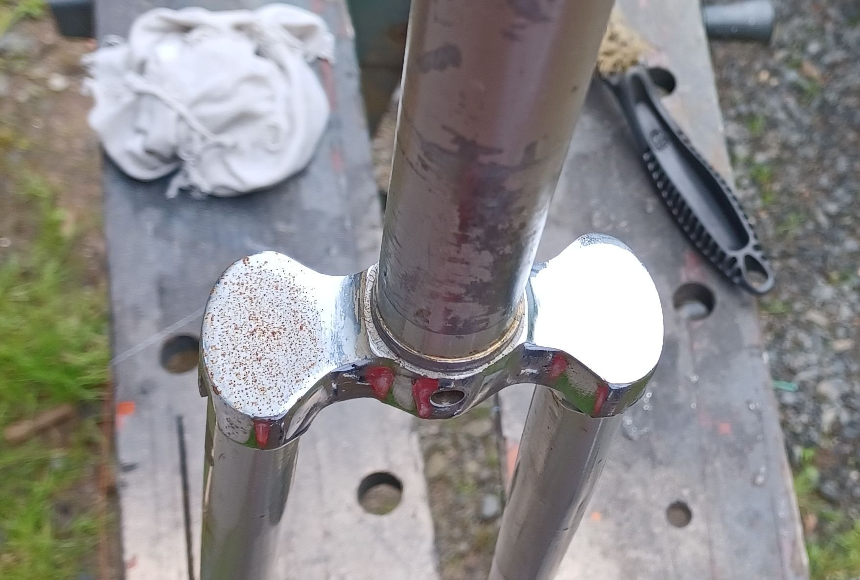

a little bling check - before and after
Took a rag and some washing-up liquid over the whole frame, then had a go with that and the wire brush on the plating.
Left side is before, right after (should be obvious):
From this angle you can see the pinholes (grey blot on the upper right is paint):

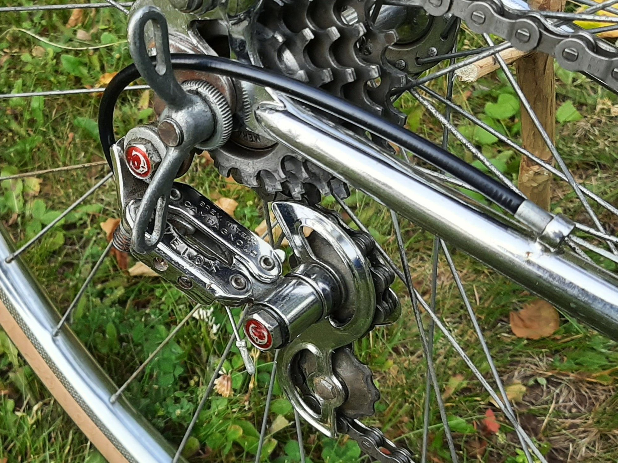

The Valentino and similar rear mechs all had the same design issue - the pivots are so short that the variation in paralellism resulting from any wear/play is much greater than mechs with wider pivots. I wouldn't put them on anything.
Current plans are for a Sach-Huret New Success, if I can re-wind the top spring so it stops binding.

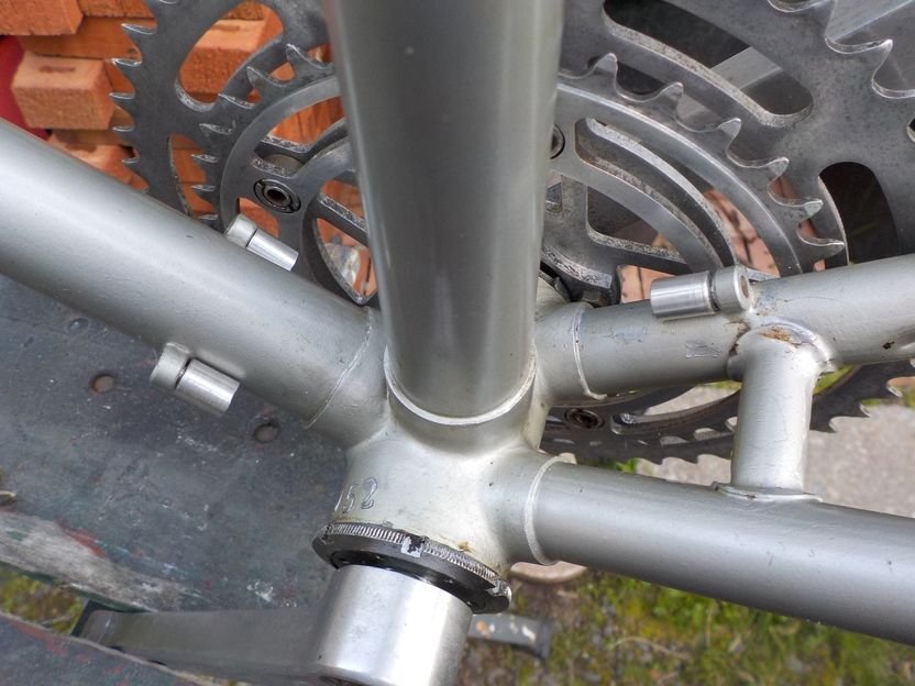

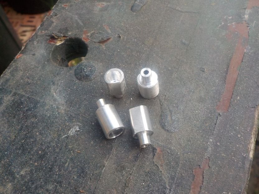

Those cable guides needed stepped ferrules, and I didn't have any.
What's worse, net searching showed there are ones with short small sections and those with long small sections - longer is better as it helps alignment more.
Longer ones cost more, and they all would take time, unless they cost a LOT more.
So I took some bar stock and made these:
The flat is necessary:
The other three go here:

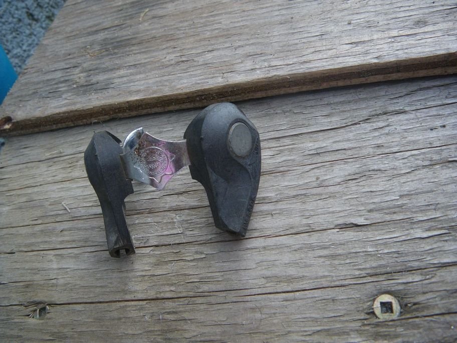

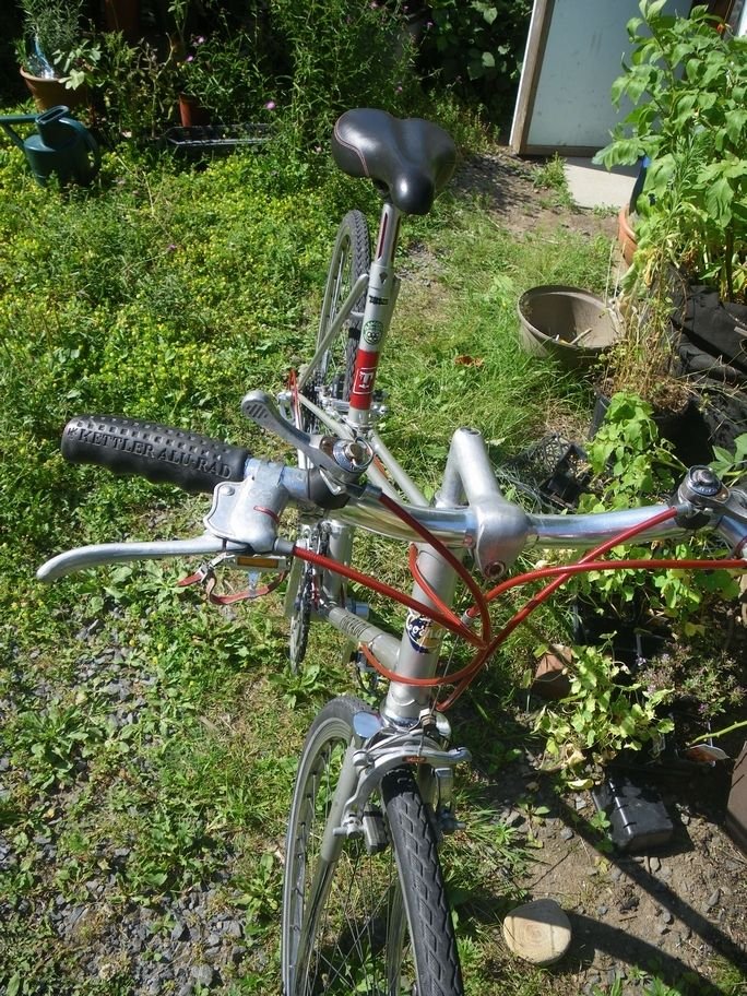

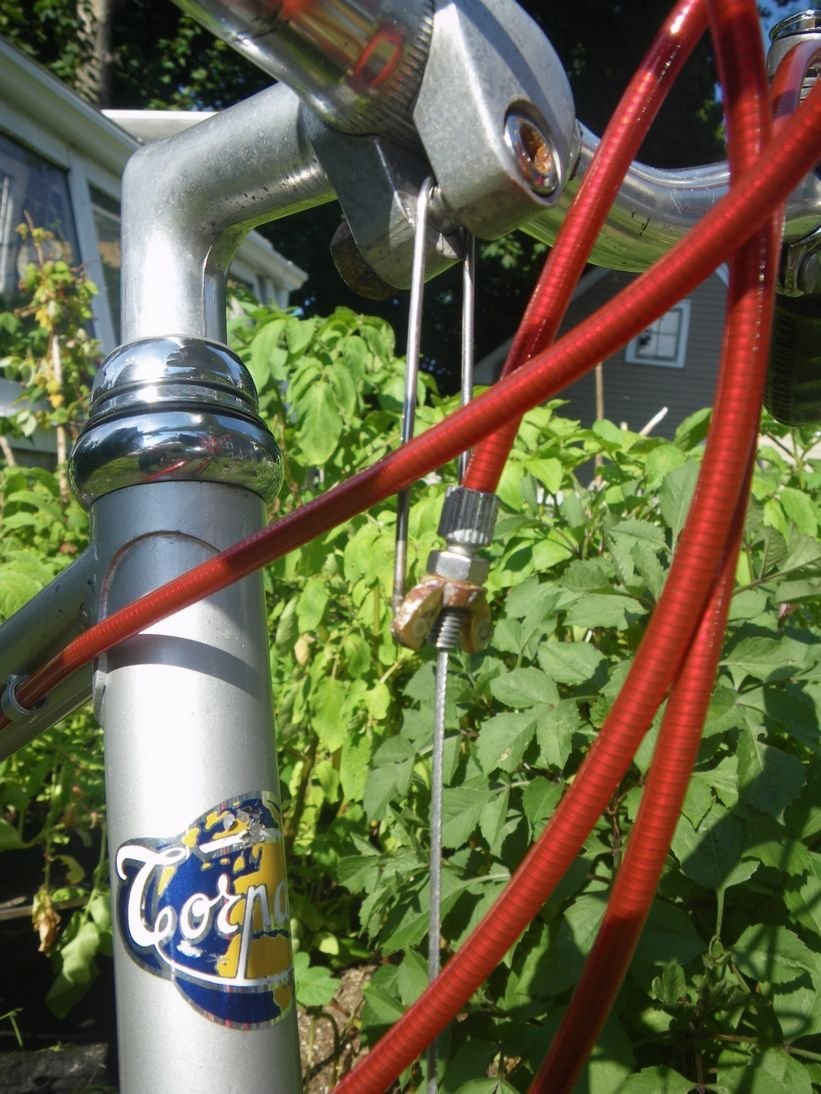

More metalwork, and the bars are setup
I didn't have enough threads at the top of the headset for a normal centre-pull hanger, and they are always so short that the cable outer has a sharp turn.
This one loops over the bolt that clamps the bars in the stem - it's just a bent spoke silver-soldered into a brass wingnut, tapped to M5x.08:

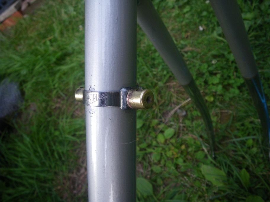

I needed a downtube double cable stop, so I took one of these Simplex guides:
When you drill out this rivet there is a nice square hole in the band:
I turned a pair of brass cylinders, cross-drilled the appropriate holes, filed a matching square in the ends and silver-soldered them into the band.
The plating where the new bit was to attach was removed with one of those diamond-grit "files" - they are harder than the chromium.
And here's what the front end will look like.

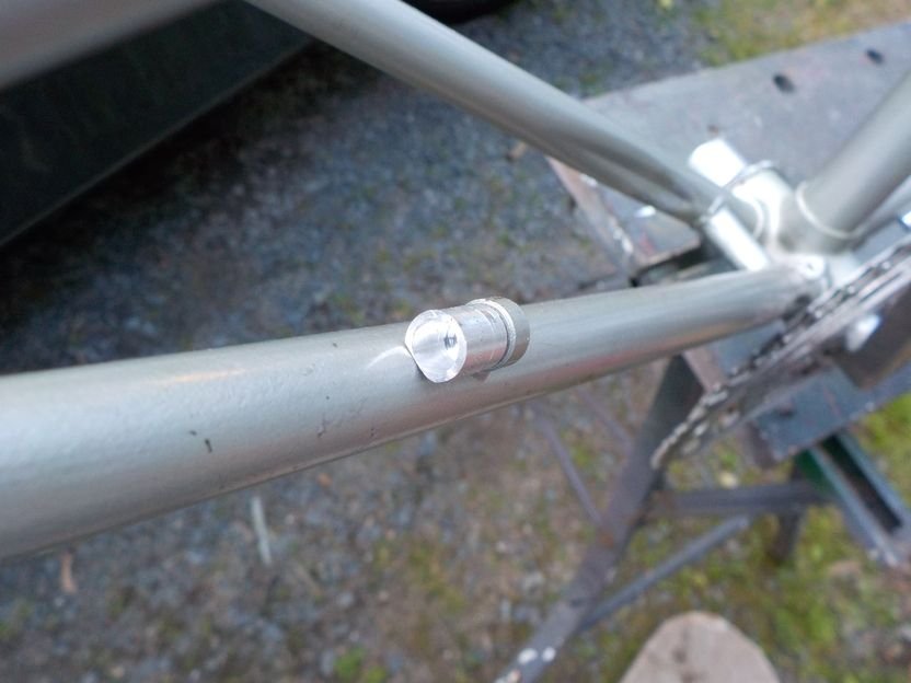

The grips are from a Kettler Alu-Rad, they have little red reflectors in the ends.
They were moulded for a larger diameter handlebar; I built up the existing one with layers of aluminium foil tape.

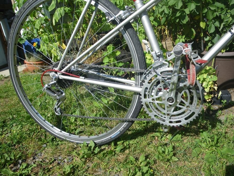

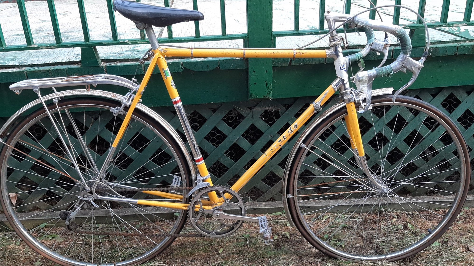

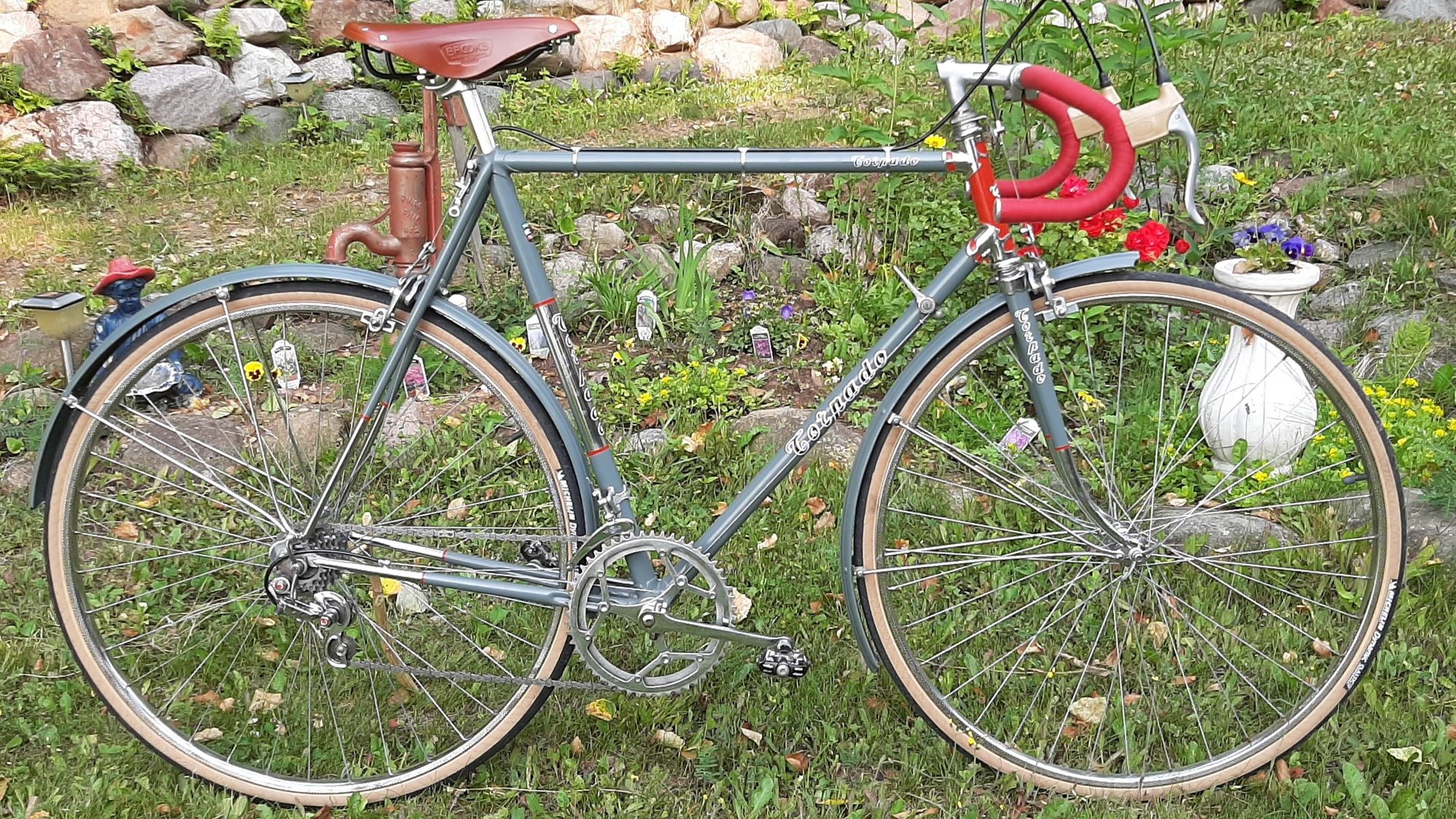

Complete and ready for test riding
First off, here's how that front brake hanger fits. If you look carefully you can see the circle of silver around the ends of the spoke (they go through holes in the nut's wings), and places where the zinc has boiled off the surface of the brass leaving copper behind, I'm curious how this will tarnish with time.
It's part of a rather busy front end:
Drivetrain - those are MKS AR8 pedals with AFA clips, Sachs-Huret mechs, Huret ratchet thumbshifters:
Wheels are Weinman concave on Atom hubs, brakes CLB RACER with Altenbeger levers:
