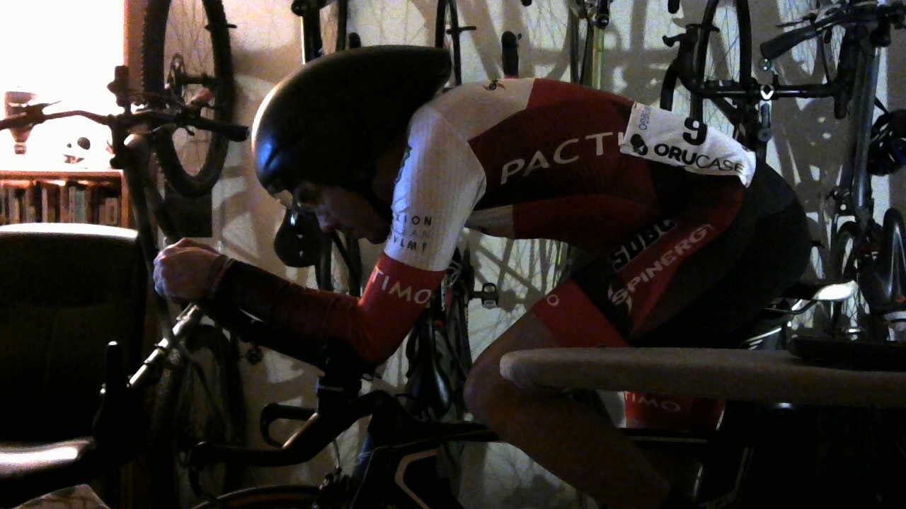

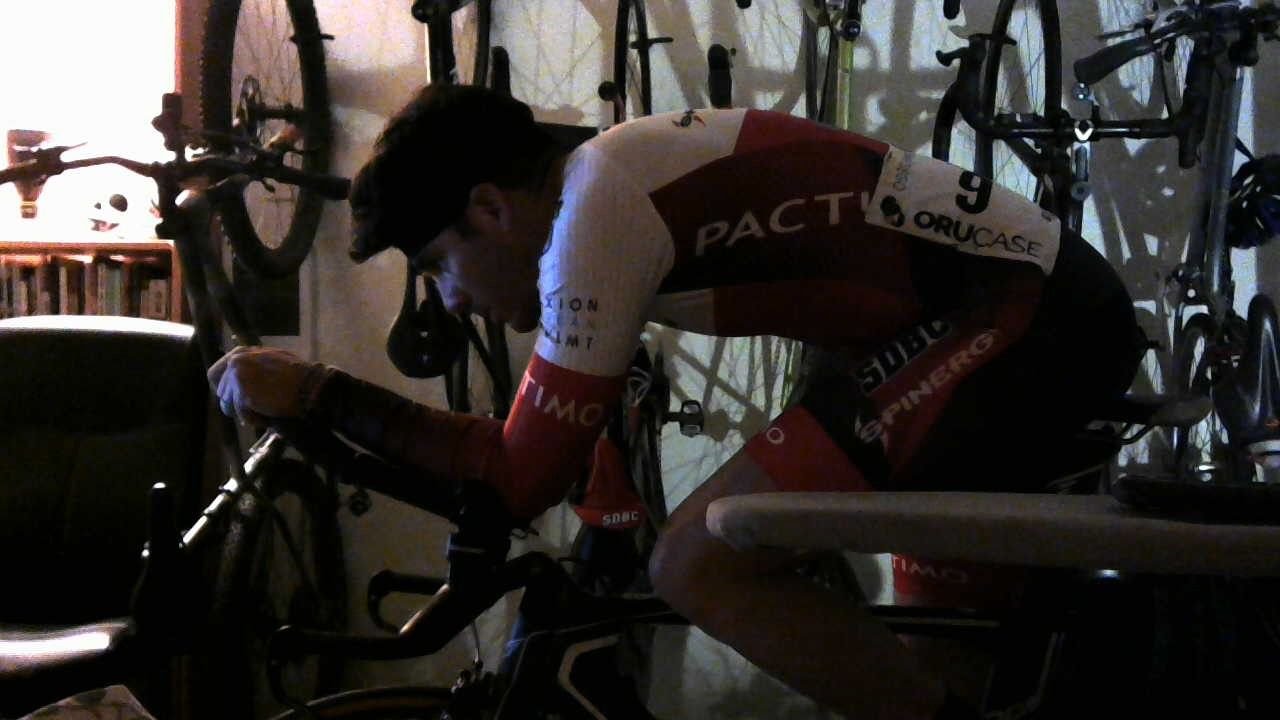

Cross post here from the TT positions Facebook group... Sorry for some of the redundant info, you guys know me better and don't need as much background:
OK guys, let me have it...
Background: Cat 2 (SCNCA) road rider, invited by other elite team members to race (and win) TTT events, district champs, local series etc. I've never done any real optimization and want to start improving my ITT
Physical: 5'9", 65 kg, FTP hovers around 300w + or - depending on fitness level. Pursuiter profile, good at over/under efforts. Can probably pull out a good 20k, 40k (ITT) would be a real challenge.
Bike: Felt DA2 with etap 1x11s, bayonet stem slammed down with modular (Alibaba) bars and Aerocoach 15 degree adapter. Bars can go down another 1/2" if needed, and can go up quite a bit. Cheap old Zipp disc filed/modded for 11s and Hed Jet 60 front.
Helmet: Sworks or Giro Selector. I hate the Giro and have trouble keeping even the shorter tail on the Sworks down towards my back. I move my head around a lot so maybe a smaller helmet would be better.
Position: My heel/toe is flat at the bottom so I think the saddle height is correct. In the side photos, my foot as at the top of the stroke so you can visualize hip angle.
TIA!
TIA!

Well, there is a lot to like in the photo. Personally, I could not see very far ahead with the head position unless you have X-ray vision through your forehead.
In all the TT courses, I have raced on forward visibility is a must. Pursuit at the track during a race with referees watching the track is different to an extent. I think you need a different helmet and the ability to lower your neck while rotating your head up. Frontal area remains unchanged but forward visibility increases. Not so easy to do.
The jersey / skin suit, assuming that is your race set up, has to be a lot tighter. I see too many wrinkles. It takes me a couple of minutes to put mine on with talcum on my arms and shoulder and upper back. I have to be very careful not to rip the seams.
But hey, you look amazing, you have a great position, you have state / records results, FTP w/kg to die for, you ride with Thurlow and Horner on Zwift. Who am I to even comment.

You'd have to test the even lower stack. It's one of those things "lower is faster till it's not". As in you wind up gaining 1w but lose 10w on power production from the hip angle.
Looks good to me. If it were me and you hate that helmet I'd try a Poc Cerebel. It's a bob tail that's roundish, easy to find, tests pretty well on most folks.
My hangup with that Facebook group is that I've been finding some advice I got earlier starting out TT was good for starting out. And that group is good for that. I used Slowtwitch to get help. The tweaks that started to get me somewhere were using Golden Cheetah and virtual aero.
How narrow are your pads? I think you're just a small dude given where your arms align with the rest of you from that view.
As I got faster from the 23-25mph area to 26.5 to 28.5mph range the suit choice changed and I feel I got some there. I haven't tested that with the Notio yet, but my Aerocoach/Nopinz suit just always seems to freaking fly when I use it.

Your comments hold a lot of clout Hermes! Depth of experience.
This is not the race suit, I have a NoPinz that I use, which could also be smaller, but is an improvement from this one. Maybe I'll post photos with that later.
For now I just want position and biomechanics advice. I'm happy to hear you don't think that I'm so far off the mark. RE: visibility, I put my eyesight right over my hands and try to look past my brow. This involves moving my head up every so often to see more than a few meters ahead, like Pogacar, minus the experience and world tour legs.
I agree the helmet could use improvement. The head is such a big deal... Not sure how to lower my head and look further up without practice and some neck PT exercises... Which I can do. LMK if there are any more pro tips.

burnthesheep the pads are about 11 cm center to center. Is that reasonable? They are already in one of two pre-set positions, the narrower one. Thanks for advice RE: the POC. I think an ex teammate has one of those I can likely borrow and test.
Lastly, and this may be a bit of a rhetorical question, but how do you test power output in different positions? Is it like a HR/power decoupling thing, where if I lowered my position, I might see less power at the same HR? The thought of doing regular max efforts in TT position to determine this doesn't sound very fun. Or is it just by feel? Like if I can feel similarly at a hardish effort lower, and it tests better, it works???

Once I think I have "something" new, if it really moves the pad width or stack or reach a good bit......like in a picture it looks really different, I'll monitor my sweetspot workouts in Trainingpeaks looking at the heart rate drift figure. I know day to day, training, blah blah blah..things change...but just to make sure that I didn't suddenly do something silly where I'm losing a lot of power and it would stick out like a sore thumb in a long steady sweetspot effort. Just making sure something really ugly doesn't pop up showing I lost power output.
The pad width is probably fine there, it's just you're so skinny you don't have body poking out the sides past your arms in the front view. I'm 71kg and with pretty narrow pads I can see "body" to the outside of my arms. So, you're probably good.
Once my "super extensions" come in the mail, I'll go fit test some more ideas. I'm "fixed" on my 10cm "rule" and 15deg pad angle stuff due to using fixed shims/tilts. Rule in quotes as I'm too slow to need that stuff for USAC in the US, I ain't going to win nationals ever. The super extensions can adjust the angle anything you want zero to 25 degrees. I have this "theory" that what's good for one person isn't necessarily good for another. So, I basically want to do test laps with like 5deg, 7.5deg, 10deg, and so on then see the data. Kind of like tire pressure having that drastic cutoff once you hit optimal and you go "too far".
Other idea being that in high yaw days the higher hands can sometimes be slower. So wanted to check that on a really windy day on my loop also. So, then if it looks like a high yaw TT........one angle........lower yaw TT day......other angle.
You may be fast enough with that power and body size for that to be irrelevant. Since I'm a "slower than 30mph" dude, I may find gains in that angle stuff.

There are a lot of regurgitated comments such as hip angle and power output. Hip angle is set initially in the studio based upon flexibility tests. ERO set my hip angle at the same position as most Euro pros. Making sustained power at an optimized aero position, IMO, is about time in the saddle and strength and adaptation. My wife who has a national 20k TT record and 3 world track records makes the same power in her ERO position as she does climbing on her road bike. She rides her TT bike a lot.
Head and neck position is influenced by the width of the pads. In general, the closer one puts their elbows together and rounds the shoulders, the more difficult it becomes to keep the head down and still have forward visibility. I attended a aero pursuit seminar at VSC where we worked on head position and many times the pads had to be widened to get the head down.
This is very individual. We were in Aguascalientes in August when Lambrey set the sub 4 minute pursuit record. My wife set but yet another WR. Lambrey’s morphology is perfect for the pursuit position. He is a genetic freak and just hits every metric perfectly.
I have long arms and legs and wide shoulders. Great for tennis not so much for pursuit.
Back to hip angle…I tested various hip angles and found that I had about a cm of not much change in CdA around the ideal set point. So I set my bars at the higher set point. Even if I go up a 1/2 cm, there is not much change in CdA and I can see much better and I can relax my neck more.
My point to all this is there are a lot of variables to optimize and some, like hip angle that get a lot of discussion, in practice, are not that big a deal. The more relaxed I am, the more power I can make. If I carry any tension, my power suffers. YMMV.

The geometry of reach can affect where the head goes also. If you don't run much reach, the geometry of your arms raises your torso. And in consequence raises your head since it's connected to your neck which connects to your torso. More reach means that angle cuts that torso height. So, not only pad width. But he's right, too narrow and the head tends to pop up.
Just that lots of folks run lots of stack then worry about not being able to get the head down where if they lowered the stack some they don't need to stick their neck down like an ostrich.
I think with enough reach and the days of shorter cranks the hip angle thing isn't as big a deal.

Update, #3 Carbon Wasps.......now trimmed the tips for 1-button use. Much more ergo. I put some $8 finger holds on it I found on Amazon. I don't feel I need them. I'll ride that way a bit and see how I get on. They are zip tied on.
Fit photo is just to give an idea of what they look like with a person and the ends trimmed. I've some Notio work to do with the fit, so ignore it. I put the stack as low as possible with my new hardware and the pad spacing narrow as I can. Just to see the limits of the fit coords. I have a mountain of spacers to go up. Also, that's within the UCI box, excepting not putting pad shims in. I wanted to see what I could get away with inside that box also.
Sorry for small photos, they are from video as it takes me longer to get situated than a camera's delay timer.
Trimmed:
With rider:
Trimmed:
With rider:
Likes For burnthesheep:
