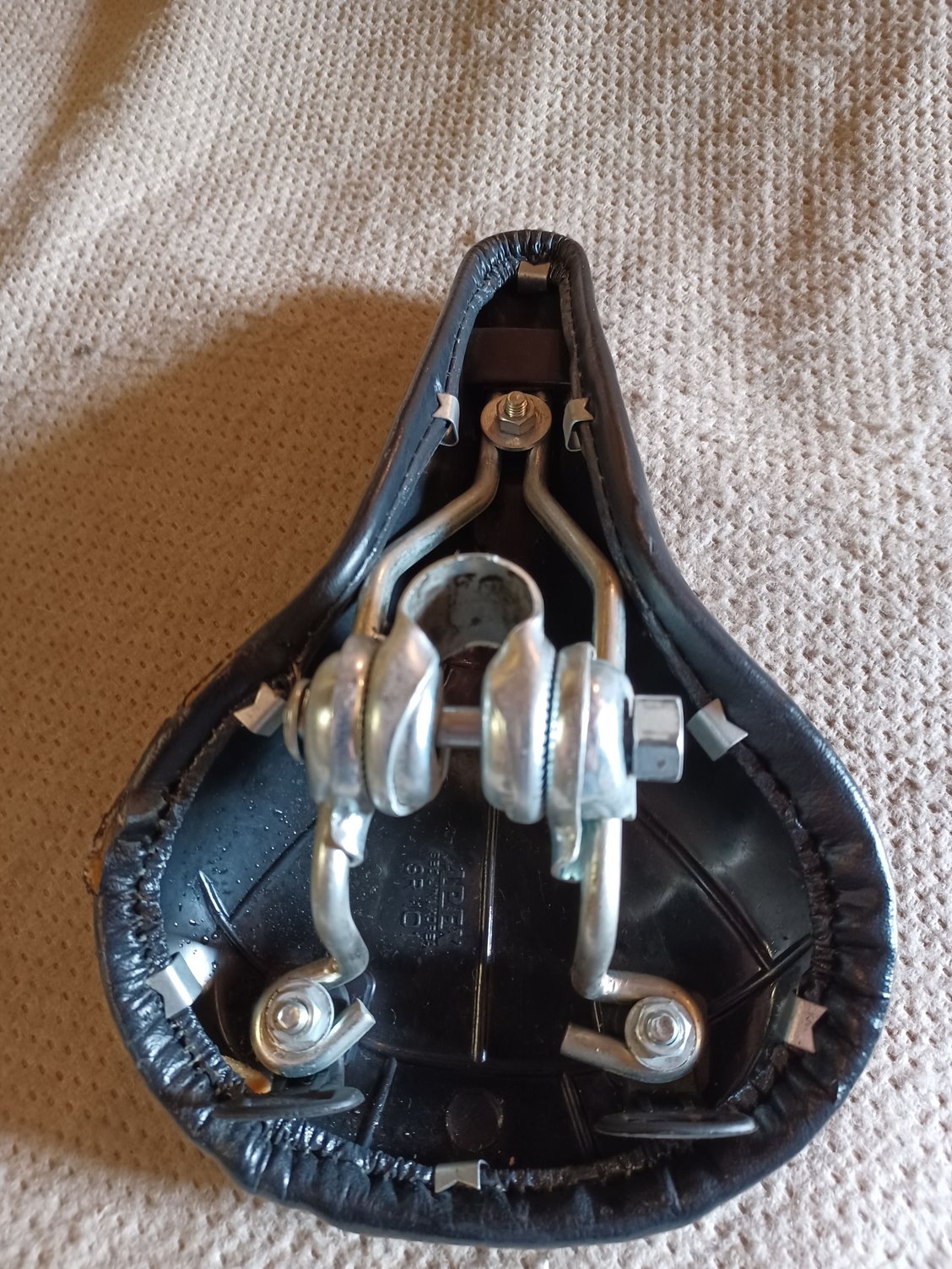

I have a silly question. When looking at pictures of the underside of New Brooks seats I don't see the bracket that bolts to the seat post. Do new seats come with that bracket or am I suppose to use the one from my old seat ?
This is a picture of the seat that is on my bike. Do I need to reuse the bracket with a new Brooks B17 ? Will there be any fitmit problems ? Sorry for the questions, this is my first time doing a seat swap. Thanks !
1964Supersport is offline

The Brooks will not come with a bracket to attach to the bike.
Inusuit is offline

Originally Posted by 1964Supersport;[url=tel:22584698
22584698]I have a silly question. When looking at pictures of the underside of New Brooks seats I don't see the bracket that bolts to the seat post. Do new seats come with that bracket or am I suppose to use the one from my old seat ?
The attachment clamp is part of the seatpost, not the saddle. I would recommend getting a seatpost with an affixed head, rather than the detachable kind in your photo. You’ll get more fore-aft adjustability, for one, and a generally more secure interface.
Rolla is offline
Originally Posted by Rolla View Post
The attachment clamp is part of the seatpost, not the saddle. I would recommend getting a seatpost with an affixed head, rather than the detachable kind in your photo. Youíll get more fore-aft adjustability, for one, and a generally more secure interface.
...I agree with this. Those older style clamps and posts that fit them are a product of a much more primitive manufacturing structure, and are tedious to adjust...often limited in adjustability.
You can get a pretty decent alloy seat post with an integral clamping mechanism on Amazon now in the $20 range. You do have to size it correctly, with respect to diameter, and you will probably need to shorten it with a hacksaw and a file.
Or you can look for something used. Sugino made some good, solid ones, if you can find one in the right diameter. As did SR, with their Laprade seat post.
For the new ones, on Amazon, there are a plethora of things that will work, all marketed under different names. Try to spend at least 20 bucks, to avoid the worst of them, but make sure you get the right diameter. You can use your old post and clamp if you really need to, but generally speaking they are troublesome to use and adjust.

I think the clamp you have will give you a wider fore-aft adjustment range, than an integrated seatpost/clamp since your clamp can be reversed. Lots of people love the Brooks saddles, but it doesn't fit everyone.
philbob57 is offline
