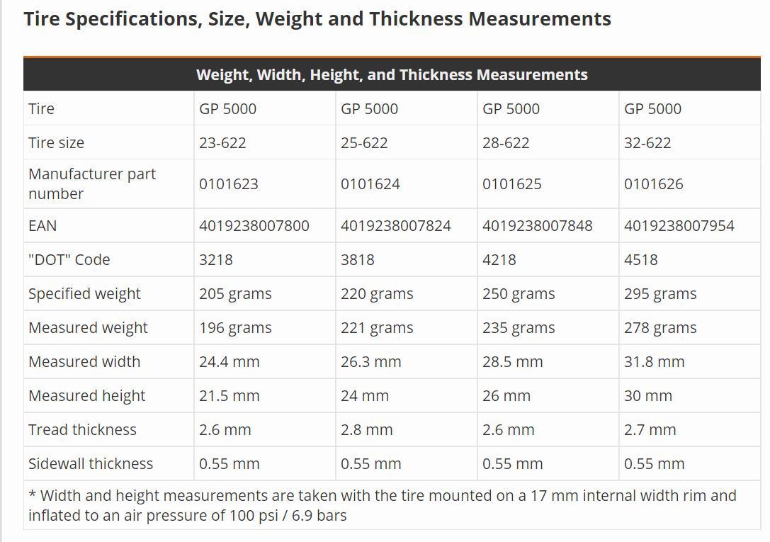

Keep in mind that the GP4k is going to be a little oversized compared to the GP5k. In general, newer tires are a little smaller than previous generation tires because they're compensating for the additional width of modern rims. IOW, on the same rims, a 25mm GP4k is probably closer to the size of a 28mm GP5k, so a 30mm GP5k probably isn't going to be that much bigger than your current tires, maybe 1-1.5mm additional on each side (width and height/radius). I would probably get a 6mm allen wrench and use it as a feeler gauge around the tight spots of your current tires. 4mm worth of clearance, to all sides, is what's generally recommended, so if that 6mm spacer doesn't jam anywhere, you're probably good to go.
Oh, and FWIW, some tire manufacturers have started being a little more explicit with their sizing to alleviate guessing games like these. Some will tell you that they'll measure to size on a specific width rim ("28mm wide on a 19mm internal width rim" or something like that) while others have gone all out with WAM (Width as Mounted) and RAM (Radius as Mounted) charts for combinations of various tire sizes and rim widths. I don't think that Conti has jumped on to the WAM/RAM bandwagon, but I they might specify their reference rim width.

If you have the stock wheels, looks like they are 17mm inside width. I estimate a Conti GP5000 28mm will be about 29 to 30 mm wide mounted. It will be taller too. A 30mm may be too close to the seat tube cut out. Fulcrum Racing 400 DB, Alloy clincher, 35mm deep

This...for all the reasons noted above about sizing differences once mounted. I do run 30s on my SL7, but I ran 27s first, with enough space left that when it was time to replace, I bumped them up. As for comfort, it's a noticeable improvement, not squishy or bouncy, but definitely less harsh. As for perceived effort and actual measured speed, no change. I suspect that is a common experience with any higher end tire.

Off the top of my head? No. It's a cumulation of wheel and tire shipping over the last few years. If you read reviews of the new tire releases, like the Schwalbe Pro One Addix TLE, you'll see references to their new sizing on 19mm int width rims. For WAM and RAM, I believe that it was 3T that pushed that forward, with tire manufacturers like Pirelli following their lead.

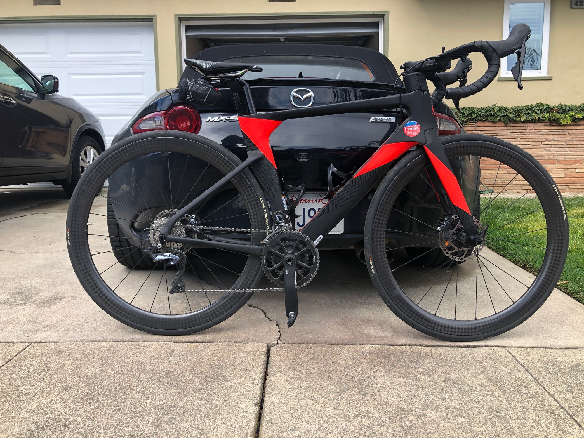

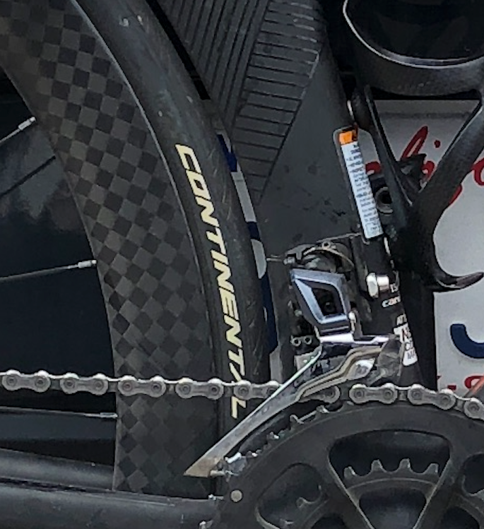

I have 2019 systemsix. I did not like the 23mm tires that came with the bike. Kept getting flats. I installed 28mm gp5000. They fit fine. It's a little tight by the seat post.
If the 30mm tired you are getting are any taller than 28mm gp5000 I don't think they are going to fit. Width wise you should be fine.
maybe 30 front / 28 in the back ?

If I had a 28mm on the bike I would take close up photos for you. I am using gp5000 25mm just because there where always on sale and available.
