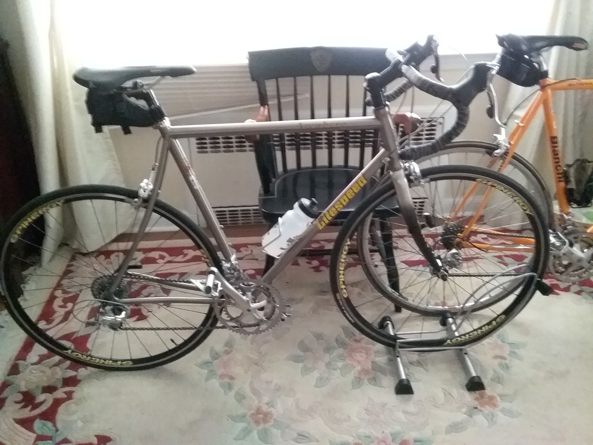

Couldn't help but do a bit of partial mocking up today 😎
Now I can't decide whether to use the correct but scratched vitus fork I was able to scrounge, or use the grey anodized fork (Kinesis?) that's on the donor cdale... I feel like the darker fork might help mediate between the polished ti and the black bits?

Using the C'dale fork as a mediator between the polished Ti at black parts sounds promising to these ears.

Update
The Mavic stuff is lovely but I decided to leave that for a different build and take the Litespeed in a different direction. Call me vain, but I love a mockup. Now I need the right wheels to go with the Sugino75 road groupset...
