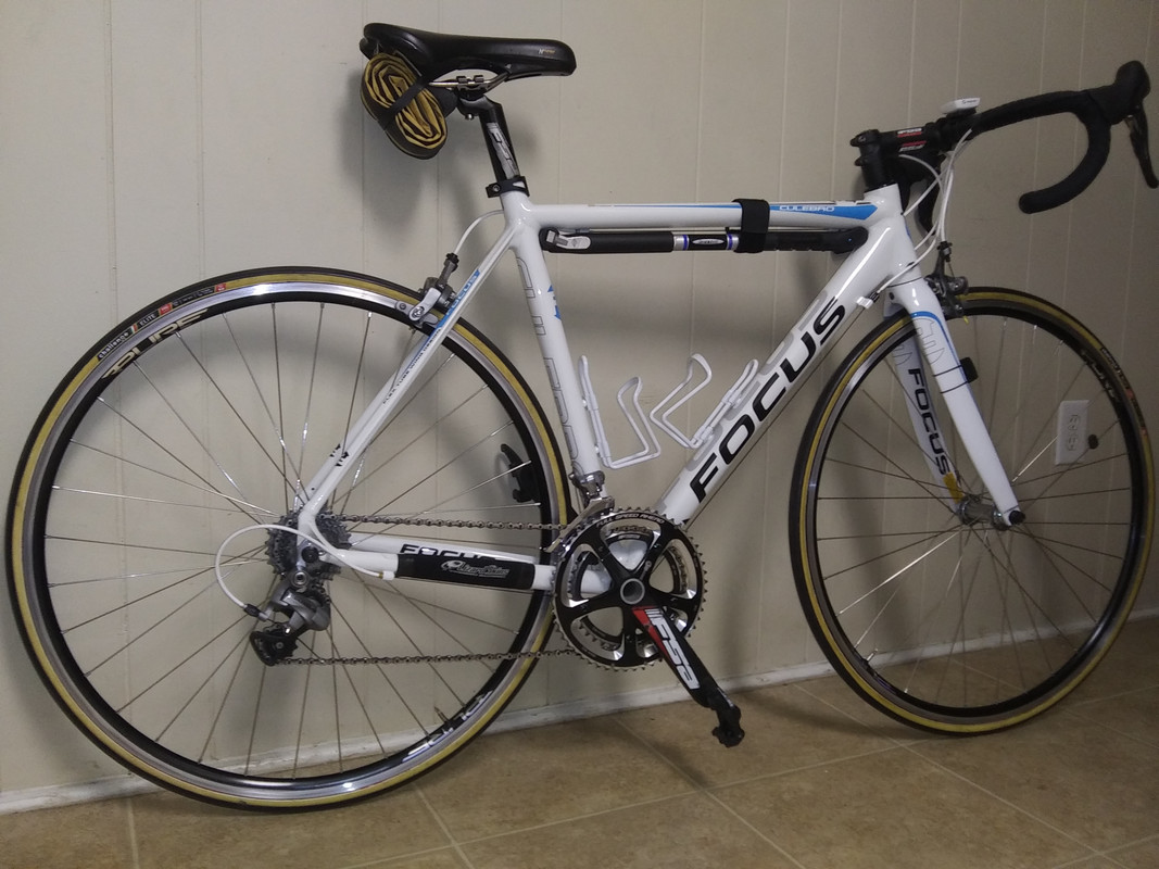

FWIW, BWW still has at least one set of their Ultegra 6700 tubulars on clearance if someone is looking to build up a bike with modern stuff. I've had a set for two years and they're flawless, I haven't had to turn a spoke nipple. The rims are the best tubular rims I've ever had and the decals peel off if you don't like them. They say the hubs are "dark silver" but they're the regular silver hubs. DT Swiss Comp butted spokes. With the discount code 10Now they're only $170.51. The hubs are probably worth close to that. I'm tempted to buy a spare set.
https://bicyclewheelwarehouse.com/Cl...ar-wheels.html

Originally Posted by Lazyass View Post
Nice spare fold!
