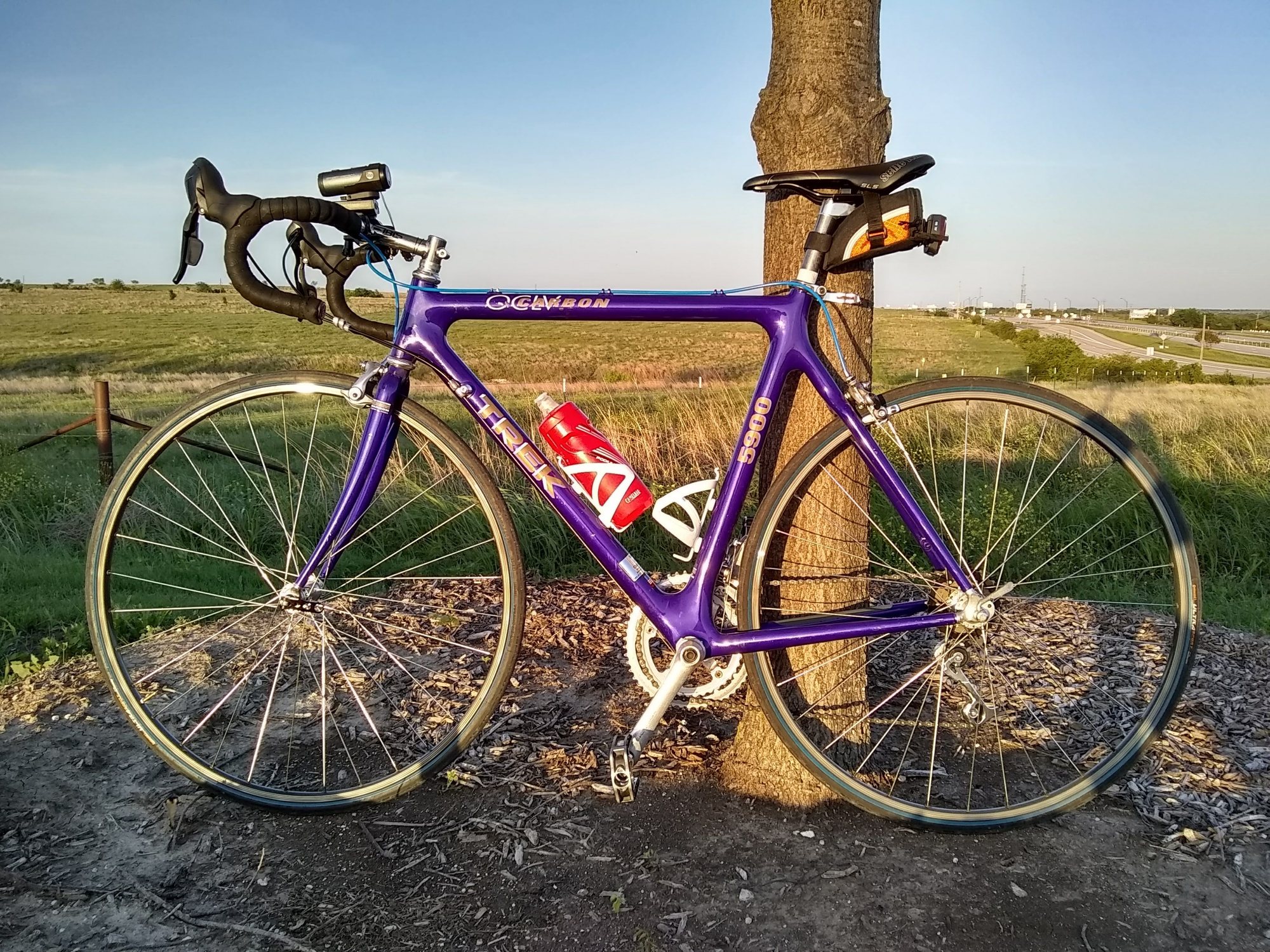

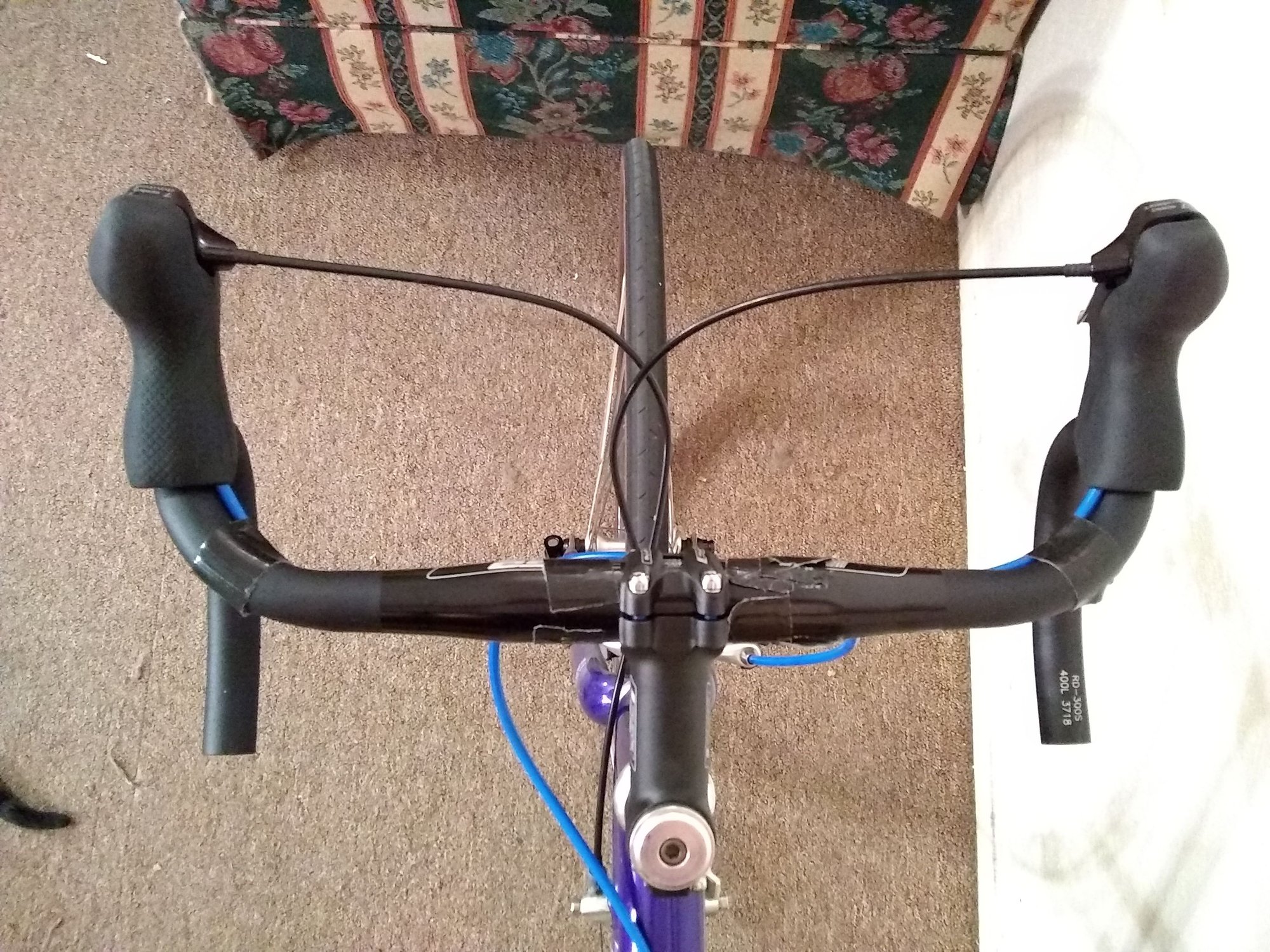

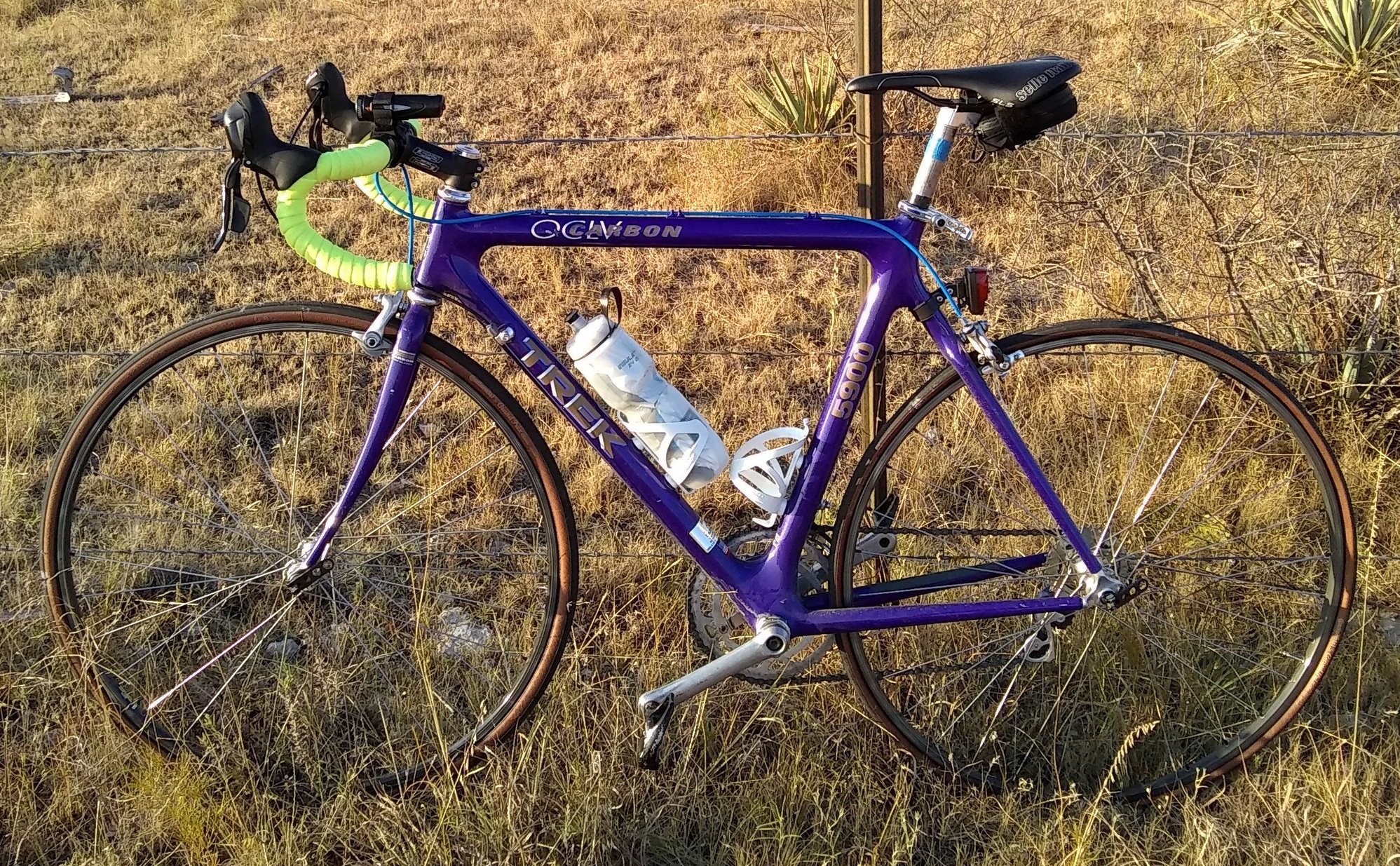

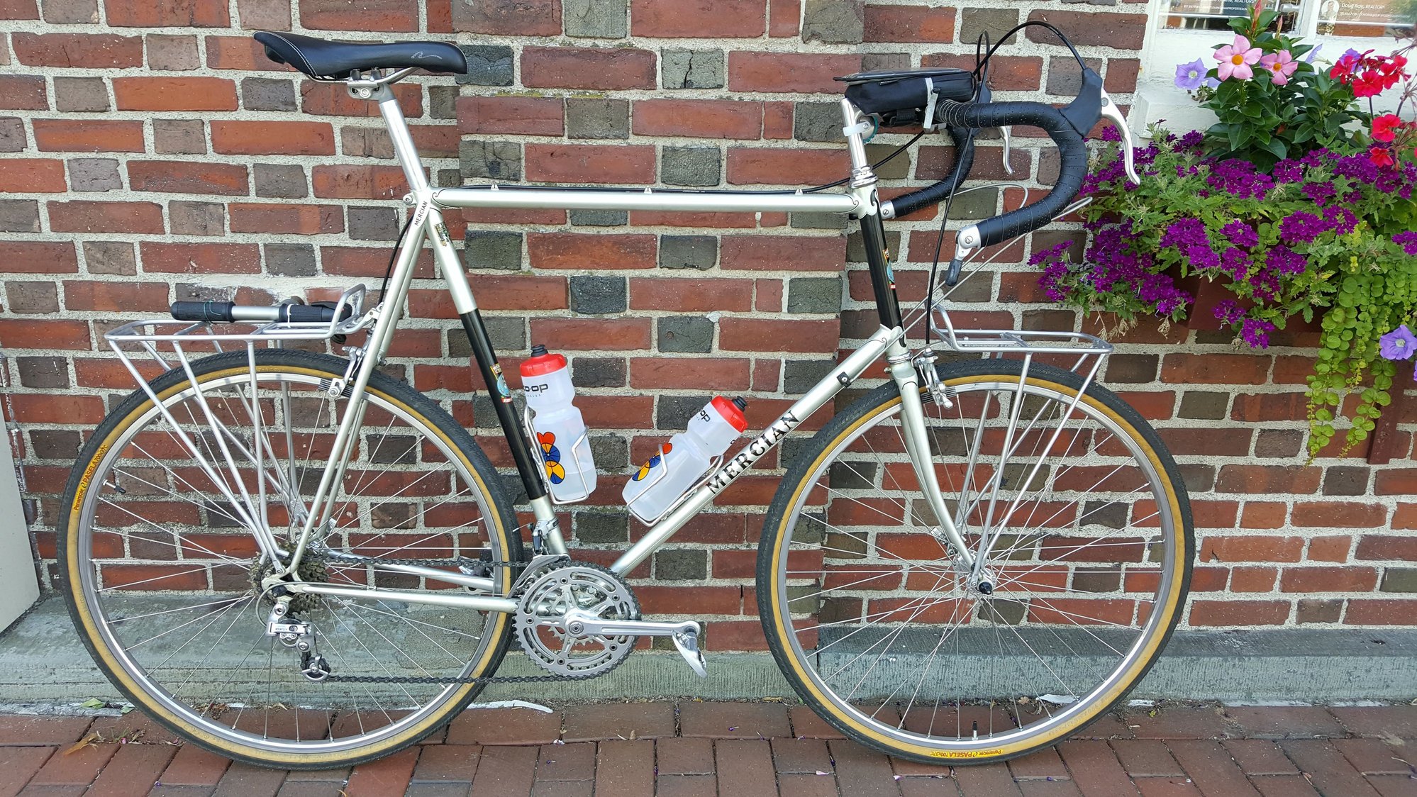

I recently got a new road bike which I chose based on it achieving a similar fit to my current (most comfortable) bike - the dimensions locate the wheels, bars, BB, saddle, etc. in the practically same place despite one being a 40yo steel frame and the other an aluminum bike with modern compact geometry. Riding the new bike, surprisingly, is a different story and I'm hoping for a few suggestions.
My old bike has Nitto Noodle bars, non-aero Campy brake-levers and bar-end shifters. The new one has generic bars of the same width (as the old) with Tiagra 4600 STI shifters. The flat part of the bar as located by the stem is in practically the same location relative to the rest of the bike's touch points, but on the new bike, riding on the hoods feels too far and the bend in the bar (from the flat towards the hood) is a tight and uncomfortable radius to rest my hands on.
So, can anyone recommend a black 31.8mm modern handlebar with some similar qualities to the Noodle (or at least a more generous curve/radius)? And, are all modern STI hoods this long or could I be looking at another product bringing the lever closer to the bars (more similar to older hoods where you share some space on the bars and some on the hoods)? OR, do I (also) get a shorter stem and accept that I'm supposed to be riding on the hoods (or in the drops) all the time?
I'm curious about the sharp bend on the handlebar ramps above the hoods, though. The sharp bends near the top of modern bars are there so that the ramps flow smoothly onto the hoods, but if the hoods are positioned too low on the bars, this exposes the sharp bend to your hands when riding on the ramps. Could you post a side photograph of the new bike?
What about the spots where you actually put your hands most of the time? Equalizing fit by handlebar clamp location is not necessarily a good approach, since different bars have different shapes and different amounts of reach. You may need a shorter stem.
No comments on the size. I am fully aware of how big I am
New and old below:
New and old below:

Your modern bike has too much reach with compact bars, and you want to change the bars out for something like the Noodle which has even more reach?
Either I dont understand the issue or you arent going the correct direction in terms of fit.
Likes For mstateglfr:
I guess you could look for bars with a wider curve there, or even just get a Nitto Noodle and use a 26.0-to-31.8 shim to make it fit the new bike's stem.
But I think what I'd really recommend is to reduce the reach of your fit (and/or increase bar height), so that it's comfortable to ride in the hoods or the drops. Most people find that the grip shape and wrist orientation in those positions is better for spending big miles in, and if they're comfortable, then you're able to get much better utilization of your bars. If the fit is so aggressive that you're only able to use the tops and upper curves comfortably, then you're not making much use of most of the handlebar.
1. The radius where I prefer to rest my hands when not on the hoods is too tight. Is there a modern bar with a more generous curve a la the noodle?
2. Shifting/being on the hoods feels too far away. Are all integrated shifters' hoods this long and would you replace them or the stem knowing the flats are in the right spot)?

A couple of notes.
The new STI brake levers tend to do much better with a tight curve for the first curve. They may not even be recommended for bars like your Nitto Noodle.
The tight top curve allows the levers to come out right at the top of the bars much easier, rather than sitting somewhere in the middle.
The problem is a lack of choices of bars.
"Compact" (yours).
"Ergo" (less common today. Larger area, but tends to have sharp corners in all the wrong places.
I like to choose "aero" (flat-top) bars, but then am stuck with whatever geometry they come with.
"Compact" (yours).

Your riding position looks fine, but it may take some time and a little physical therapy at home to get comfortable. Due to old neck, back and shoulder injuries I do a lot of stretching and strengthening exercises to stay in shape for drop bar road bikes.
When I switched my '93 Trek 5900 (early carbon fiber monocoque frame) from the original downtube shifters and aero brake hoods to brifters (well, MicroShift integrated brakes/shifters) it really stretched out the fit and was danged uncomfortable on my neck. I wanted the bike to fit like my '89 Centurion Ironman steel bike, at least as closely as possible.
I prefer the bars a bit lower than saddle height for better weight distribution. If I raise the bar to be initially comfortable on my neck it puts too much weight on my butt, which gets uncomfortable on longer rides. For me at least, setting the bar about an inch to three inches below saddle height feels about right.
I switched from the original 120mm stem to a 90mm (FSA), and from the Nitto classic curve drop bar to FSA Omega compact drops, which are nearly identical to the Soma Highway One but with wider diameter at the top for threadless. I like it so well I may get the Soma for my Ironman to replace the original WinPista.
Those compact drops reduce the reach from the tops to the hoods, and from the tops to the drops. It's a little less aero and aggressive but far more comfortable. Since installing the shorter FSA stem and FSA compact drops this summer I've ridden many rides of 20-50 miles, a few of 60-75 and one solo century at the end of September. No problems.
However as my conditioning and flexibility have improved I can actually see the front wheel hub over the top of the bar when I'm in the drops, so I might switch to a 100mm stem. It should be a reasonable compromise -- I already have the 100mm stem so it won't cost anything but the time it takes to make the switch.
Trek 5900 with classic Nitto drop bars. Those were fine with the original aero brake hoods, but too stretched out with the brifters and original long stem.
Shorter 90mm FSA stem and Omega compact drops. Reduced reach across the top and to the drops.
Shorter reach across the top compensates for the longer reach created by the brifters compared with the original aero brake hoods.
Same bike as it was up until a few weeks ago, with Arundel Synth Gecko bar wrap, double wrapped over generic black "cork" foam tape. I've since removed the Synth Gecko to use on another bike -- it's reusable, no adhesive, doesn't take a set, very comfortable and versatile wrap... if you don't mind neon colors.
