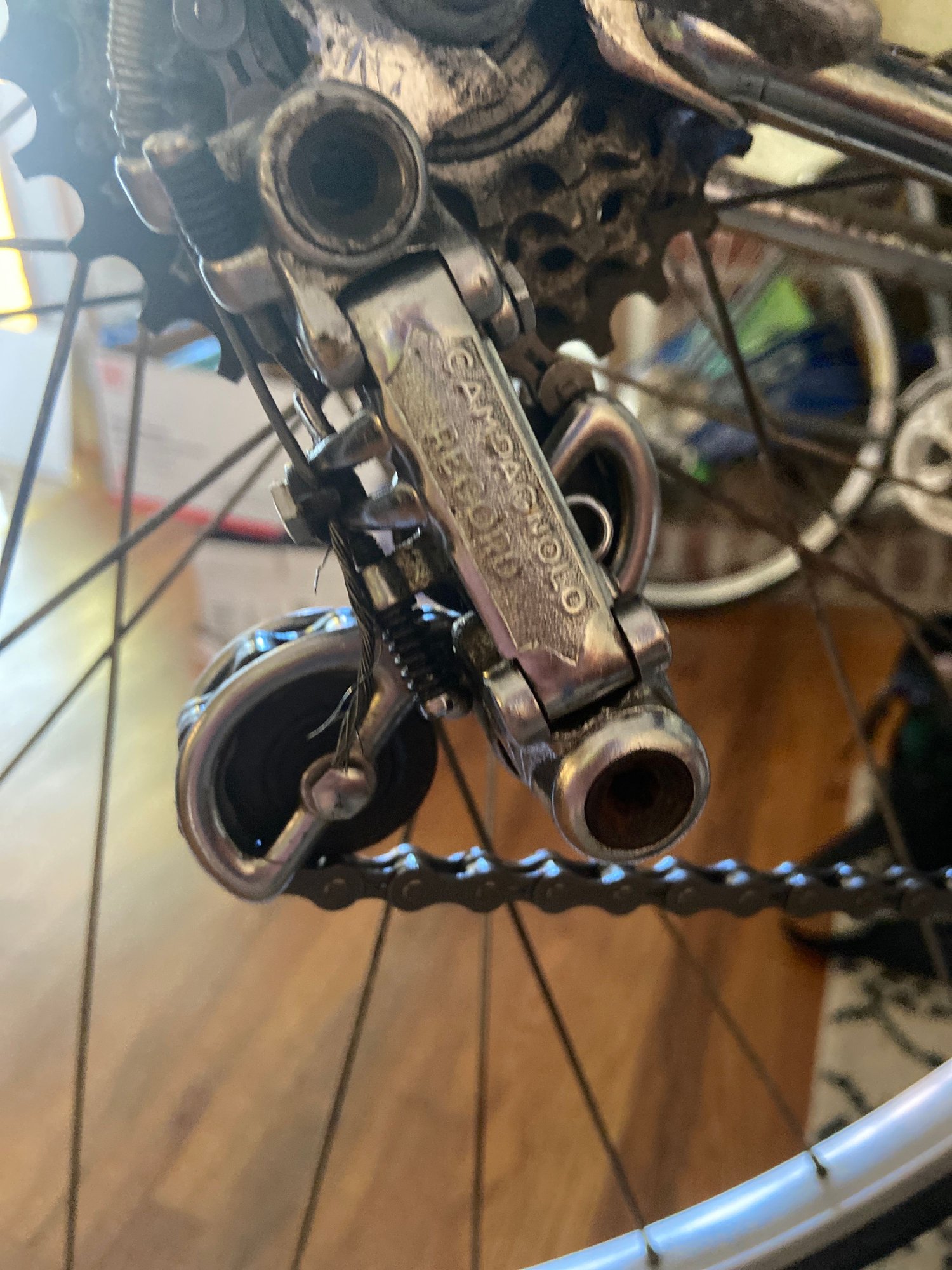

The RD is my current source of frustration. I’ll take it off and see what’s going on. Movement in both axis is a bit gummy so hopefully a cleaning and light oiling will rectify that.

RustyJames How big is your largest cog? Maybe 26T is the max for Record? (Velobase is apparently down at the moment, so I can't check there.)

That said, I'll second the question about largest cog size. Also, that cable housing has run its course. And I'm not sure a modern bushingless chain is best over toothless pulleys. Others may know better.
Another problem - the head of the dropout saver is being brushed by the chain. That’s not good. I’ll see if I can shim the wheel over.
The rear bit of line will be replaced soon. Thank you to the keen-eyed C&Ver who spotted that.

I think that's inaccurate. Old Campy derailleurs were designed to shift low tooth count close-ratio racing cogsets. For that function they were superlative and, as long as the pivots have not worn terribly so that there's massive play, will continue to be so. If the pivots are worn then you can either repair or replace. If you are trying to push the derailleur to do things for which it was not designed, you can either replace it with something designed for the task at hand or you can accept performance that is slightly less pristine than what a modern derailleur can do. Many of us choose the latter.
