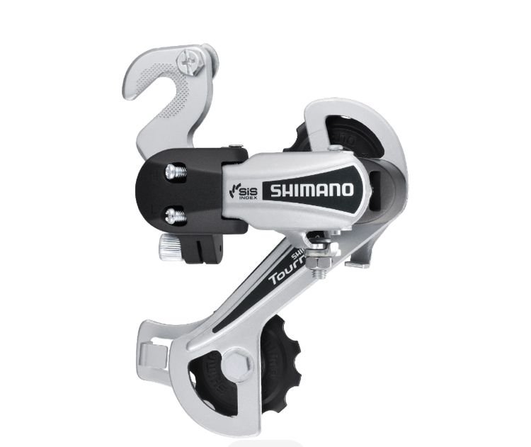

Hi new guy, Apology for posting twice, once in folding bike section. It really belongs in this category. I just bought a Green Zone, folding bike. I like it. Unpacked and went for ride. It would not shift into 7th gear, high at all. It shifted well 2 through 6 well. I adjusted the derailleur. Works well now up and down shifts all 7 hears. However the whole derailleur looks like it is angled and twisted slightly. It seems to be loose or have excess play at the attachment of the derailleur to direct mount/hanger. I think the derailleur and hanger are permanently attached as a unit or assembly.
Gear set is Shimano MF-TZ500-7.
Derailleur RD-TY21-B-GS but not 100%. It says: "Shimano", "Tourney", "SIS Index". Looking at images, this part number is a good match to what is on the bike.
Not sure the hanger is bent, it looks OK. What it looks like is derailleur is loose on the direct mount/hanger. I can wiggle it a good bit.. The cage and pulley is not aligned with gear set. Bike was shipped and packed well. I assume direct hit during shipment, even double boxed, might have caused damage. OR IS THIS LOOSENESS NORMAL?
.What is the right part number.. RD-TY21-B-GS, if that is correct, I am going to buy a spare. This thing is low and hangs out. It is going to get beat sooner or later being a folding bike. PS What is a good upgrade to this Shimano derailleur? Any help or suggestions appreciated.

Tourney uses 2 different types of attachments. I "think" the A is an integrated bracket, or claw type, and the B is a direct attach to the hanger; but I'm not entirely sure of the letter designation.
You just need to make sure which one you have as you go to upgrade.

If your derailleur looks like this, with the claw facing the rear (to match the dropout), that will prevent you from replacing it with most available options. Some folding bikes are spec’d this way. Problem Solvers makes an adapter that MAY solve this problem (again, assuming you have this type of hanger), depending on the dropout:

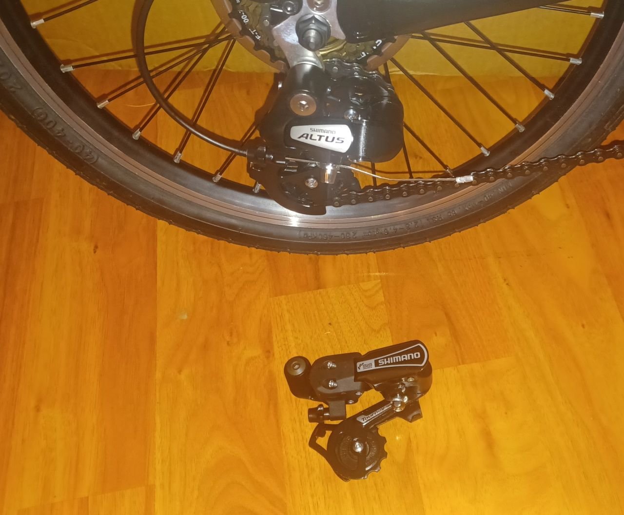

UPGRADE - purchased Shimano Altus RD-M310 7/8 Speed Direct Mount Black Rear Derailleur. The derailleur and the mount are solid one piece cast, no play between the derailleur mount as it's solid not a thin metal plate riveted on. The Tourney RD-TY21 I have stock uses fairly thin metal plate (likely not high heat treat) that is riveted onto the derailleur and attached via single fastener to bikes hanger. All the play is and the source of misalignment is between derailleur and it's integral metal direct mount. Let me be quick to say it is shifting well. This play may be be by design. The thin-ish metal mount has an advantage, it's sacrificial if it gets wacked. The more ridged derailleurs like the Altus will likely bend the actual bike hanger (thick aluminum plate). BTW The Bike distributor refunded some money. See my comments on bike below.
cyccommute said the play may be normal. He is probably is right. I called Shimano and described how loose, wobbly it felt and looked. They thought it sounded excessive but admitted there is some play. They can only guess not seeing it. I went to a very high end bike shop, really nice décor, coffee shop, no kids bikes or entry level bikes, mechanics working in plain view. Nice mechanic stopped what he was doing, looked at it, was not shocked, said they do that. The fact it works well now he suggested just ride it. Also he suggest as you all have said the Altus and Acera, I am going to replace the RD-TY21 Tourney because I don't like they way it looks with cage/pulleys at an angle, almost 1/4" play. May be this is why it shifts well and quiet? The mounts on Altus and Acera are solid, no play of the mount. We shall see when I replace it.
Done and Done. I wasted too much time looking at the Acera (RD-M360) vs Altus.(RD-M310). They are about same price, have same reviews, flip a coin. I bought the Altus RD-M310. This design does NOT have thin metal plate riveted on derailleur. The whole thing, mounting flange and derailleur are sold one piece casting. All movement will be from the parallelogram and pivot of the cage, as it should be? Again I think the RD-TY21 Tourney works well just sloppy looking. Is that mounting play intentional, a "floating mount", a mistake during manufacture, or shipping damage. I would like to get another example and compare. Bottom line if the gears and pulleys are not lined up I assume gear and chain wear increases. It is possible it straightens up under load, when pedaling. Weird.

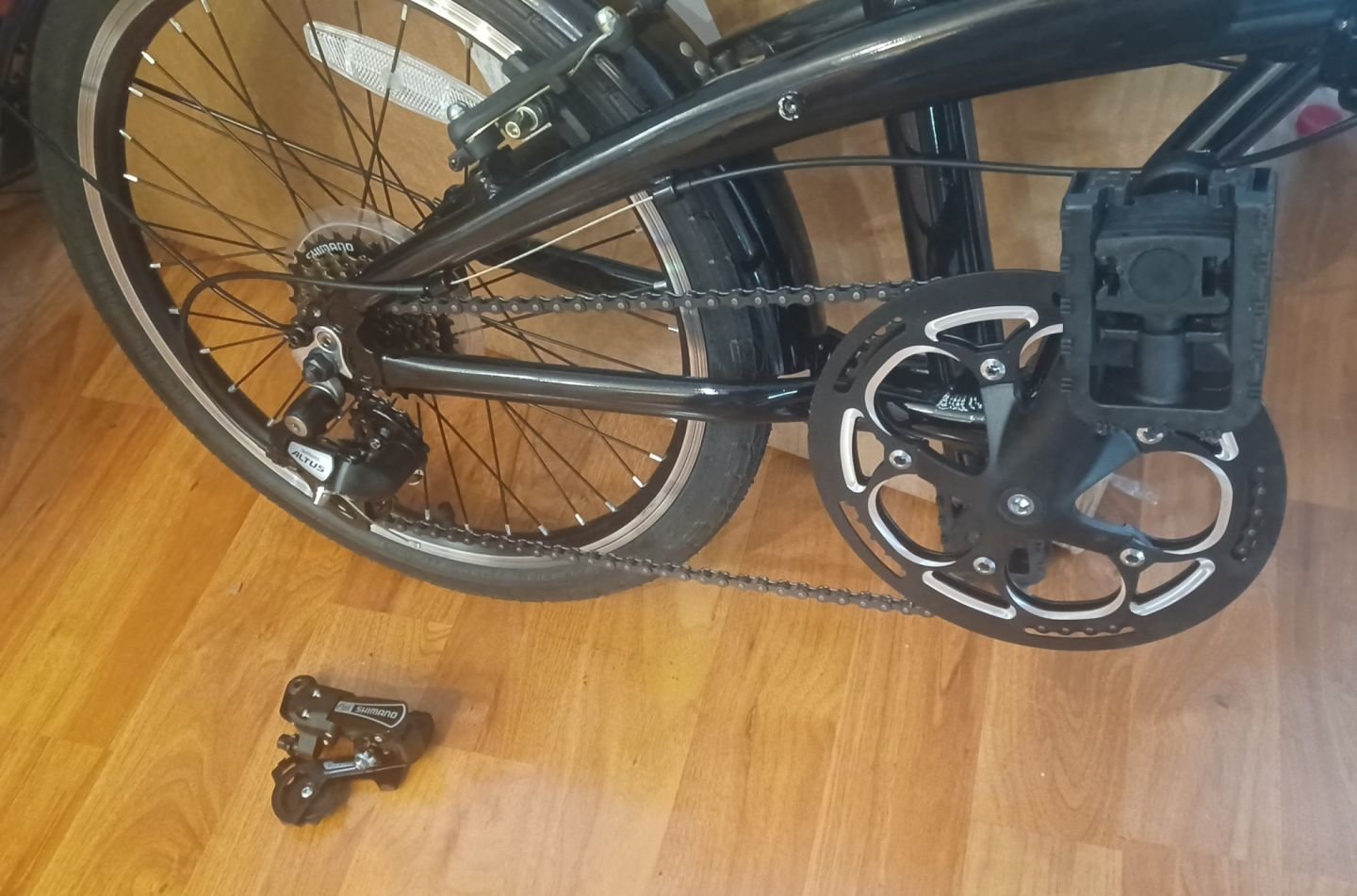

Mission accomplished. Just installed the Shimano Altus. Looks good, but a little bigger and heavier, and it sticks out a bit more. However it solid, the play is nominal, small. Have not adjusted it yet, don't have time but great upgrade. THANK YOU EVERYONE.
