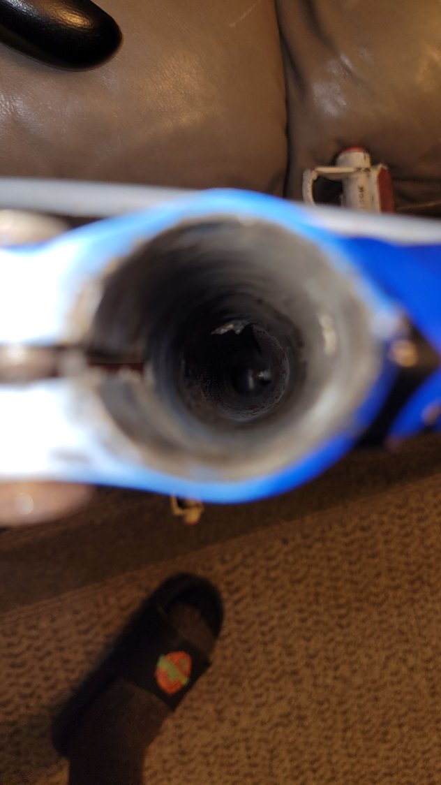

I just got back from the shop. I honestly think things look pretty good on the inside. I have a feeling the bike got an internal coating of Frame Saver when it was assembled. I'm going to pick up some OA crystals and let it soak in the tub for about a day to try and deal with all of this external rust. I'm not too sure how well it'll work, but we shall see.
The Shimano 600 BB I pulled out of the frame looks pretty much flawless. Excited to clean that up.
Also, I don't think it's SLX unfortunately. Looks like regular SL.

Good job on your work so far and plan for the OA bath.
No way I'd do a full repaint, unless it's a keeper.
Now that I've seen those close up pics, I'm going to amend this to say that I would touch-up all or most of the white painted areas with aerosol enamel. It will protect the bare spots, be easy to match, and should be a big improvement in the overall finish.
SurferRosa is offline

I've had the frame soaking for about 17 hours, and I'm not seeing much change so far. Is there anything that I missed in my process?
Before I placed the frame in, I gave it a good scrub with dish soap and water. There's about 30 gallons of water in the tub, which started off warm. I mixed in 200g of oxalic acid crystals to start, but have been gradually increasing the concentration and I'm at about 600g added (I measured that each tablespoon was 17g, so I should have enough for 30 gallons in there at this point).
I bought the crystals off of Amazon, so maybe they aren't the real deal? I'm planning to grab some Evapo-Rust from a hardware store to add to the tub to finish the job, but I would love some recommendations on anything I've done wrong.

Take it out of the tub ASAP
You should stop now take it out of the bath tub ASAP and rinse the tub several times with dish soap. Heavier concentrates of acid will damage your tub and plumping if not already. I guess we weren't clear sorry but when doing a acid soak on stuff it needs to be done in a plastic container that is semi expendable thus the kiddi pool suggestions acid can even if mild wreck the the finish on a tub. I would suggest taking some mild steel wool to the rough rusted places with some WD-40 to see were your at this point.
