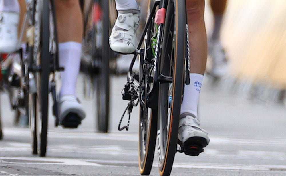

did that happen at one of his two recent stage wins?
I've never heard commentators mention this before with sprint finishes, but that certainly doesn't mean it doesn't happen.
PS looked up and read some stuff about these incidents.
yup, pretty neat and curious combination of quick events doing this.
that's pretty neat.
https://www.businessinsider.com/fast...ing-off-2021-7
